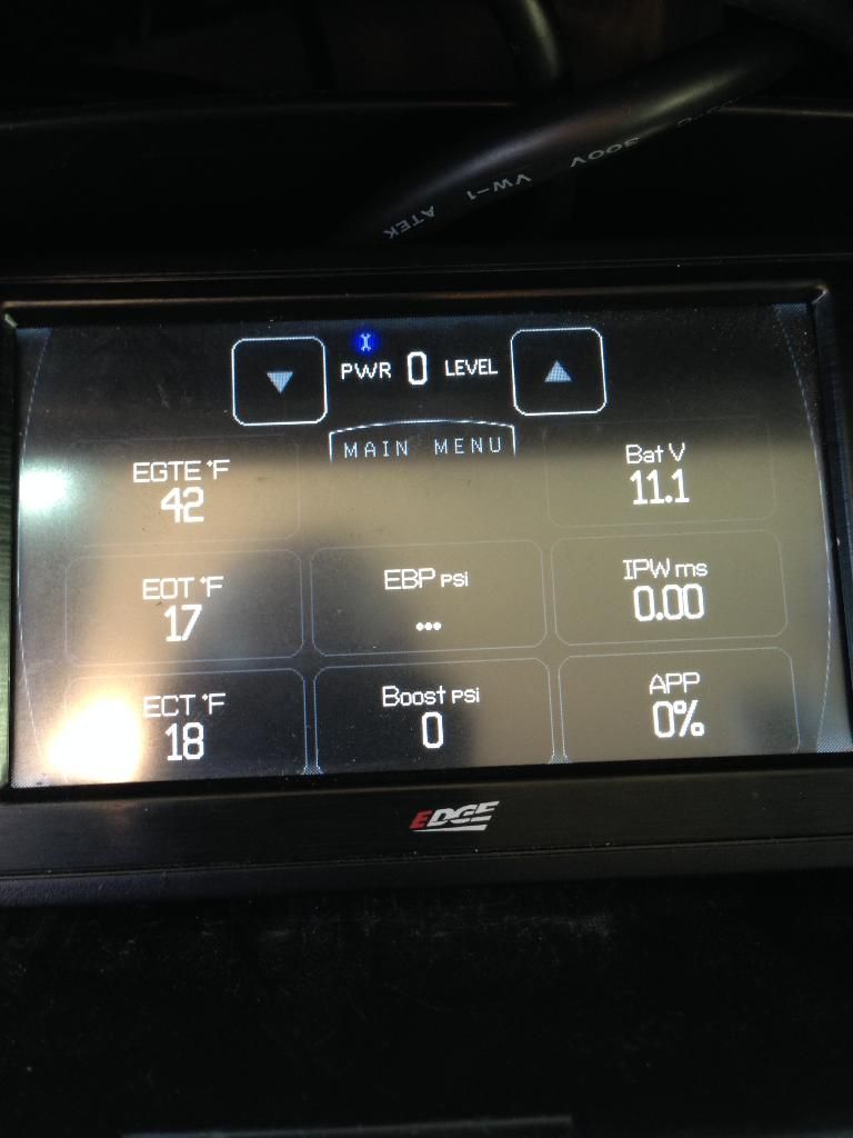

Whats it supposed to read? I know the 03-04 trucks use inferred EBP.
Mine reads 0ebp KOEO 14.5 MAP and 14.5 baro

YOure reading Key on engine off right?
#7 ·
EBP values depend on the PID used. As you are probably aware, the technical reference changed for comparison from absolute to relative for the later years, but depending on the scan tool or monitor, both PIDs are selectable.

I can solve the 3 dot issue.
Pull your sensor, Clean it, replace the EBP tube
