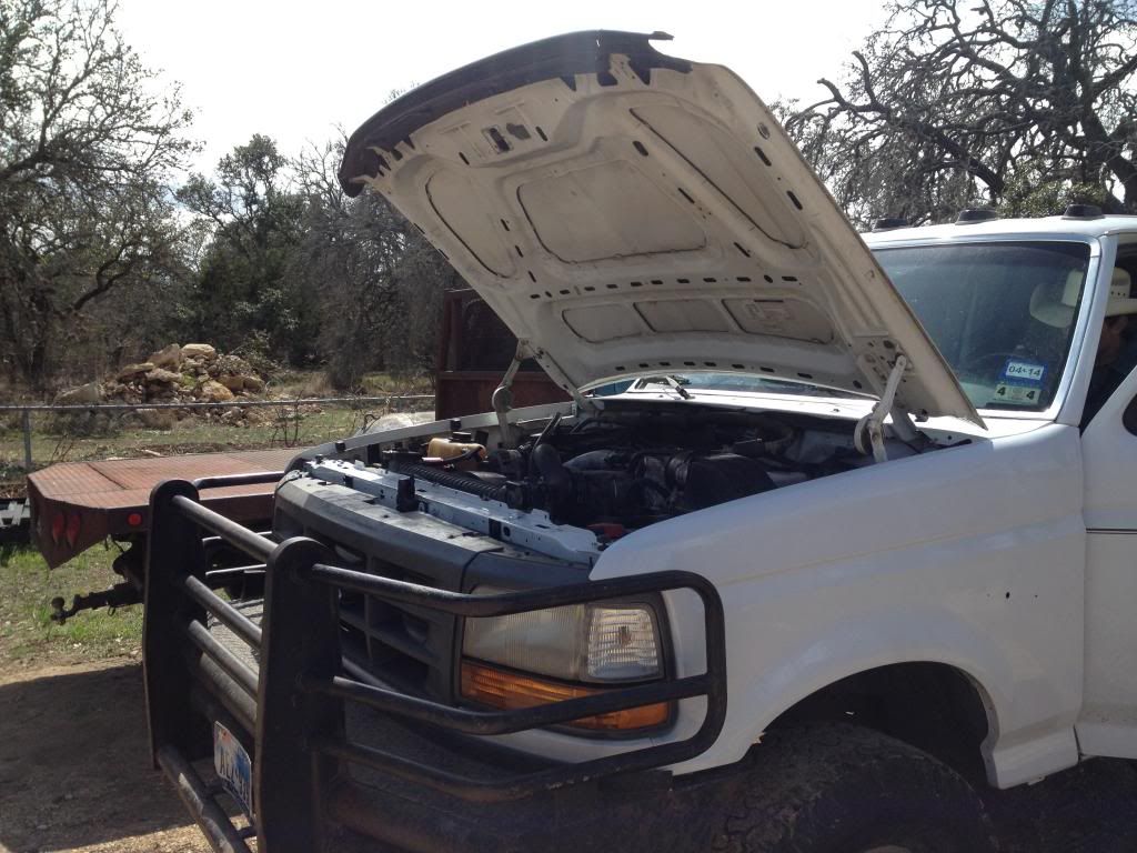

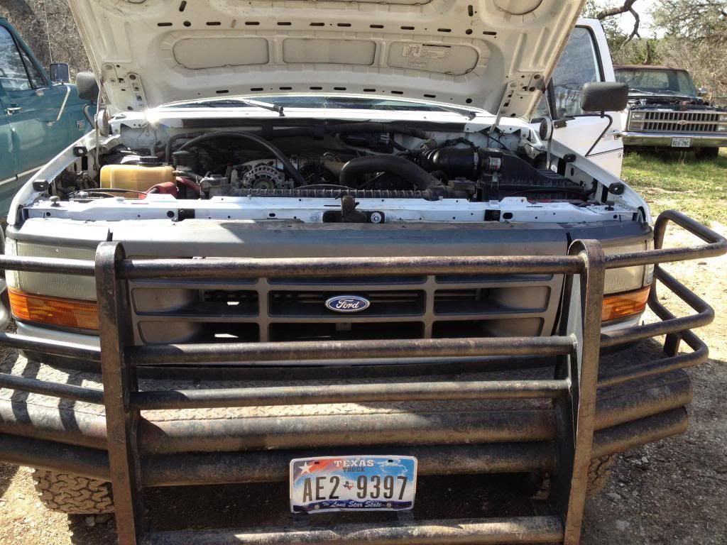

So drawing some inspiration from Colin7.3's build, which is awesome, I decided I would do something similar and document my build in here. Now bare with me because it may be a little slow. I am working as an EMT and going to college so time and money is few and far between.
A little History! I bought this 2001 4x4 7.3 F-350 the other day with 267K miles on it for 2K. Its in OK shape and the owner said that the engine had been recently overhauled but it wouldn't start and he wasn't sure why.
So we got it home and off the trailer which was a bit of a challenge in itself. Today we, me and a friend of mine who is even crazier than me, started looking over it and finally figured out it wasn't getting oil up to the HPOP. The guy that put the engine back together had used silicone, and way too much silicone, to seal the oil pump and it ended up blocking the oil. So after a fairly easy fix the truck is now running! Think i got a pretty good deal after such an easy fix!
So you may be wondering, what is so crazy about this build? And the answer to that is i'm taking the 7.3 engine and the 6 speed transmission out of the 01 truck and putting it in my old F-350, that i have been using since i was 13, and currently has the old 351w in it!
Then taking the body and chassis of the 01 and putting a 5.9 cummins engine and transmission in it, which i just got yesterday! So i will have a 01 7.3 in my 1994 350 and a cummins in my 01 350! First up though is getting the 351w out of my 94 and the 7.3 in its place, the cummins comes after.
I'm hoping to get my 94 350 looking like my brothers 01 350 it has so much work done to it, and looks sick! He gets around 550HP from under there on the dyno.
I will be keeping my fingers crossed and will keep you up with the progress of the build.Hope you enjoy this and feel free to give advice or ask questions! :icon_ford:

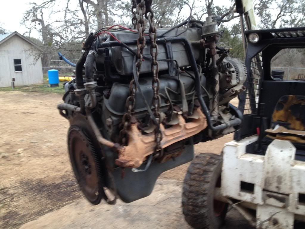

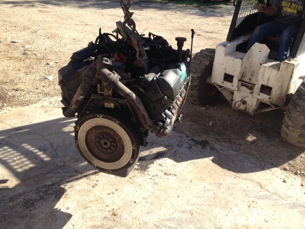

So here's some pics of the progress.

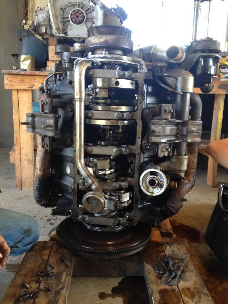

7.3 coming out of the 01!
Looks pretty good! Steel forged connecting rods were very good to see.

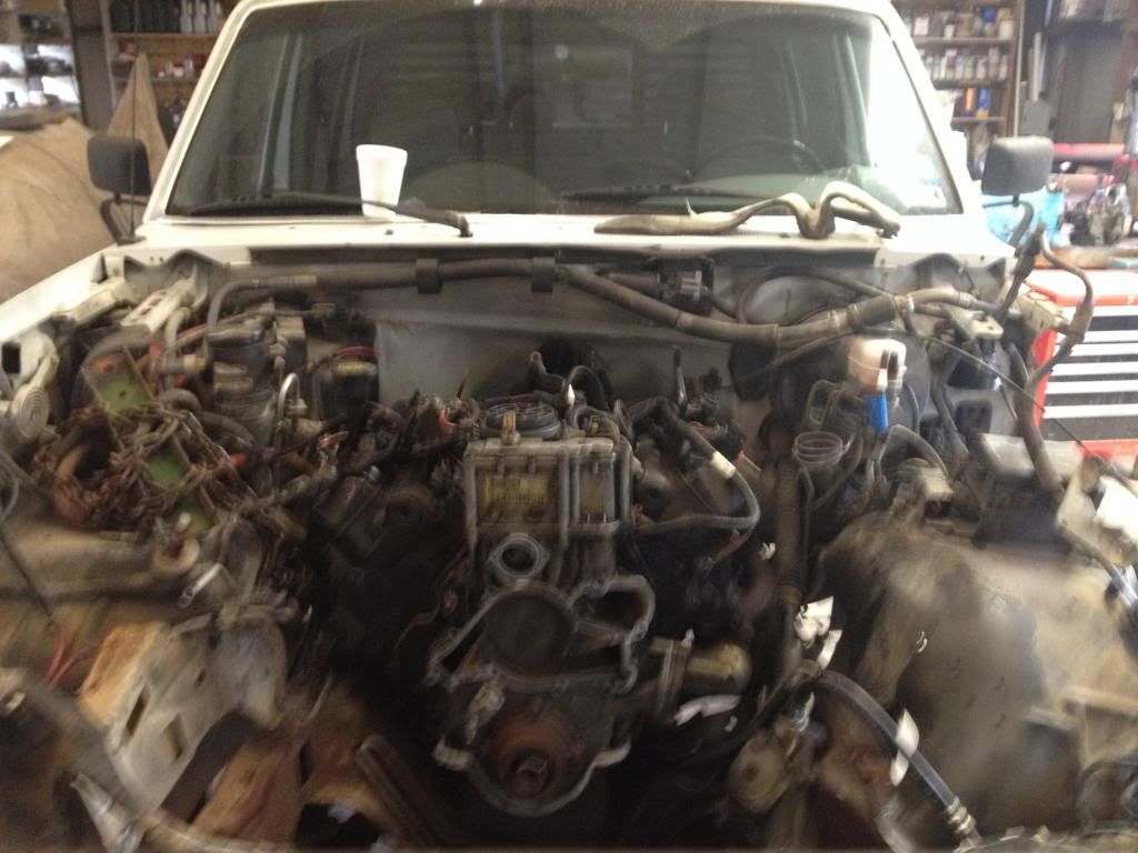

351 coming out of the 94! Don't rlly know what to do with this engine. It still runs well, think it's got about 20-25K miles on it with a ford factory warranty. Any ideas? I can tell you that it's way to under powered for a F-350.

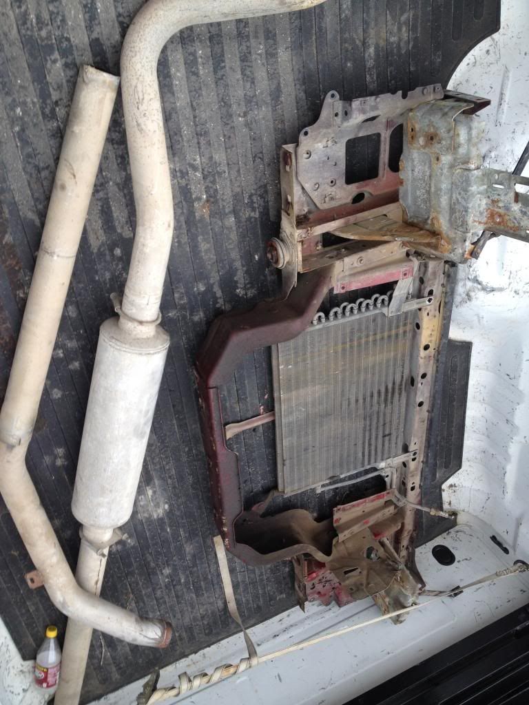

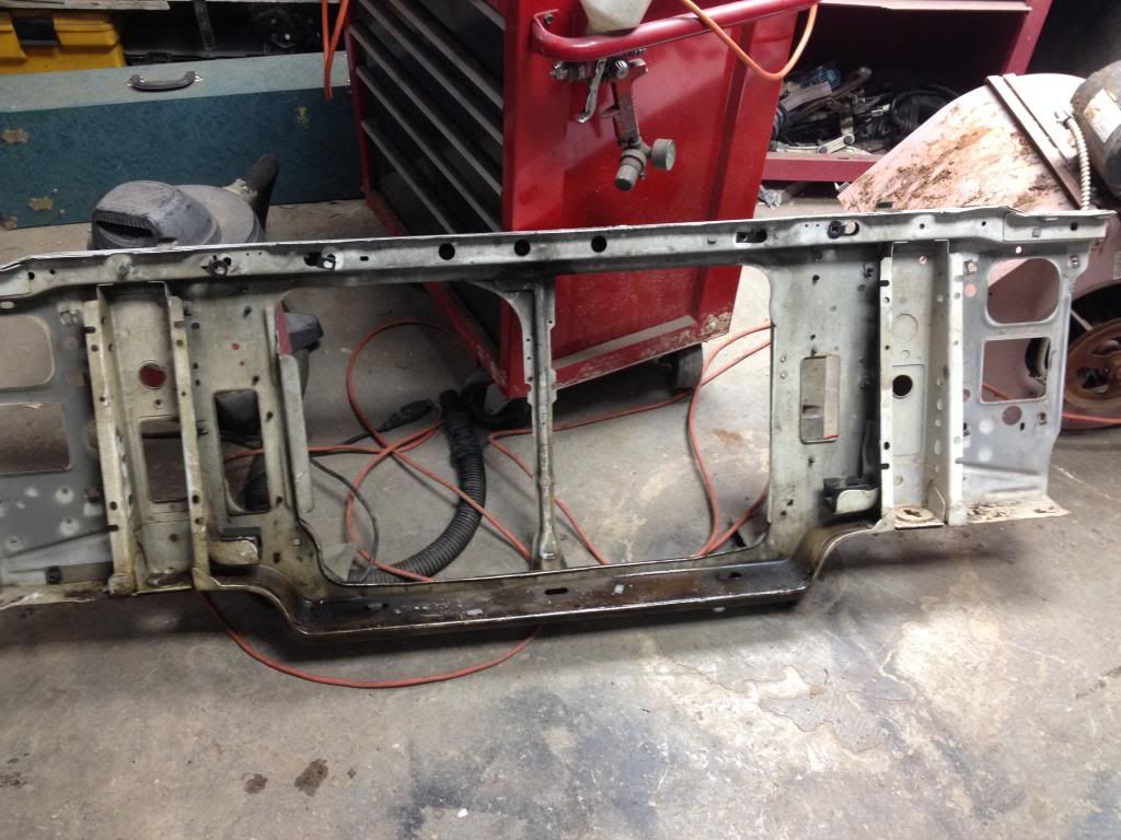

The old core support off!
"New" core support that will fit the larger 7.3 radiator. Going to have to have it painted white to match the rest of the truck. Also found some 3" exhaust tubing that i'm going to clean up and try to use for my intercooler/air intake tubing.

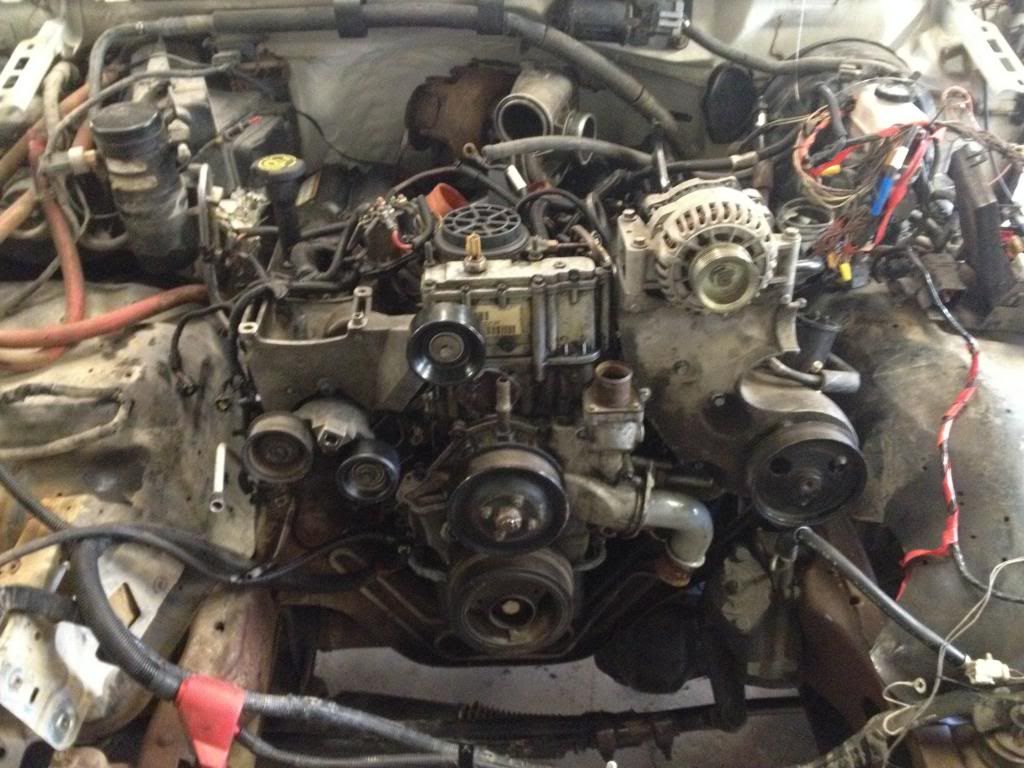

Had to change out the motor mounts and did some fabricating on the crossmember and the 7.3 went right in. Pretty exciting moment.
Wow I figured the picture thing out, lol. All these pics are from my phone and not great but its better than nothing.

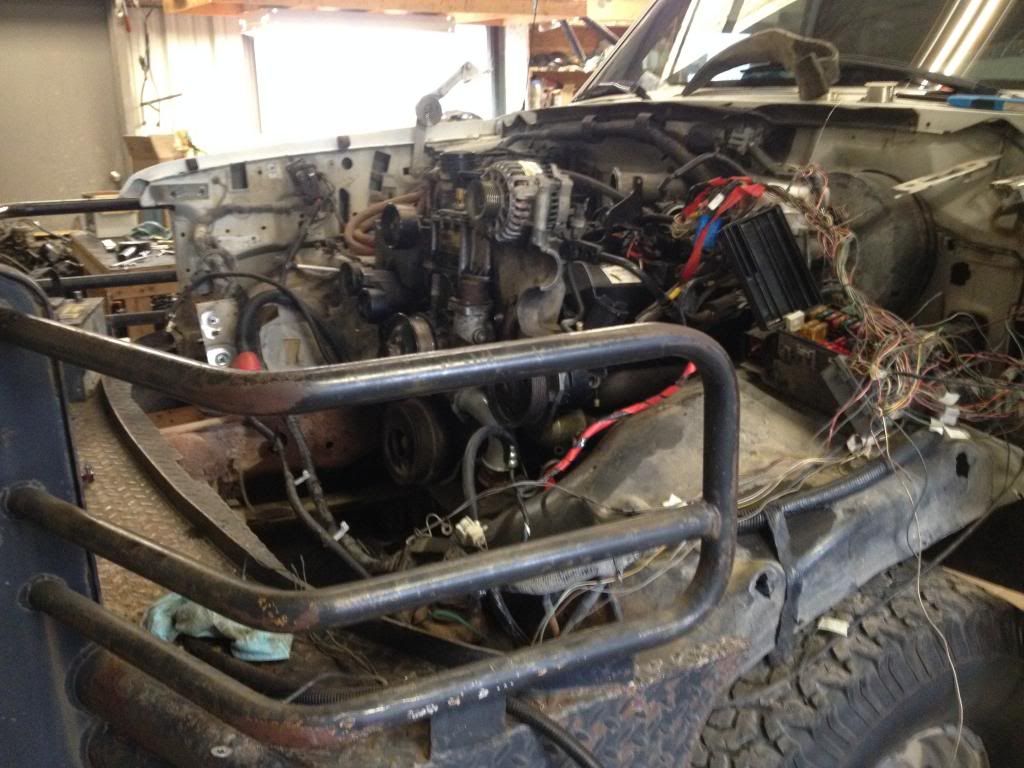

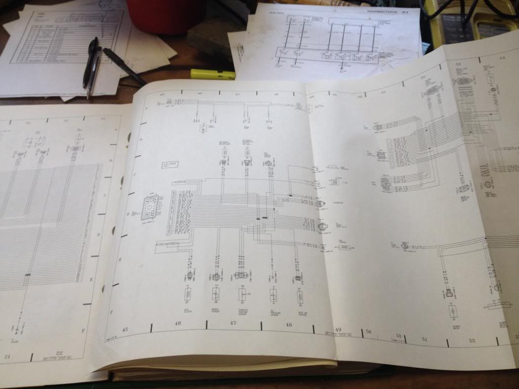

Now the hard part, the nightmare of hooking up the wiring/computers from the 94 351 to accept the 01 7.3. My head starts to hurt jst looking at it.
#12 · (Edited)

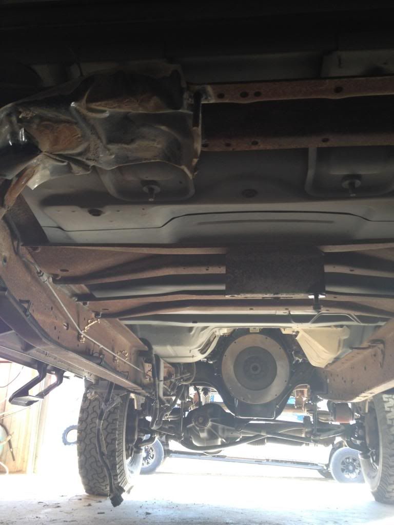

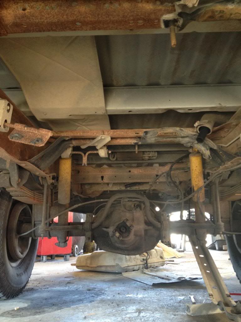

So a good portion of the wiring is done. What a nightmare! Worked on the fuel system conversion pretty much all day. Going from gas to diesel that is. Replaced the fuel pumps and the lines. Wasn't as hard as I thought it would be, but it was more time consuming, if that makes any sense.
Front tank down. Also got rid of the old ghey exhaust.
Back tank down! Also replaced the fuel inlet because of the different size diesel pumps. Almost forgot about that, facepalm, lol. By the end of the day the tanks were back up and some of the new fuel lines were in place. Even put 5 gallons of DIESEL into each tank, so glad to be done with gas. If all goes well she might get a test crank tmrw. Keeping my fingers crossed on that one. Don't rlly expect it to crank over the first time, but we'll see. :)

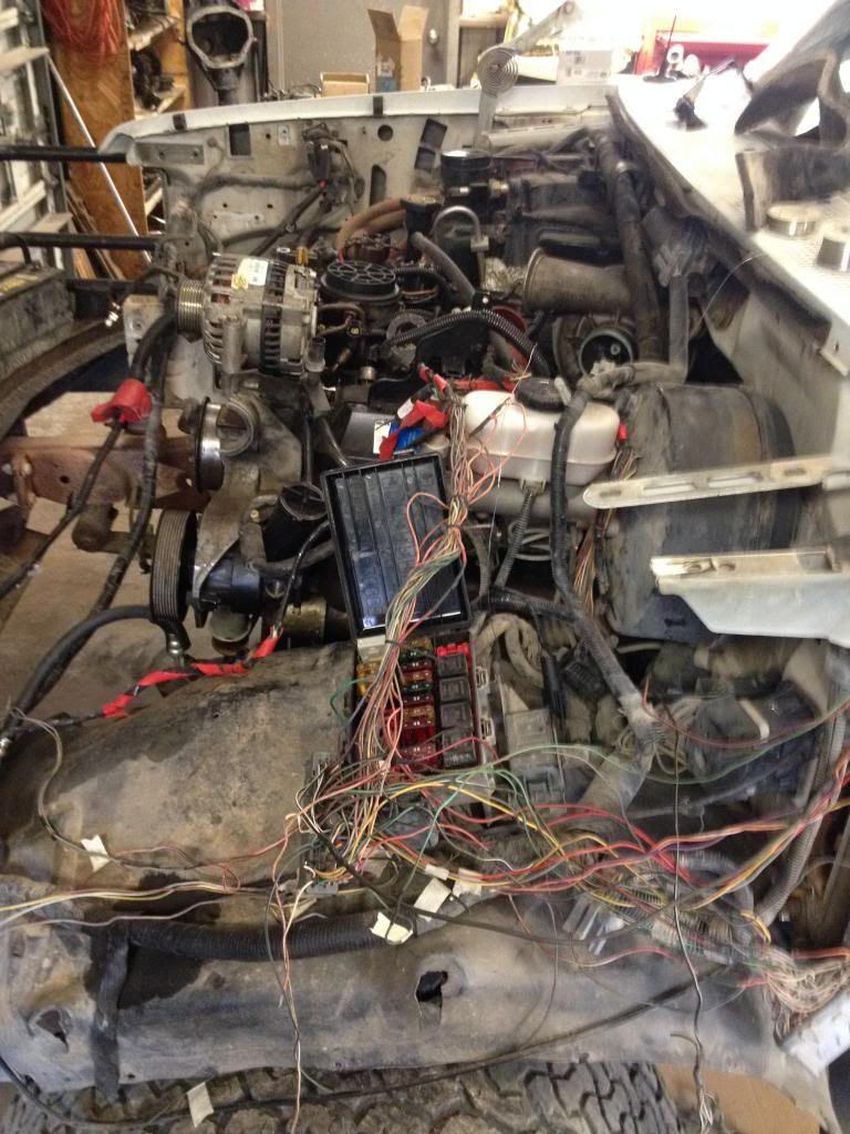

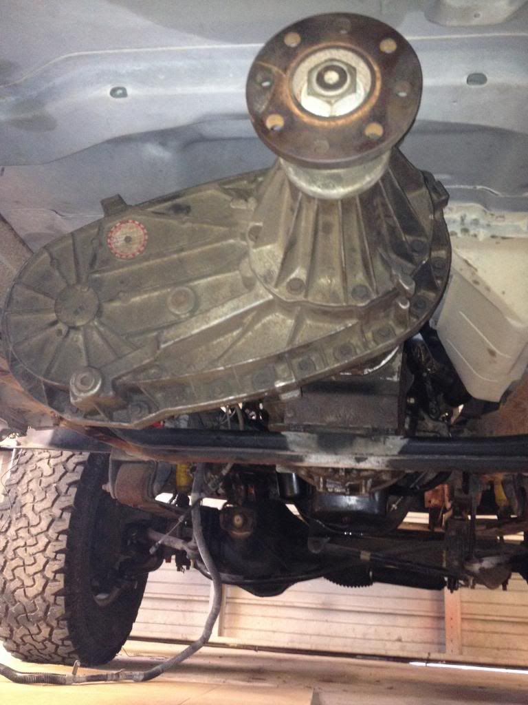

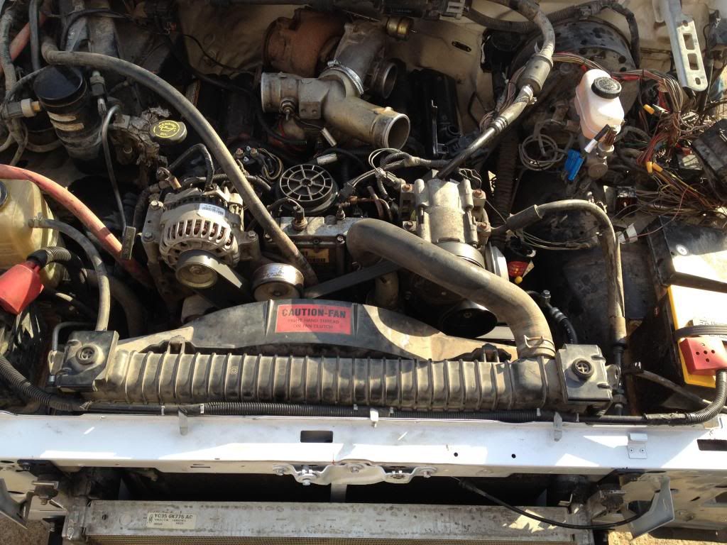

#14 · (Edited)
Got more work done today on the wiring system installed the starter, and even turned the engine over with the key which was pretty exciting.
Tranny and transfer case mounted!
The wiring job...did I tell you it was a nightmare!?!?!?...lol

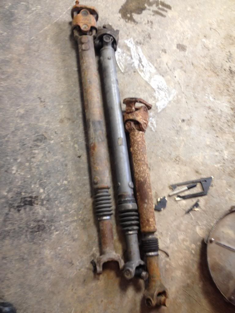

Have 3 4x4 drive shafts. The one on the left is from the 01 F-350 the one in the middle is the one off the 94 F-350, and the one on the right is off a dodge. Hopefully between the three of these I can make what I need to get this truck rolling.
Just fun to see the 7.3 in there!

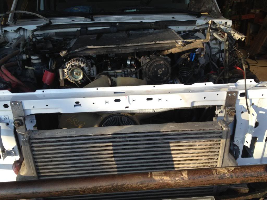

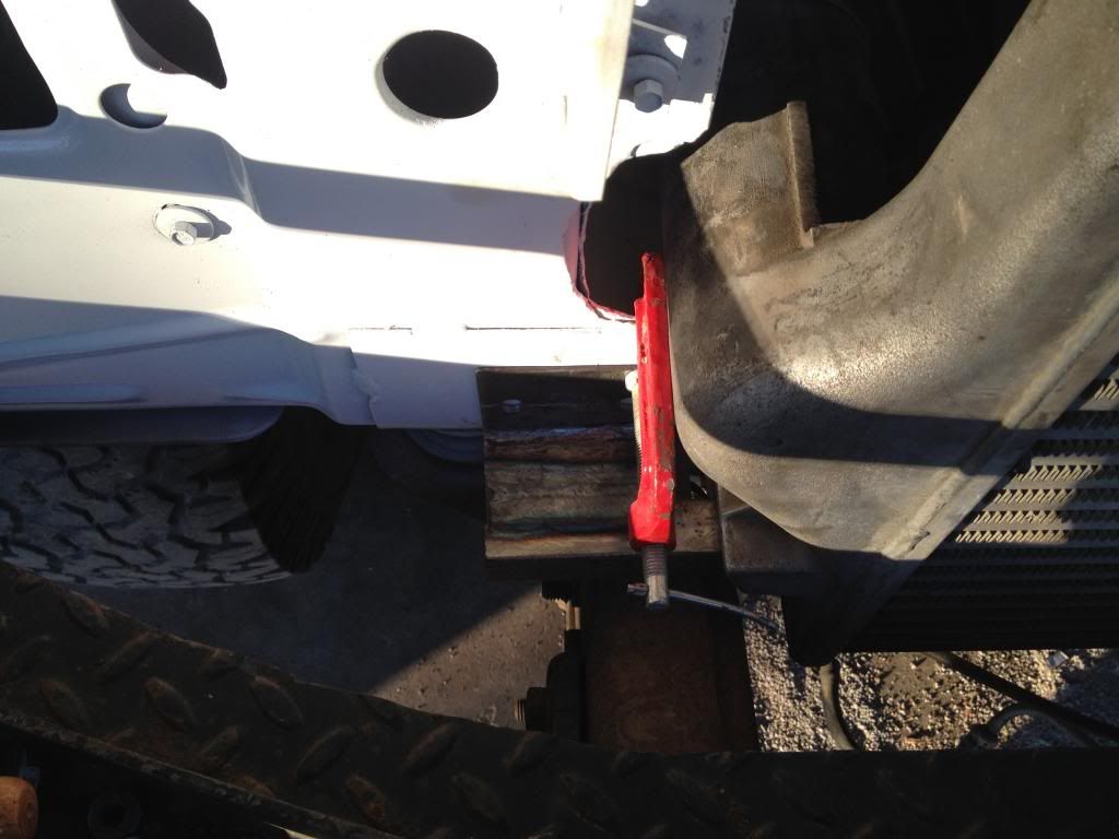

So I was able to get the core support and fender back from the body shop newly painted to match the rest of my truck. Well the fender will look better than the rest of the truck, tbh. Some pics of the progress Installed the brake & clutch pedals and installed the shifter. Also got the master and slave cylinder primed and put on. Looks kinda cool seeing the shifter sitting in there every time I open my door.

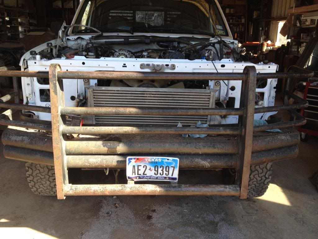

New core support partly installed, along with fitting in the intercooler.

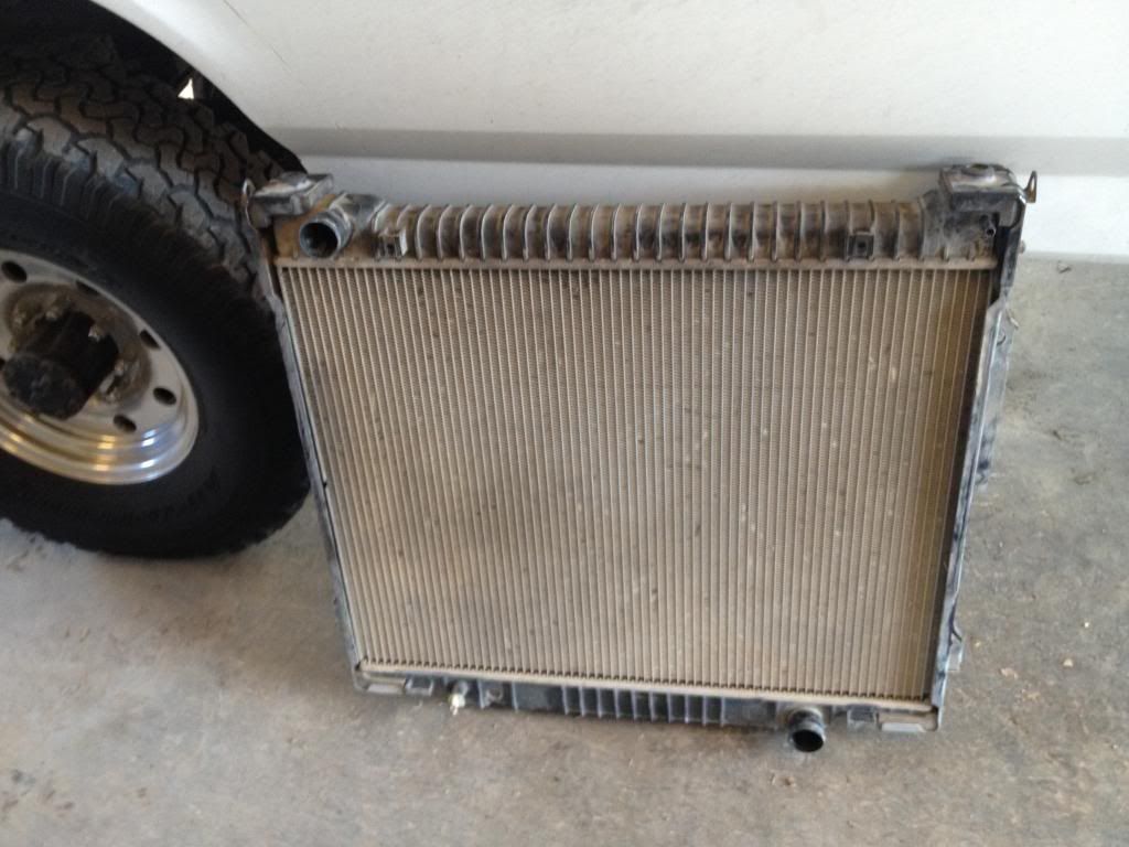

"New" radiator I was able to get off a friends 95 powerstroke that he's parting out.
Spent most of yesterday working on mounting the intercooler to the core support. Top brackets shown.
Hole that was cut and bottom mounting bracket.
Also purchased a new vacuum pump, power steering pump, and some new door hinges.
Forgot to take a pic of the newly painted fender. Lot of little tedious stuff left. Prolly wiring is the main thing that i'm going to have to get finished up with. Hopefully next time i'll be able to upload a vid of it running and rolling. Another thing are the innercooler pipes that are going to have to be custom fabricated and bent. Guess we'll see how that goes.

So today was an exciting day as we were able to put antifreeze and water in the radiator, crank this baby up, and take it on a very short trip! Here's some pics of what it's looking like.
Have the intercooler all set in its final resting place! Almost looks like it came that way from the factory...ok maybe not but it's close enough for me.

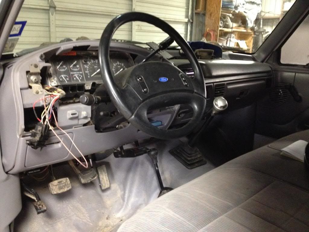

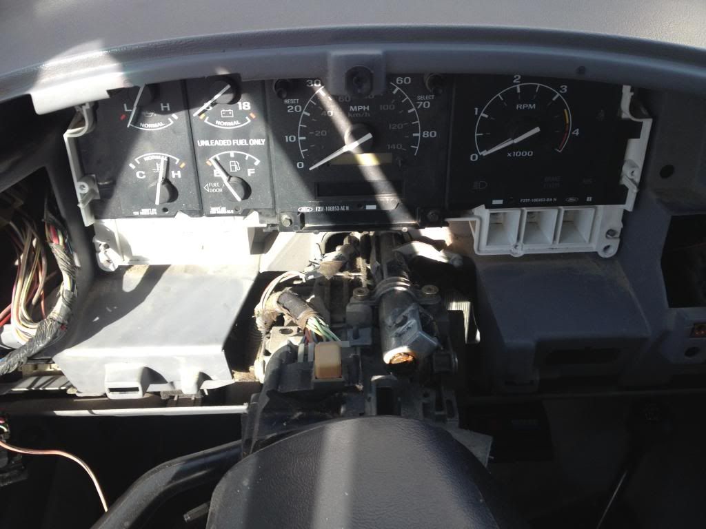

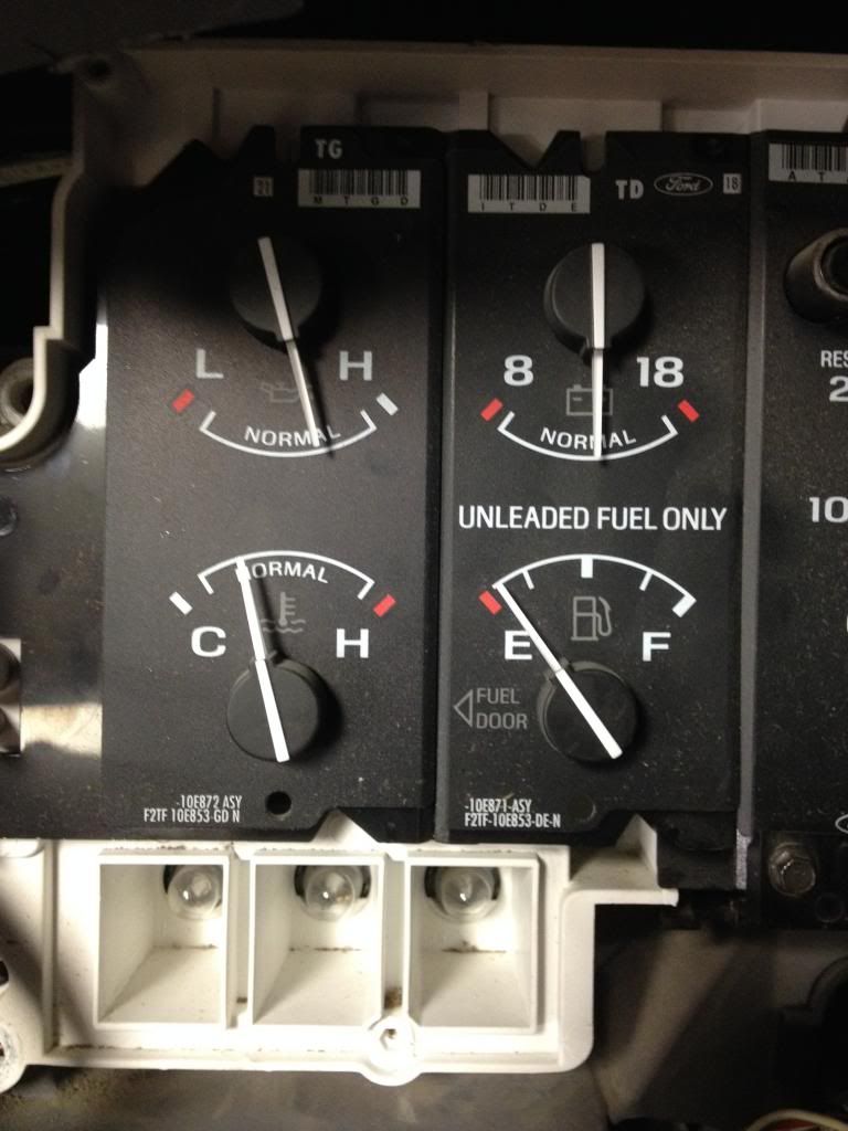

Worked a little bit on removing the old automatic shifter. Also i'm trying to get my tachometer to work. Does anybody have any knowledge as to what they run off of? I'm having some trouble finding out how to wire it up to work with the 7.3 coming from the 351????

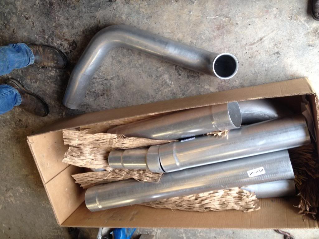

So a bit of an update. Got the 01 downpipe in and installed. It shipped 2 weeks after i ordered it which set me back a good bit time wise. It was a bit of a ***** to get back there. Ended up having to cut it in 3 different places and bend it to fit back there. Guess it was worth it though to have a 4" downpipe. Got some of the air intake in place. Going to have to do a little work on it too however. Its for a 94 7.3 so I guess there is a difference in the engines as far as the intake. I think I can get to work. Sure hope I can that thing was a little on the expensive side for an air intake. I also forgot to take a pic of the work after we got done bending the downpipe, but here's a pic and vid anyhow.
New turbo back exhaust system.

Check engine light is on and the tach still doesn't work quite right, but we'll get it figured out.
