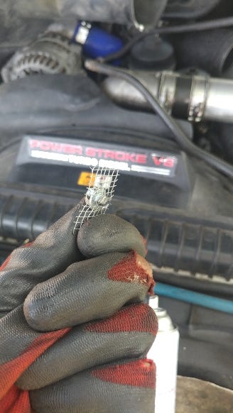

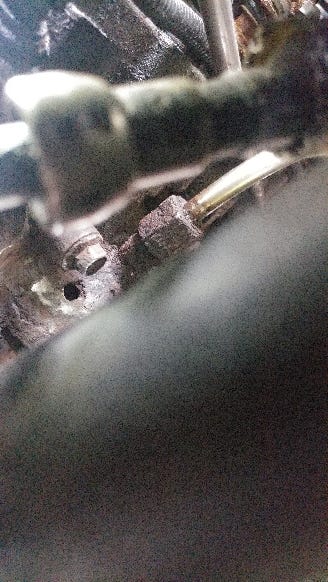

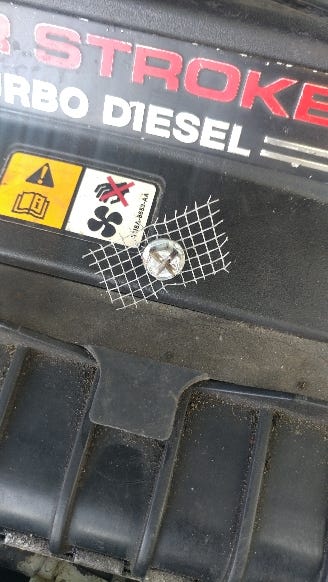

So turns out i have a hole on my drivers exhaust manifold and i am atempting a temporary repair (jb weld extreme heat + screw + mesh, tied with metal wire ) until i buy the parts and change them.

#8 ·
Tap the hole and put a pipe plug in
#11 ·
Why take it off ? -- cant get a good angle to tap the hole ?
Hook a shop vac on the tail pipe -- set to blow -- and tap away, the debris will blow out as you tap / drill

#16 ·
I agree once you touch that thinned out area the problem will just continue
a new or used manifold unless it is a stainless manifold I would look into a good hi temp paint for the replacements
