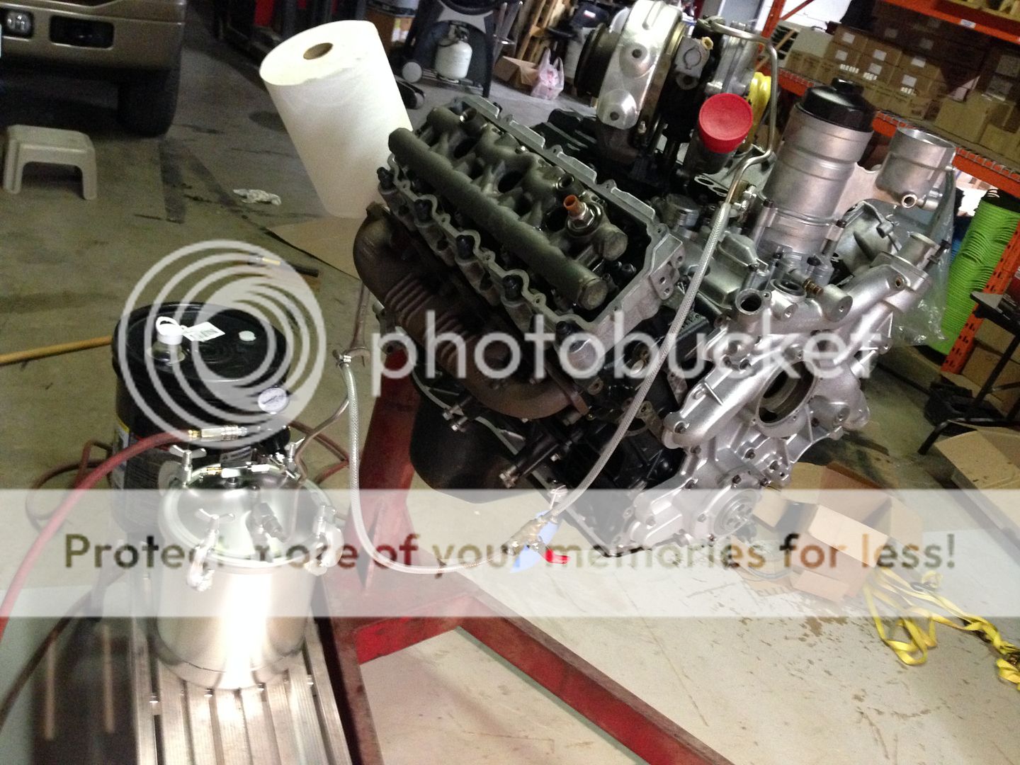

#5 ·
I bought a pressure paint tank from Princess Auto. I used it to do the initial oil fill on an engine I just built for my Ex. Put the bulk of the oil in while it was still on the stand. I had the turbo mounted to the engine and pumped in oil to the LP side through the pressure switch hole. When I had put in about half the oil, I switched to the HP side. I removed the plugs from the rails and pumped in oil until the air bubbles stopped and I had a solid stream of oil. I had HP oil within seconds of cranking.
If you are near Toronto. You are more than welcome to borrow it if you want. It is at the bottom of the 427 at the wife's office. I will be doing a Sudbury and Owen Sound road trip in the next week or two.
This method is truly priming the system and a better way to go in my opinion if you have a motor on a stand which is freshly built.

I saw priming tanks in the Goodson catalog, which I would have never known about if it weren't for Torens recommendation of the Super Scrapers. They were not cheap and I thought I would make something up as the whole priming idea seemed like a great one. Especially on a motor that is known to take a looooong time to fire when the oil system is dry.
When I was doing my motor, I saw that tank on sale for around $100. It worked like a charm after rigging up some adaptors out of old fuel lines and fittings.

#14 ·
A quick update.
To anyone thinking about using some form of pressure tank to prime an engine, I can now say that it is totally worth it on a fresh build.
I just built another engine for someone and put the initial oil fill in like I mentioned a few posts back in this thread.
Once the motor was in the truck, I pulled the glow plug module (to keep battery drain low) and the FICM relay (to keep injectors from firing). Watched ICP with my AE and saw well north of 500 psi during the first crank. Want to say around 900. Had the glow plugs, and more importantly the injectors, been enabled it would have literally fired up on the first crank.
Just for reference, I personally don't hold the starter on for more than about three seconds.
Plugged the glow plug module and FICM relay back in and had a purring engine on the second crank.
All I can say is that it was around $100 well spent.
