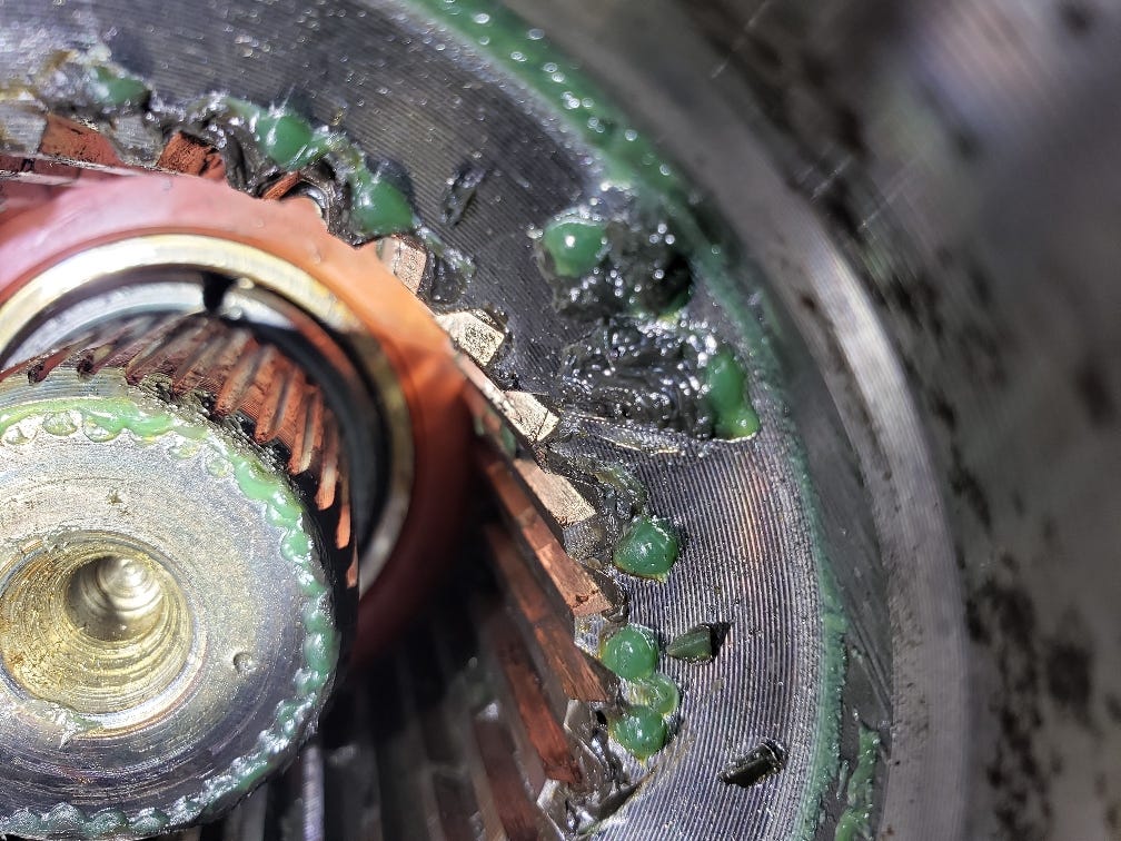

2008 F450 4x4. Trying to remove front front rotor to get to bearing hub for removal. Soaked everything w penetrating fluid, 4x4 hubs are out, lock ring removed, nuts off the four studs in the back that hold the hubs in. I have heated it up, sprayed lots of penetrant and let sit, and have beat the rotor for a few hours (now its trashed) and cant get anything to move. About ready to pull out the plasma cutter. Using a 6lb hand sledge on it, figurwd if the rotor wont come off the maybe the huband all will come out. No progress w any of it.
Other than the lock ring, there isnt another lock in there is there?? I see a small ring back on the axle shaft splines that has two holes like a spanner of some kind would go in there. Frustrated after two days on this damn thing...help please

I would think once all that was out of the way, the rotor should slip right off with a few taps of a 3lb sledge. Got a pic of the rotor itself stuck on the hub?

Yeah, brakes are off, snap ring off end of axle splines, four nuts off back of hub....ive put a full can of Kroil on all mating surfaces, knocked the studs in and sprayed behind them where the rotor would meet the hub face, sprayed inside the four hub studs, heated w a Mapp gas torch (dont have a oxy-acet torch). Thinking about a plasma cutter-torch all around just to the outside of the wheel stud diameter and get the rotor off maybe.

It sounds like you have a rotor rust locked on the hub pilot.
It's been a long time since I've had to screw around with a 450/550. I believe you should be able to get the largest bolt that will fit through the two bracket mount knuckle holes and a hut between the rotor and knuckle so you can use the bolts as a pusher to the rotor. A scrap flat bar can protect the rotor if you are trying to save it. Get it to move a little, back off, turn the rotor 1/3, and repeat. Then again. You keep going until it's free.

I am assuming you need to rotor off and the bearing and hub assembly out. You already damaged the rotor so getting brutal with is at this point is a go.
Here in NJ these are almost ALWAYS stuck in the knuckle. There are several ways of dealing with this.
The smart way that uses a tool and finesse - With the disassembly at the point shown, place this tool onto the one of the hub studs behind the knuckle - reconnect the tie rods and start the engine and bottom the tool out on the axle and use the power steering to push in the stud hopefully loosening the hub and pushing it out - switching from a front stud to a rear stud will be necessary. You will need assistance for this one. TOOL ---> 2-in-1 Dodge and Ford Hub Removal Tool - Cal-Van Tools I know he tool description says for F250-F350 trucks - the F450-F550 are exactly the SAME.
The second is to use a LONG prybar - 5 - 6 foot long. Leave the rotor secured to the hub and place the prybar behind the rotor and pry off of the knuckle - again switching from front to rear as it breaks free and begins to move.
The third is brute force. In a case like this a HAND sledge is like hitting it with your wife's purse. Again, leave the rotor secured to the hub, use a long handle sledgehammer and beat the hell out of the rotor - this requires the truck be on a hoist, in the air to allow the hammer to swing.
The one thing I caution against is using an air hammer with ANY choice of tip - the studs will mushroom and make the job exponentially more challenging.

After beating the living f--k out of the rotor it came off. Now i have the hub loose after cutting the studs off w a cut off wheel but the stub axle wont come out. Its stuck in the bearing, ive tried whacking it w no success. I can pry the hub out maybe a 1/4" but thats it. The axle is locked in the bearing
