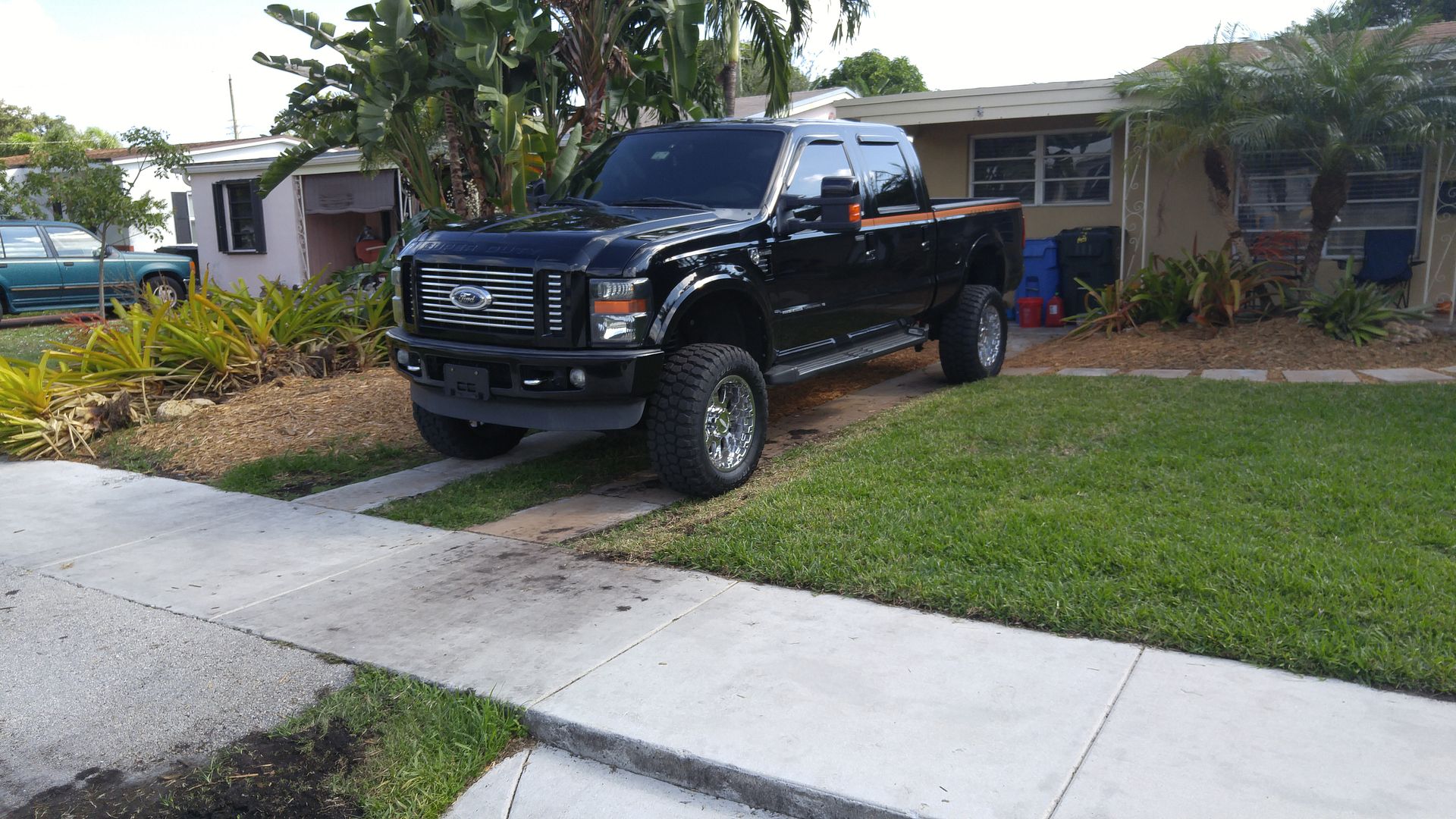

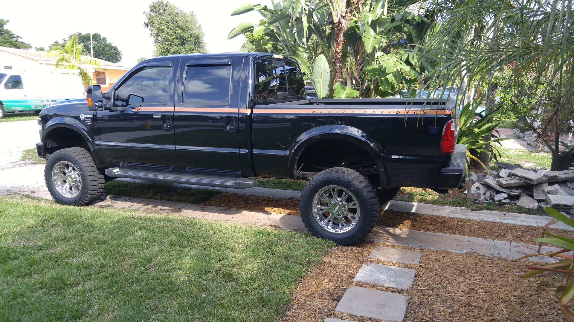

So I have a new to me 2008 harley f350
Installed this bad boy over the weekend has dpf and cat delete. Which is a funny story. I bought a new dpf cat delete pipe just assuming since I bought it from a dealer would have the emissions stuff on it. Well ig get my afr pipes, setup to do the job look the truck and it was already deleted.
Anyways back on track, what's the highest apart an tune I can somewhat safely run with the stock trans. I'll be doing the egr delete this weekend. I'm running the 195hp tune and all is runing well. Ib tried the 250 tune and turned it right back down the trans was shifting so hard (something seemed wrong) anyways what's the highest tune you guys run for daily driving with a stock trans?
