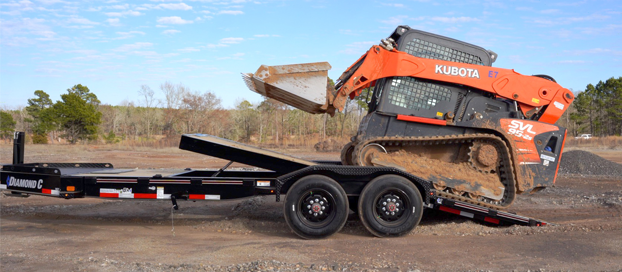

Don't blame you fro wanting to get lighter ramps, I was just concerned with damage. I have steel tracks on the skid most of it's life, and have experienced all the fun things they do on trailer ramps. since you are just running rubber, there would be no need to a covering on the ramps.
A dedicated skid trailer is real handy for hauling the skid, but cant haul anything else on it. Currently have a Diamond C 14k tilt deck ...no ramps, flat deck

I have one of these , maybe something like this would serve your needs. My Son's drag car goes right up on without any extra ramps.

Unfortunately the trailer I use is a specifically modified car hauler so I can stand underneath and spray a non drying coating. But we do have a tilt deck just like that and some other flatbeds. The wedge trailer is a modified custom build though. I wont say I've never hauled cars for personal reasons or events/friends but its 99% a mobile service for undercoating.

@backhoebill I looked a several trailers before settling on the Diamond C , ...liked the tilt latch and how the bed pivot works, better than the others -- I did make a mod to cause the latch to auto reset, that way the tilt will click in the lock position. Is real handy feature.
@JustinOOO9 I missed the picture you had posted a few posts back ...nice trailer for doing the seal coating -- a set of aluminum ramps would work nice for it -- I am thinking the thinner ones tho, since you are pretty close to the ground already
