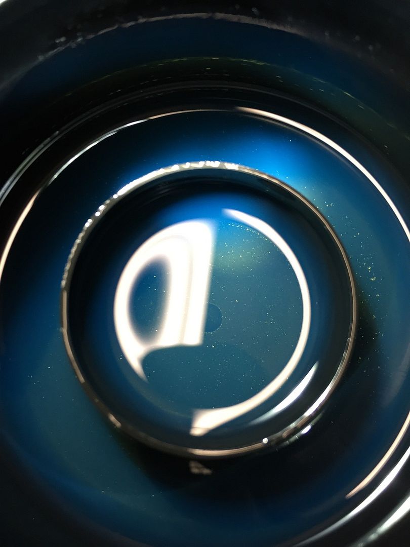

did you use a black container to catch the fuel? that is very important as you will really see the metal against the black.

It was suggested to me today that I should have a lot more metallic than the minute amount I have for casastrophic HPFP failure and that it's possible what is showing up came from the LPFP. A bad pressure regulator could cause no fuel rail pressure. I noticed today while messing around on the scanner that I could unplug the regulator and it had no affect on my rail pressure at all. I also notice that with the key on and not trying anything that my rail pressure is jumping from 42.1psi to 98.6 back and forth about every 3 seconds. Now I'm lost. Do I have some faulty sensors/regulators?
#20 ·
without seeing how much metal was in there, i can't say if it's acceptable or not. the secondary filter should have caught any debris if it were from the lpfp. your frp will jump around a bit between 0 and 150. that's pretty normal. if the hpfp is shot, disconnecting the reg won't make a difference in pressure, since the pcm will command it to shut anyways. not saying it's not the reg. it is possible. post up a clear pic of your sample if you can
#24 ·
good news is, that's a great picture.
bad news is, that is not a minute amount. that is definitely not looking good. that fuel, along with the particles in it, are going straight into those injectors.
i'll say this; if that truck came to me, lpfp whining, low icp cranking, that in the fuel, i'm not hesitating to call a contamination kit on it. and i respect the customers money as if it were my own. not saying a pump alone won't get it running. you did say you were able to get it running with ether, so who knows. but i can't see that metal not causing any damage to the injectors
