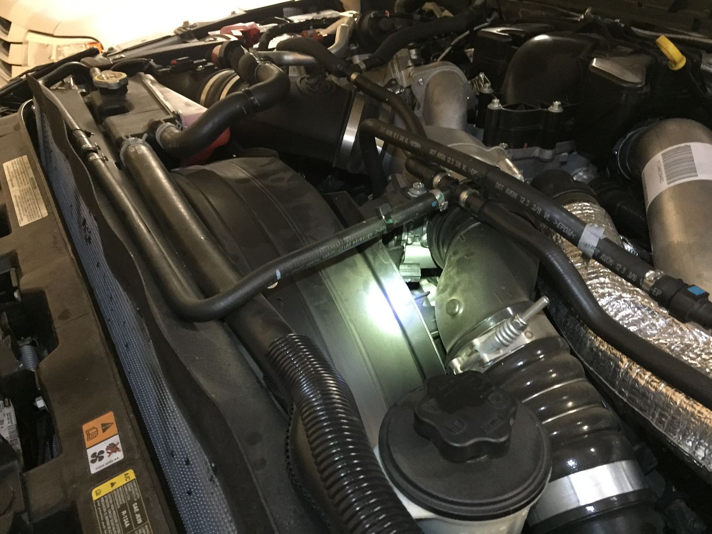

I recently installed the EGR block-off plates on a 2015 F250. Many blogs state that there are 3 plugs to disconnect, however I am only halfway certain on one of them. I say "halfway" because when I unplugged it immediately after the install, the truck ran horribly. I then reconnected the plug and only noticed a ~5-6 acceleration delay with the pedal depressed.
I have looked for specific pics that show the exact plugs to disconnect on the 2015 6.7. Most blogs show 2 plugs with the orange housing, however, there seems to be only one on the 2015. I took some pics to show what plugs I thought may be the correct ones, however I am not 100%. Any help is greatly appreciated.

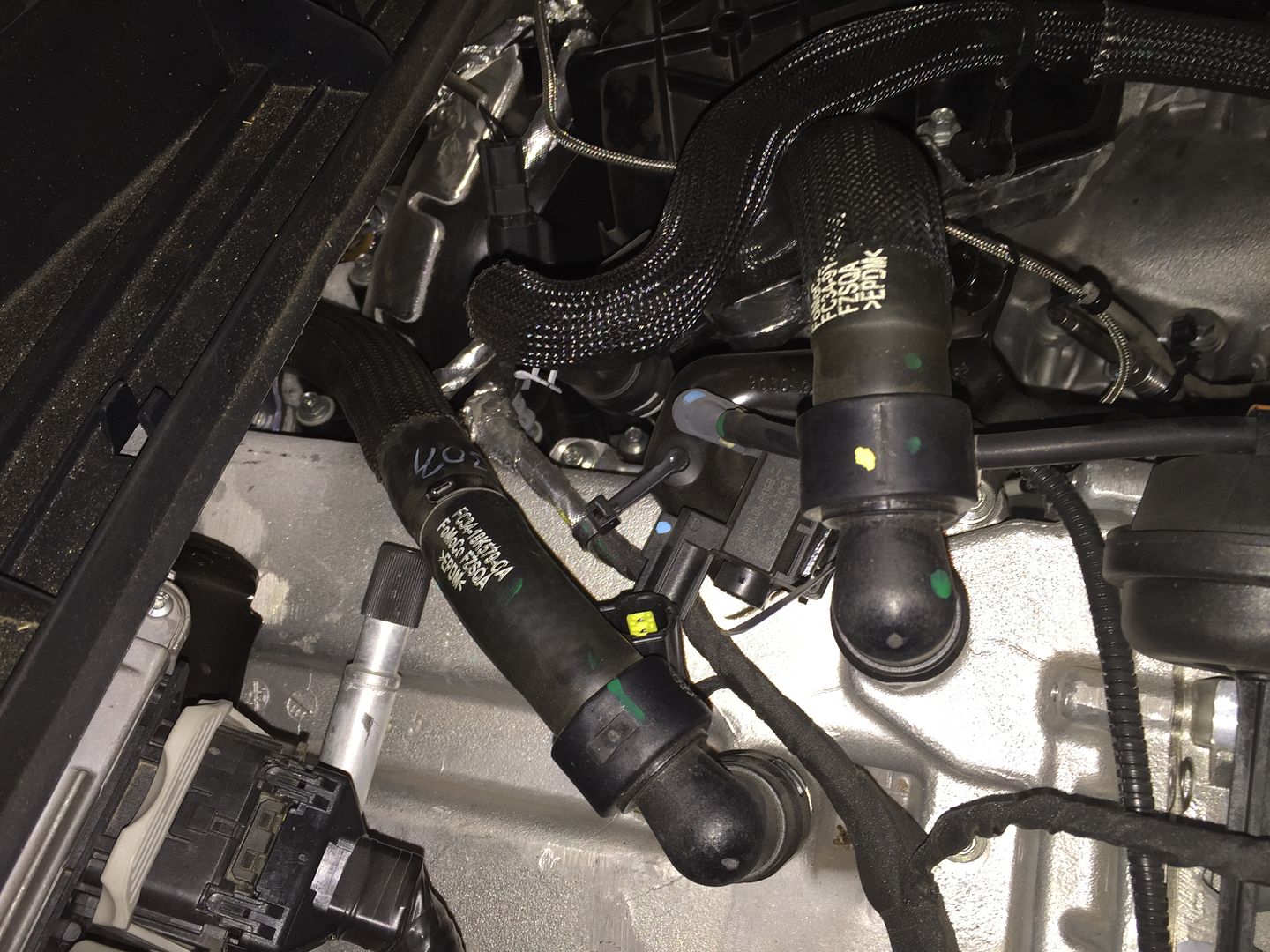

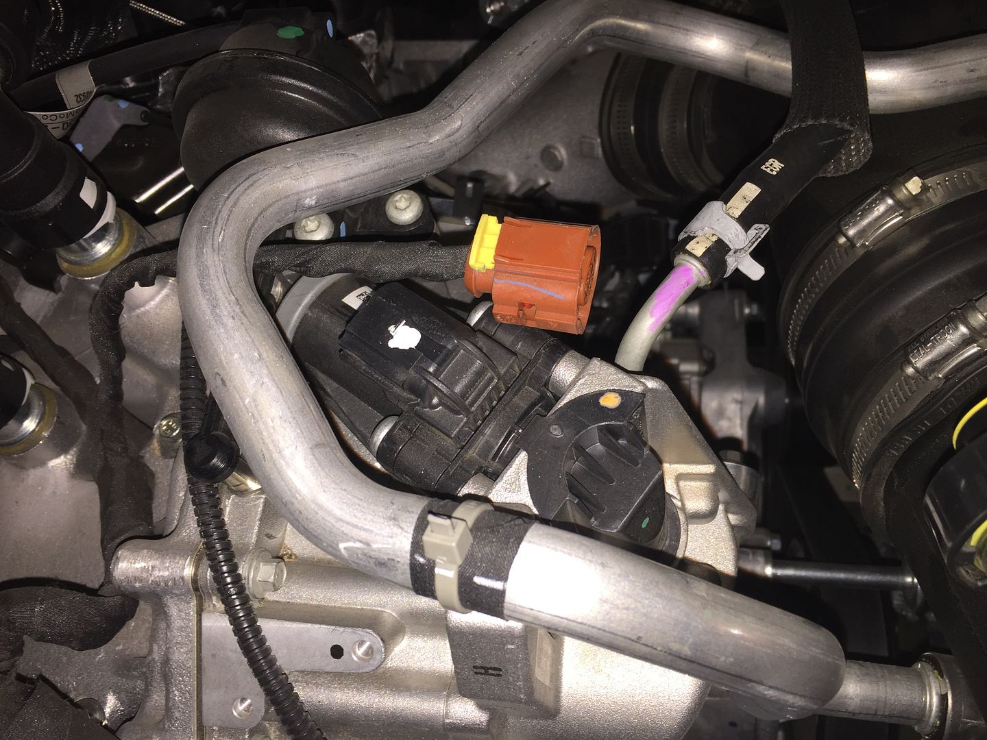

I went out to the garage and took some pics of the three plugs I disconnected on my 2015. First one has a white dot on it, second one has a blue dot on it and the third one is just above the flashlight beam. Maybe this will help.

One question, on the last photo, I was under the impression that the plug there stayed connected and that it was attached to the block-off plate that measures exhaust temp.
Also, I really appreciate you taking the time to go out and snap a pic. I'm really trying to learn as much as I can and the forum members here have been exceptional. Much thanks.
#4 ·
No problem.
No the EGT sensor connector is a bit further back towards the cab.

I unplugged the three plugs that FX showed. The last one was orange also. I pack the ends with dielectric grease. If the end is free and you have some room - like the connector has a few inches of wire on it - uou can also wrap it all up with electrical tape. I even thought about then dipping it in Plastidip to really seal it well (still removable). For the connectors that are hard to get to, I packed them with dielectric grease, then covered them with the black vinyl push-on caps to further protect them.
