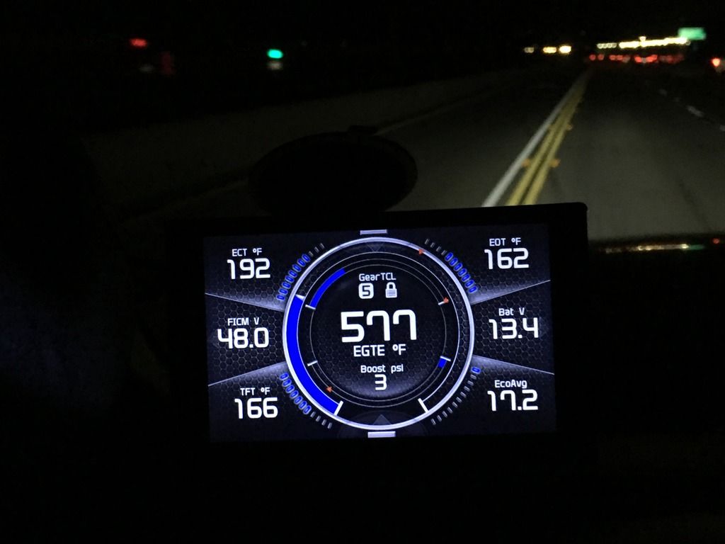

the BPD air-oil cooler doing its thing. its money well spent.
road time: 3+ hours
outside temp: 65-68 degrees F
MPH: 75-80
