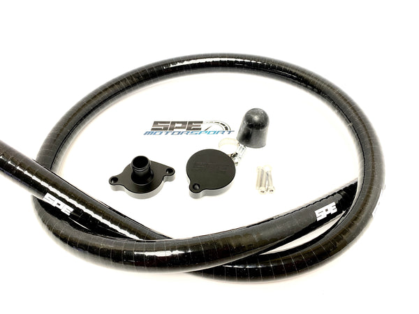

CCV oil separator filter change interval is only for 2017+.
For the 11-16 6.7 PSD failed CCV system the best thing to do would be to replace it or reroute it.
