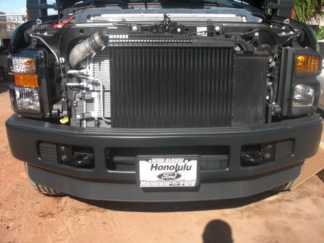

Old ugly worktruck headlight assembly, circles point out mounting points....BOOO!
Nice new Harley Davidson assembly...Yay!
Mounting point comparisons: <4points=1 on top, 2 on the insides and 1 on the bottom>
BOTTOM:
RIGHT SIDE:
TOP:
All the same no DRILING, HAMMERING, CUTTING!!!!

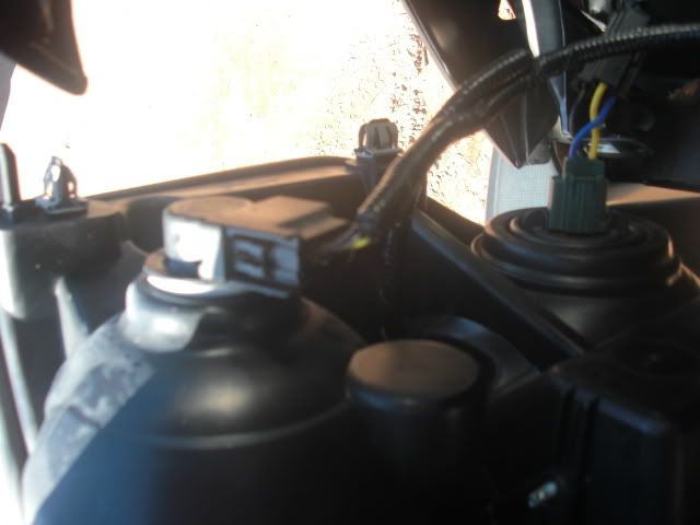

Headlight Conversion Harness...thanks Bill @DFuser.com
Black Sealed Beam>Green H13 Aero Lights...if you can't figure it out you deserve to run the work truck lights....JK!
Bulbs plug right in:
