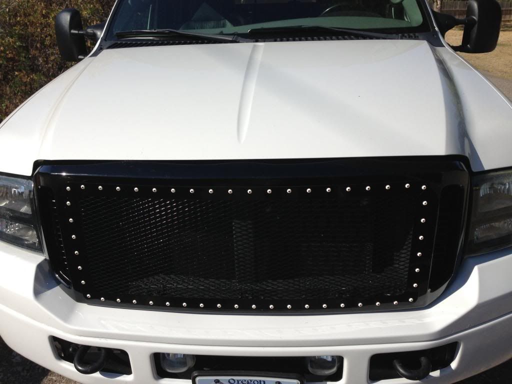

I've recently had lots of interest recently on how I made my grille for my truck so here it is. The grille is already finished(and has been for 2 years now) so I will do my best to show everyone what steps I took, measurements, cuts to make, bolts I choose to use...etc

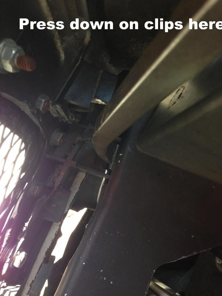

Step 1: Removal of the Grille
Remove the four small 5.5mm bolts on top of the grille.
Then use a flathead screw drive and press down on the 5 mounting bracket/clips as you slightly pull the grille outward.
The clip will not come all the way out but as you pop out more clips the grill will come right out.

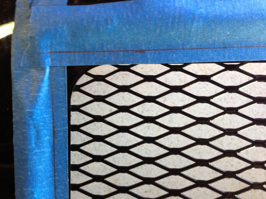

Step 2: Measure for Cutting

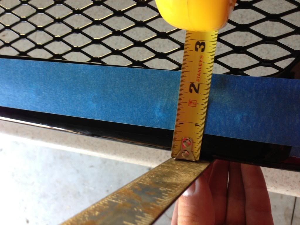

Measure out your cuts and use painter tape so your measurements are easily seen while cutting. (Keep in mind my grille is complete already) First start with the bottom and make a mark 2" up all the way across the center section to be cut out.

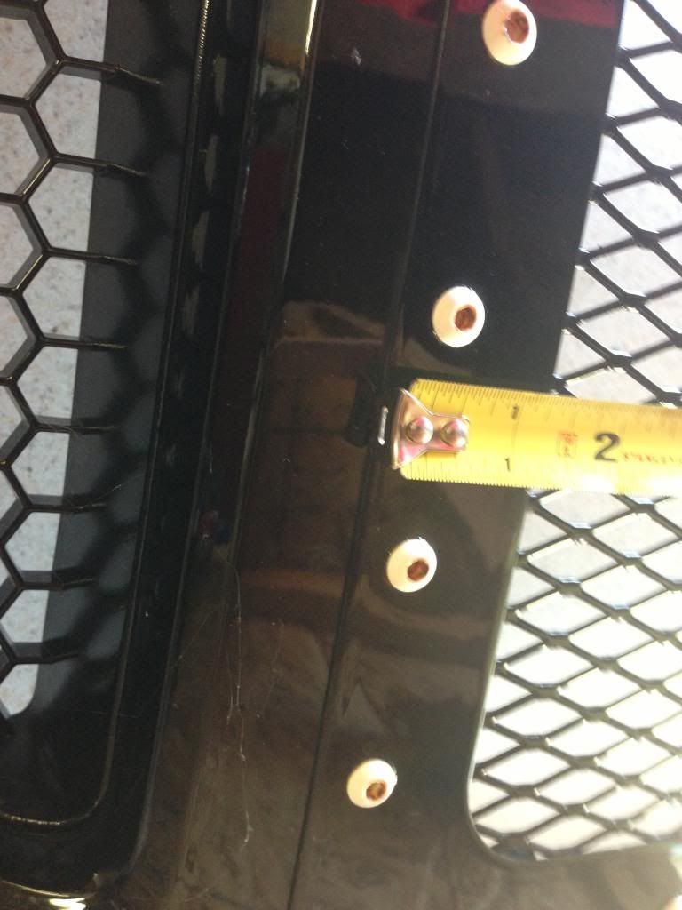

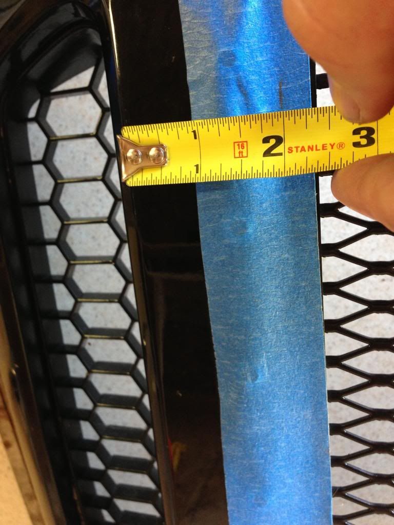

Then mark out each side of the grille from the outside inward measuring 2" from the crease.

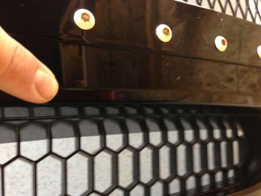

Picture of the edge (crease mentioned earlier) I measured from (middle of my finger)

Step 3: THE CUT

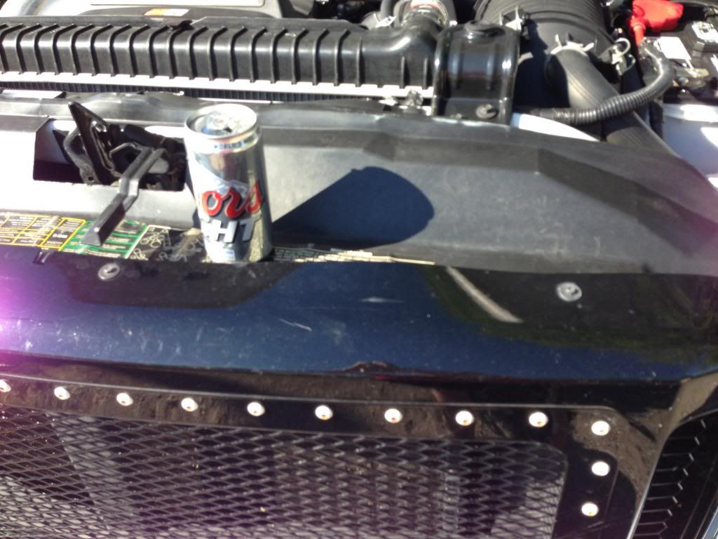

First thing I did was was take a deep breath and.... Drink a cold one! I'd recommend the silver bullet but hey... That's just me. Simply use the cut off wheel and follow your marks. This doesn't take long as the wheel cuts right thru the plastic.

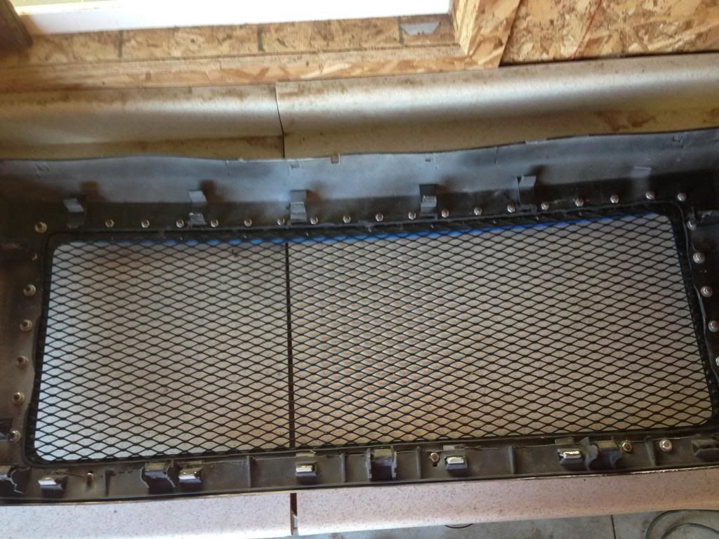

Step 4: Making the Grille Center Section
I went to a local metal store and purchased a sheet of expanded metal 36 3/4"x 13" for the center piece of the grille. Next I decided on the actuall width of the piece of metal that surrounds the cut-out. I choose to go with a width of 1 1/2".
The diementions of that piece of metal are 39" wide and 15 1/4" tall. Next is determining the location of the hole for the bolts. I choose to go with 8 holes vertically and 18 holes horizontally. The spacing worked out to be an exact 2" apart. Notice that my bolts on the vertical side didn't exactly line up with the horizontal bolts but I was happy with the results and actually like the way it looked. (If you change the number bolt holes and spacing keep into consideration that the hole isn't to close to the outside edge). Choose your bolt size before the CNC machine cuts the holes (or before you drill your own holes). For that piece of metal I took the easy route and went to a metal fabricator and had them input my measurements into a cad program and they cut out the metal, cut the holes for the bolts and welded the expanded metal onto it all for around $40 total! Make sure the expanded metal is only covering a 1/2" of the new center section. I then purchase my bolts, nuts, and lots of washers. I choose a rounded Allen head type. Can't remember the exact size... But I got 32 bolts 3/4" long for top and sides, 14 1/2" long for underneath the bottom plastic mounting bracket/clips and 6 1" long for going over the top of the plastic mounting bracket/clips. (You could do this to almost all bottom bolts but mine is more than strong enough) 52 in total bolts and nuts. I also bought a whole BUNCH of flat washer and locking washer as well.

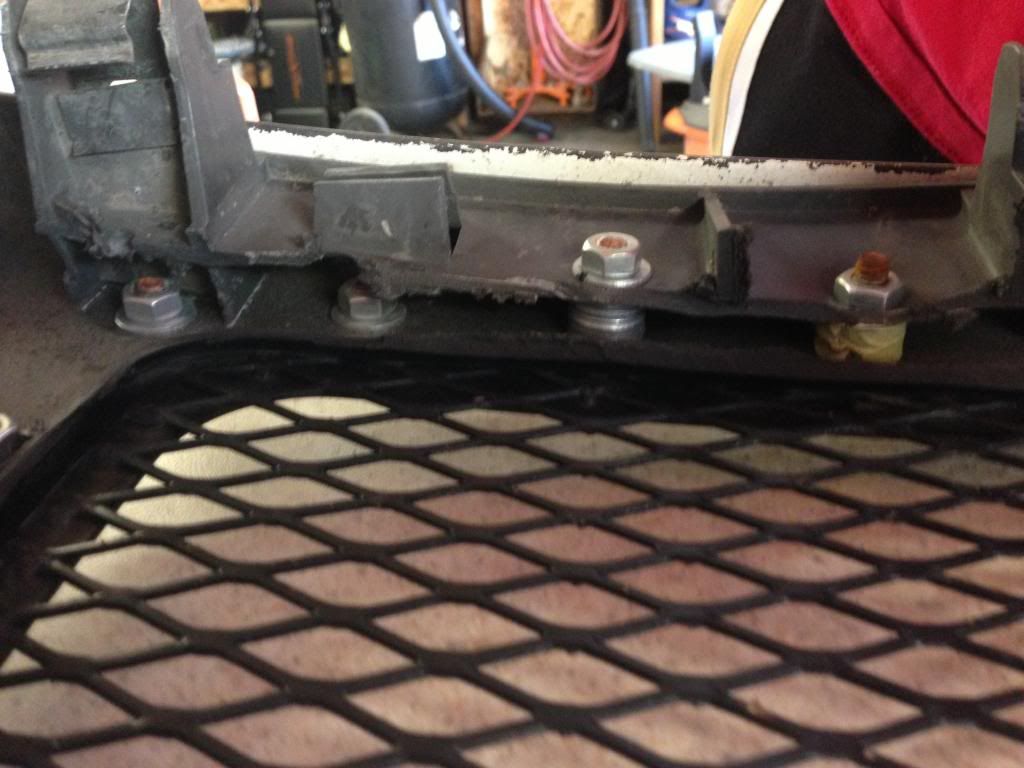

Step 6: Grille Assembly
Once everything is completely dry you can start the assembly process. I started with the center bolts and worked my way towards the outside as I went so the rectangular center section would form to the grilles arch type design. When bolting the bottom of the grille, use the small 1/2" bolts, lock washers and nuts to secure it to the grille. Be sure to leave out the 1" bolts that are going to support the mounting bracket on the bottom. Then use then 3/4" bolts for the sides and top of the grille. After all the bolts are in the grille new center section should be contouring nicely on the grille and looking good! Now put the plastic mounting bracket/clips on the bottom of the grille and use several washer with the 1" bolts to help support the mounting braket. Once all the 1" bolts are in, work your way around the grille re-tightening all nuts again just to make sure.
Here you can see the 1" bolts with washers used to help keep the mounting bracket supported supported to the inside of the grille.

This ones pretty simple.... Pop the five clips in the bottom of the grille into the trucks grille/headlight support and put the four 5.5mm bolts back in the top. That's it! It's actually not to hard since I was able to do it! All it takes is patients.

I always get asked where I got my grille and when I tell people I had it, I always get compliments. Someday I'll get off my lazy arse up and sand the rust off the bolts and touch up the paint. It would be very time consuming so I haven't bothered with it yet. Good luck fellas!
