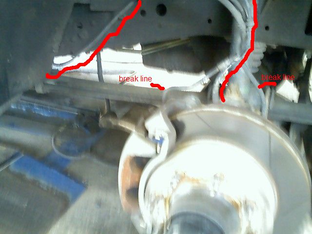

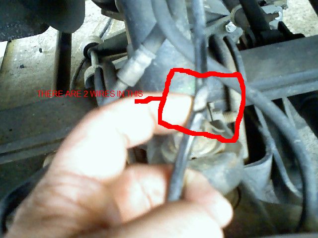

this is on a 2000 excursion 4X4 auto locking hubs. right front it looks like the tire has worne the shelding off a line that is protecting 2 wires that run imbetween the break lines then to behind the fender well liner. i am going to attach some pics to help identify i might be way off

9,392 Posts
if the wires were broken, even thought they may be exposed , the light would come on nstantly ,the abs does a self test every time the key is cycled , if it detected a problem it would turn light on right off, wrap it up and youll be fine
