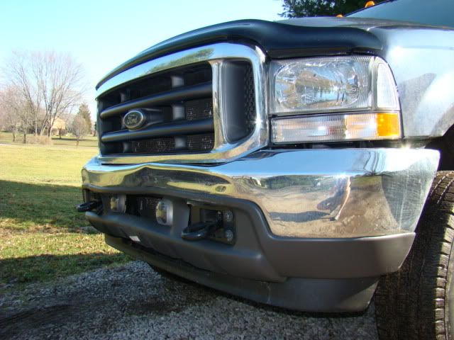

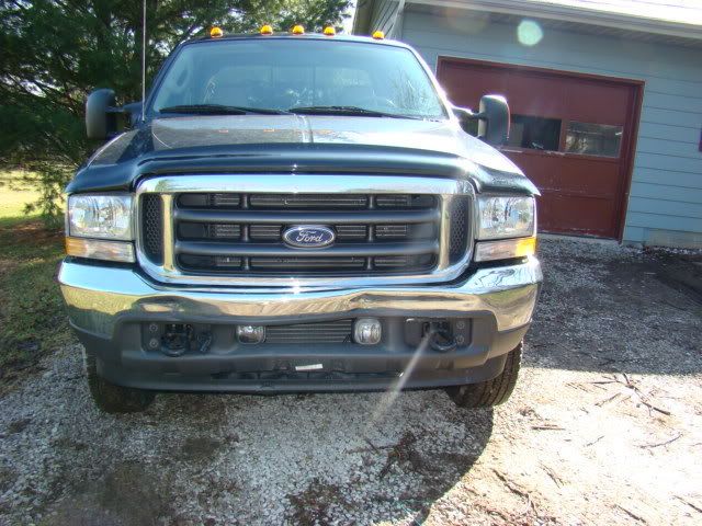

I wrecked my truck and am trying to decide if I just want to have the insurance company fix it or if I want to convert the fron to an 05 and newer look. Ok guys, heres the question. What do I need to convert the fron of my 04 to an 05. I know the grille, bumper and lights but is there anything else? I know the blocker beam (cross member) behind the front bumper is different but not sure if it needs replaced. Here is a picture of my 04 to give you an idea of what I'm looking at. Just weighing my options. Thanks for any input.
