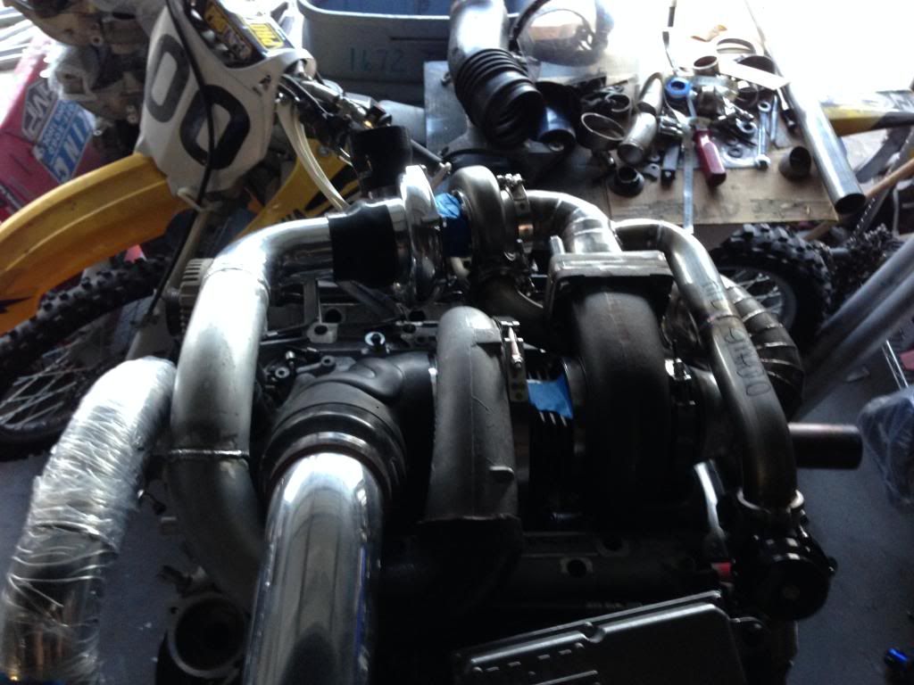

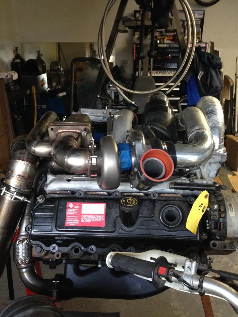

Ok so some pix as I was building this headache..

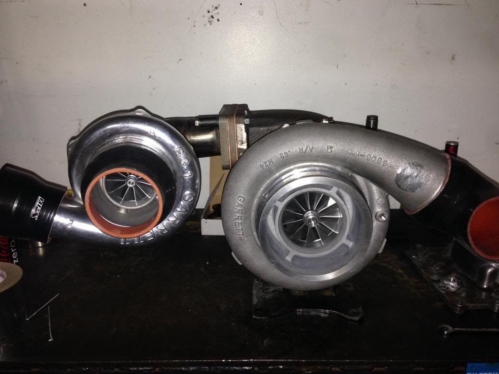

This here is the 2 chargers
This here is the bullet proof oil cooler

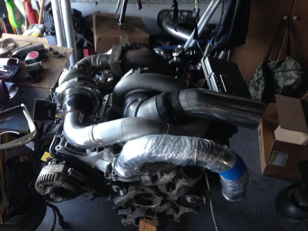

Here is a side view of the headache
And some front and rear shots
I should be installing my fuel system here this weekend so I'll keep y'all up to date and when I make the mounting plate and have it bolted. I'll be using the fuel lab and the airdog filtration.

Got an update... Installed the fuel lab and fuel lines to the heads. The passenger side line was left alone due to the second alternator I'm going to be running once the new kit is on. I mounted the fuel la. To the oem existing pump mount. It worked like a charm
I'm gonna take it for a spin and check for leaks. So far so good though
