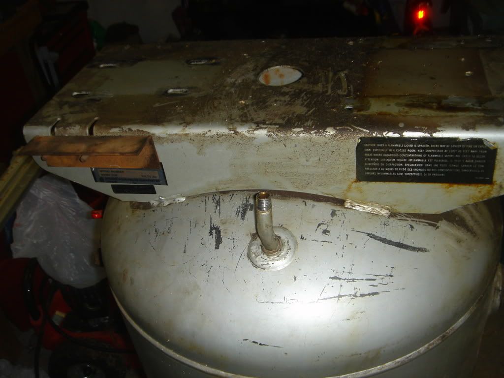

I picked of this bad boy today:
60 gallon compressor tank.
It is a little bigger than i planned. It needs to live in the bed of my truck under the bed cover. That gives my roughly 22 inches. My plan is to use the big 2" (I think it is 2") plug opening, elbow out to a 2" suction hose.
Questions:
1.) First of all, any tips on getting this plug out? I have drenched it in WD40, let is soak, then whacked it repeatedly with a mallot/pipe wrench. No dice.
2.) I may not have the room to orient the tank so that the plug (and 90 elbow) point down because of lack of head room. I will probably have to orient it with the hose coming out the side. What is the best way to design a poor-mans pickup tube inside that tank using that same 2" opening?
3.) I really don't have use for the legs or this motor mount. what are the chances I could cut these welds (below) off without buggering up the tank? I have a nice little air cutter/grinder. I am hoping to use it for this task.

heat that plug up with a torch.. its thread sealed in there and is tight to boot.. as for the legs you can cut them off with a zip disk and it wont hurt the tank any

I think what he might be trying to say is to heat the metal AROUND the plug. The heat will make that metal expand allowing the plug more room for movement and loosening the thread sealant also. I've used this trick several times on different projects.
:thumb: you got it ... just like heating a manifold to get the stud out.. I'm not use to having to explain in detail Im more use to doing it rather then explaining ...lol

Dudes, HELP!!!
I can NOT get this plug out. I have tried all kinds of chemicals, Torch heat, both on the plug and around it, and some SERIOUS mechanical advantage.
The square part of the plug is (was) solid steal and I put so much torque on it that it sheared part off.
I spent the rest of the afternoon air cutting it flush with the hopes of drilling it out and using an easy out to finish it off. Now its a mess.
Those slots are from the air grinder wheel and they do NOT go all the way through the rest of the plug. My HOPES where that is was not that thick and i could cut it in half. - NO DICE.
The center hole has had an easy out in it and some more hellacious torque. STILL NO DICE.
The only thing i can think to do now is to go buy a sawsall or saber saw and follow the X cuts as close to the threads as i dare see if i can coax this thing out.
What other options do i have at this point?
