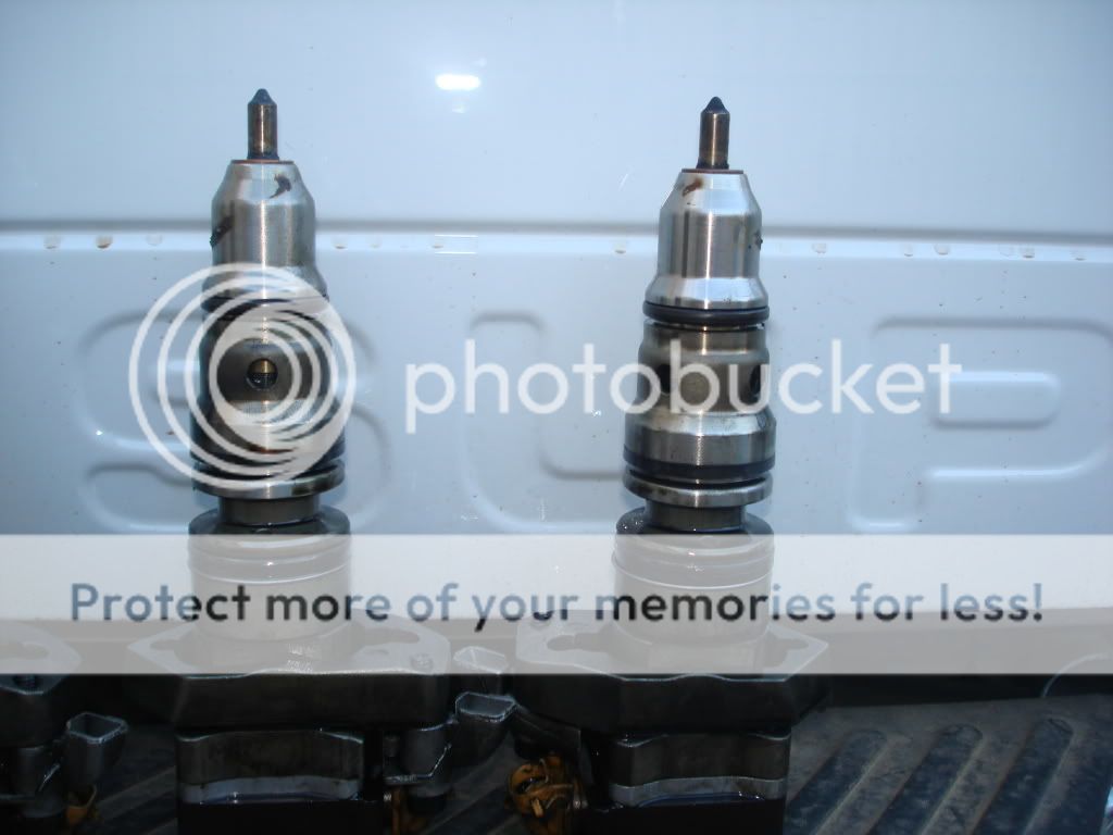

Ok guys, my powerstroke is smoking at idle, light white smoke at idle and turns into a cloud of smoke. It seems to go away at speed and returns at idle.
I removed my driver side injectors and noted all 4 injectors as AD. I also noted the middle oring to be hard and smaller than the groove?
Could it just be orings?? Maybe a leaking turbo? I push the turbo and feel no play in it, but I guess a seal could be leaking? I did not note a loss of oil from my truck.
Would a blackstone lab be helpful? If diesel in in my oil I got bad compression, correct??
Here is pictures of the injectors out of my truck:
Please help me trouble shoot it...

I see some discoloration where your injector sits in the tube, look at the brass sleeves close and make sure they aren't cracked

I don't think those are the correct o-rings in the middle section. I replaced 3 sets of injectors in my truck, and all of them were round o-rings, not square o-rings.
Buy an O-ring kit and check that out.... Thats my thoughts
After years of use the o rings form to whatever shape they're placed in. The tubes are flat walled and that's why the o rings get flat on outside edge. I would replace the orings before re installing them or I"d buy new alliants and put them in.
