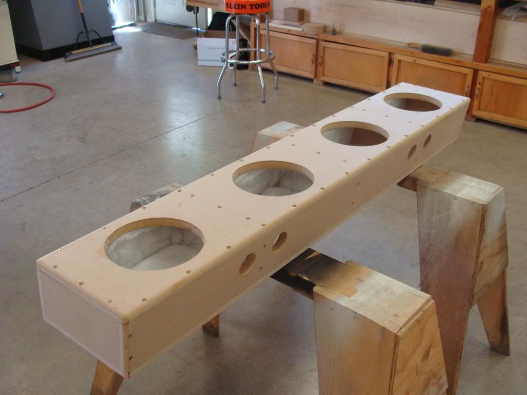

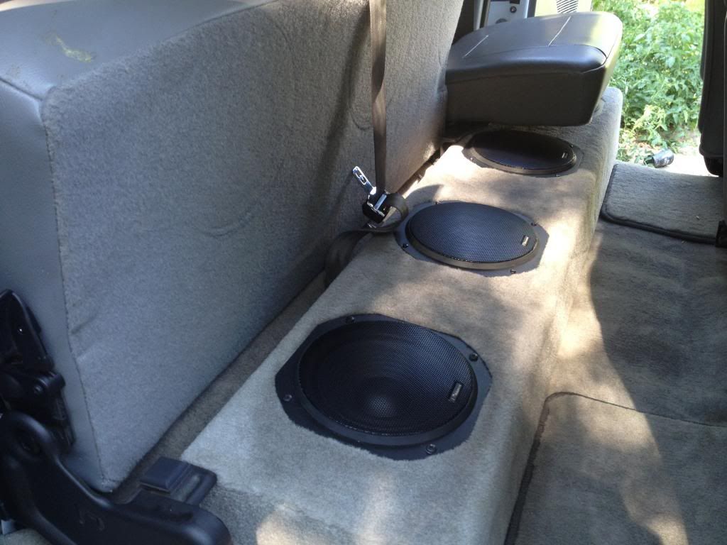

Amps can be mounted to the back wall of cab under window. I have six mounted in my SC now along with two electronic crossovers. Not sure if I have latest pics in my profile or not. May be of just five amps. Need to get on computer and update. I gave in and ran four 8" subs under rear seat. Still sounds good not deep like a 12 though.

Here are some pictures of my truck.
6 Amps and 2 Electronic Crossovers It is 12 active channels at 75 watts per channel at 4 ohms with less than 0.003 THD. 900 watts total.
It's all about the sound quality but it's also loud but not a system that flexes glass lol
The sheet metal running in front of the bottom amps is the cooling system for them. It is thermostat controlled. Can see the motor all the way to the right. Works well too being that's all behind the seat.
