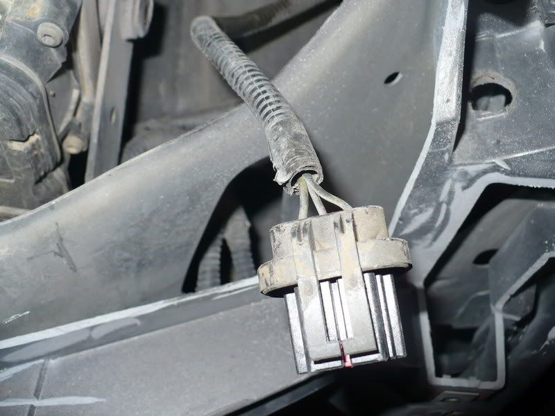

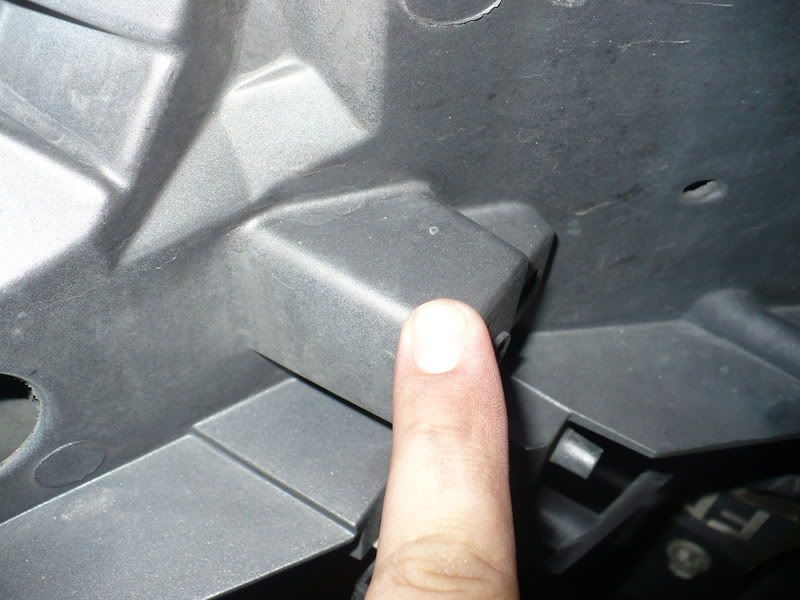

I'm gonna assume most of you know how to remove your headlights, if not shoot me a pm. After you take out your headlights and your grille, the header is pretty much exposed, Note you will also need to bail the black filler piece that wraps around the bottom of the front of your fender, you will need to take this off, and cut it, right after the two push in clips that hold it on, so that pretty much all that's left is just enough to cover the fender part, anymore than that will get in the way of the light.

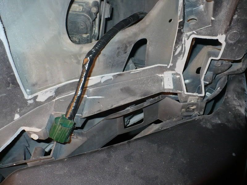

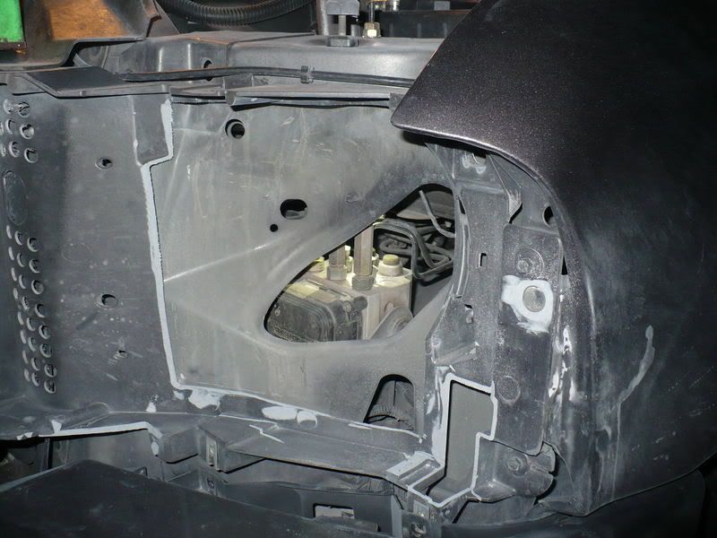

The first pic will show you what the header looks like, than the pics to follow will show you what the header needs to look like in order for the new lights to fit.
As you can see you pretty much have to cut a complete square, the whole original headlamp pocket area needs to be removed. Be patient and don't cut too much, keep fitting the light, trimming a little more, and more fitting, it's easy to get rushed and over cut.

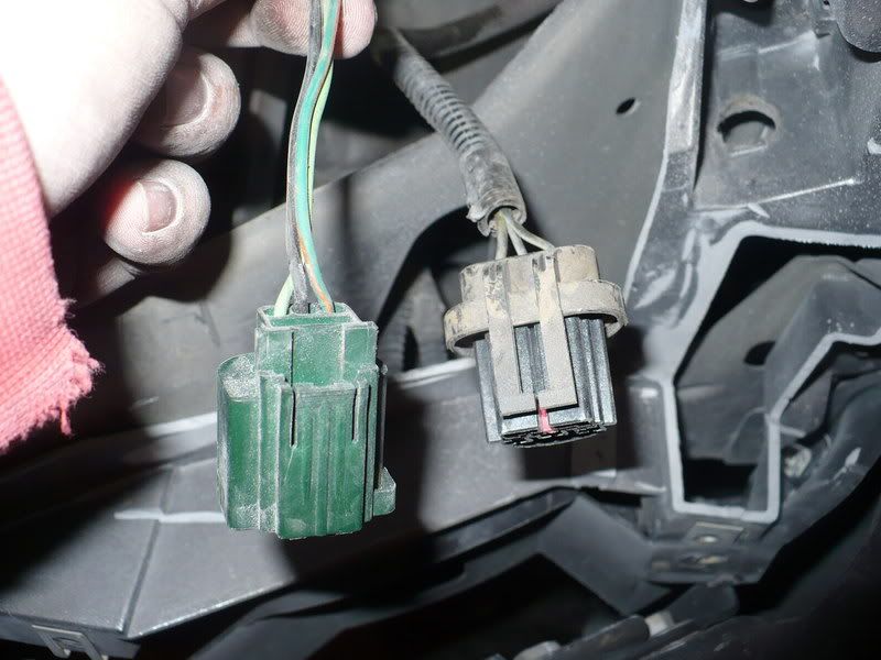

Once you get the lights fitted, you need to change over the main headlamp, socket. This is the only one you will need to change, the other 2 will work perfectly.
You need to go from the black plug, to the green plug.

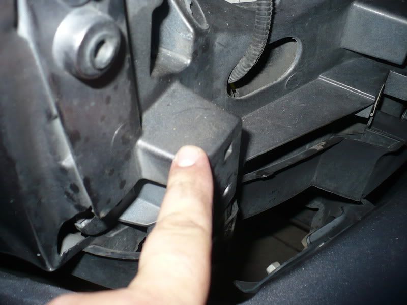

What's cool is the 04 header has holes in the top where the 05 lights will bolt up, you will see what I mean when you put the new lights up to the header.

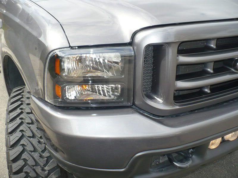

The final product of course
