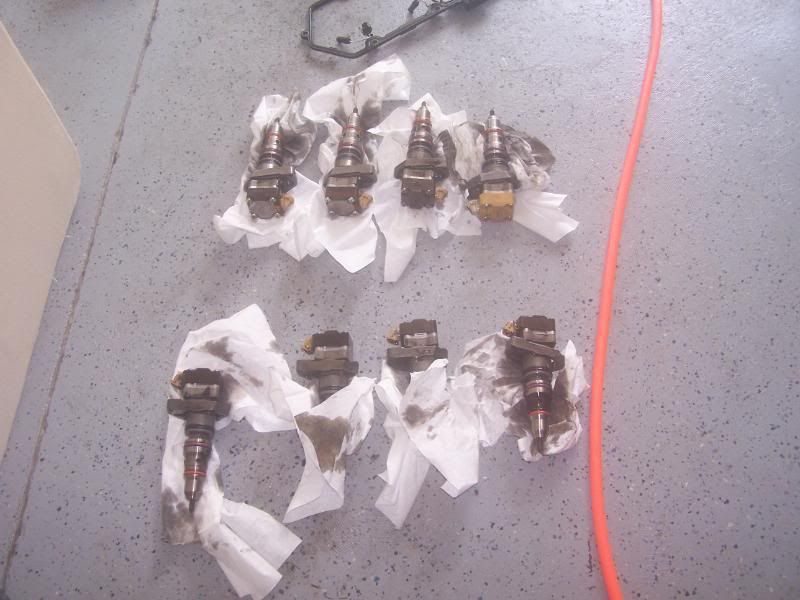

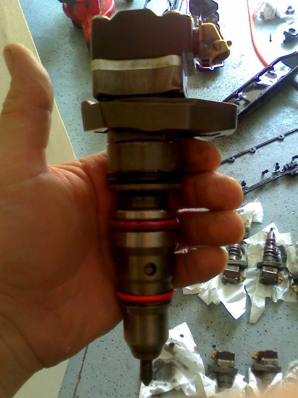

Had some fun today, and truck runs like a raped ape for just stock injectors with stage 2 nozzles! Even with canned tunes off the x3, can't wait till I get some custom tunes for this thing. Took about 5.5 hours from start to finish and man was it hot out today even in the damn shade!
out with old!

Stock spilts with stage 2 nozzles (80% flow over stock) from jim rosewoods. Great guy, very iformative and great contact the whole time. Think it was 2,1xx something but get 800 core back once mine get to him. Went ahead and went with the premium rebuilts so have a one year warranty. Couldn't be happier with the shop I went with and their product!
