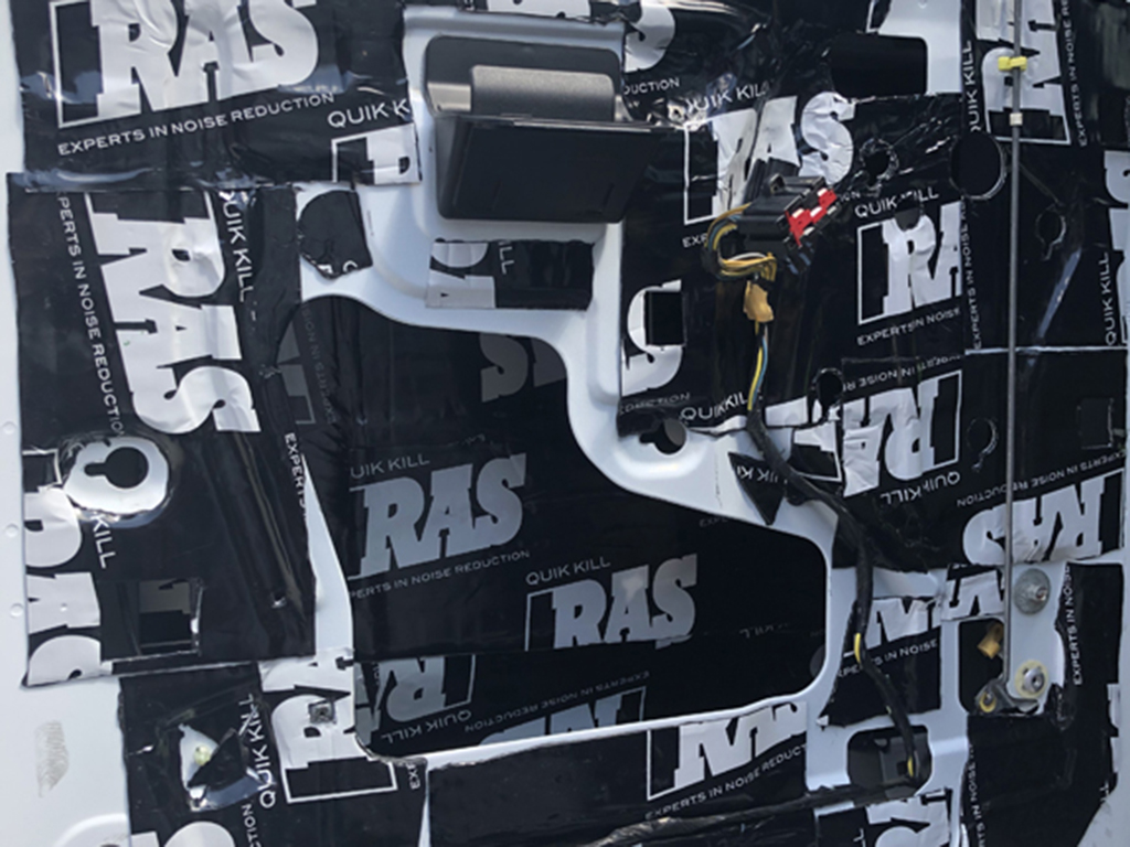

Taking some time off this week and working on the truck. Yesterday was "Rear Door Day". I started by pulling the power window regulator assemblies out and cleaning the inside surfaces of the doors (inner skin where door panel mounts, and inside of outer skin as well).
Then I changed out the power lock actuators and installed new outer door handles with Jimmy Jammers. Sorry, no pics, didn't seem interesting enough.
Then I put in my sound deadening, on both the inner door skin as well as the inside of the outer door skin.
After installing the New OE power window regulator assemblies, reinstalling the OE vapor barrier and buttoning up the door panel, I installed new (updated) OE weatherstripping on the door opening and upgraded the door strikers to the Mustang units with the rubber bumpers.
The difference in sound when you close the door is so noticeable! I will get to the front doors later this week. It will be nice to have all of the windows and locks working right again, and the sound deadening is such a nice upgrade. Eventually I will make the time to gut the rest of the interior, pull the dash and sound deaden the rest of the cab.

How did you like the sound deadener added to the doors? Did it make a big difference in the road noise, especially at highway speeds? My 08 is so freaking loud cruising at 75mph, mostly wind noise and road/tire noise. I was wanting to apply the deadener to my doors like you did. Was it necessary to do both the inner and outer door skins? Stupid question, how did you get the big sheet through the little hole to apply to the outer door skin? Did you do the floor or headliner?
Also, I can't find that RAS brand by searching. Was it an ebay international purchase? Decent compared to Dynamat? I see some options on Amazon for way less than Dynamat that are highly rated.

I have not had time to do the floor, back wall, firewall and roof yet. Those will have the biggest impact, but they require a lot more disassembly. I did the doors because I needed to do lock actuators and window motors and it made sense to do the sound deadening at the same time. Doing the doors takes out some rattles and gives the doors a much more "solid" sound, but most of the noise when driving comes through the floor and firewall.
RAS is a local brand. Pretty much any "dynamax" comparable material will do the same.

Thanks for the reply. Dang, I was hoping doing the doors would have more of an effect. Sounds like you haven't seen much improvement with road noise after doing the doors then? Maybe I should splurge for just the floors first then. Are you able to do the firewall without pulling the dash? That's something I definitely don't want to do! I can handle pulling the seats and carpet, but the dash would suck!

Door would probably be more noticeable if you did then after doing the floor and roof. There is so much road noise through the floor that it's hard to quantify what the doors do. I'm doing EVERYTHING so I'm not really passing judgement until it's all done.
Firewall will require dash removal. Not looking forward to that, but it is what it is.
Do the floor and roof first if you are looking for larger areas that are easier to do and have the most impact. The floor will be significant. I'm doing my floor with a regular "dynamat" product first (deadens resonance) and then a sound blocking material after (foam based to block additional noise). Probably do the back wall and roof the same way. Firewall will depend on what I can do that doesn't mess with everything bolting back up and fitting properly.
