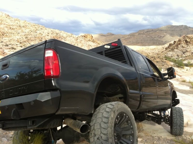

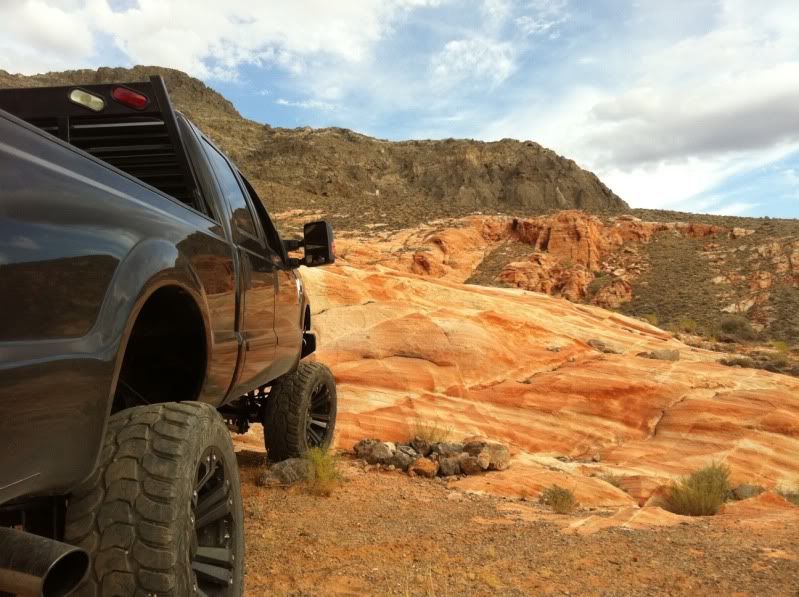

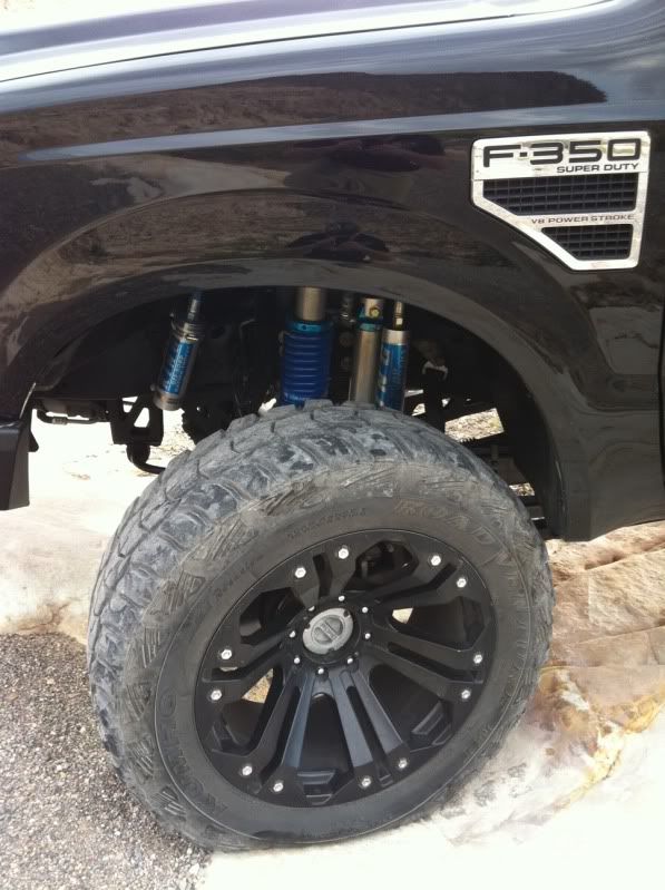

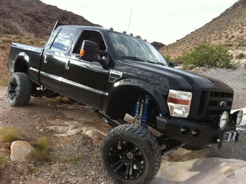

North of Vegas about 50 miles did a little wheeling through some washes, mainly rock, a published 20 mile jeep trail (not hardcore) made it 10 miles in when i damaged the tie rod, and stripped the steering gear! thank god i was able to turn around and limp her home. The steering wheel would turn to full lock either way and could only get a about 10% of normal wheel movement, a lot of 25 pt turns to get out, and then driving backroads with hazards on to get home!! was fun. The pics and video is when we had just started, its not hardcore but kinda cool. Let me know what you think. The video is in 2WD with rear locker, later in trail 4LO both lockers was required, will get more pics next time.
