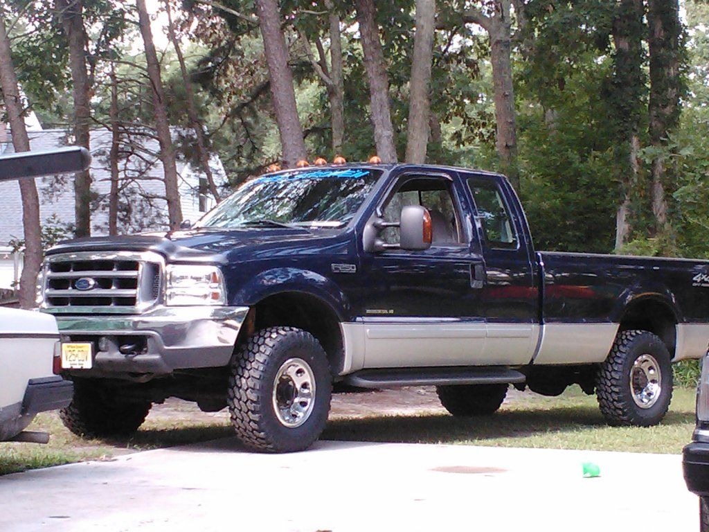

How's it going, So im fairly new to the diesel world. Would like to get some more power out of my stroke. Current set up includes the fallowing as far as i know, Stage 1 single shot injectors, fass air/fuel seperator, Aeromotive fpr, CAI, unknown upgraded secondary fuel pump, dp tuner, boost fooler, and some other stuff that im not sure of. So the questions i have are what are the next possible upgrades? What turbo is the best bolt on? Intercooler and piping upgrades? Best exhaust size, straight piped, stacks? Just here to learn and try to get some ideas and gain some knowledge. So any help is greatly appreciated! Thank ya'll some much!
Here's my truck, just figured i throw this in there.

It looks like you already have the 6637 filter from the pictures that you provided. This is a popular, cheap, do it yourself intake. I'm sure others will chime in, but it is a pretty good setup to run.

Good lookin truck:thumb:
