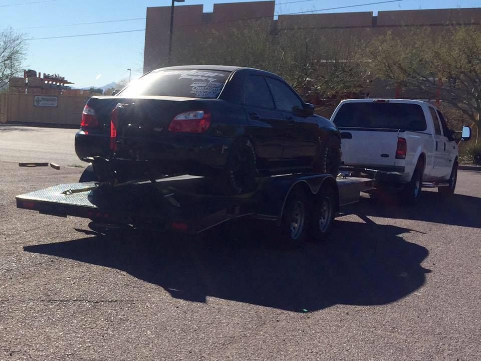

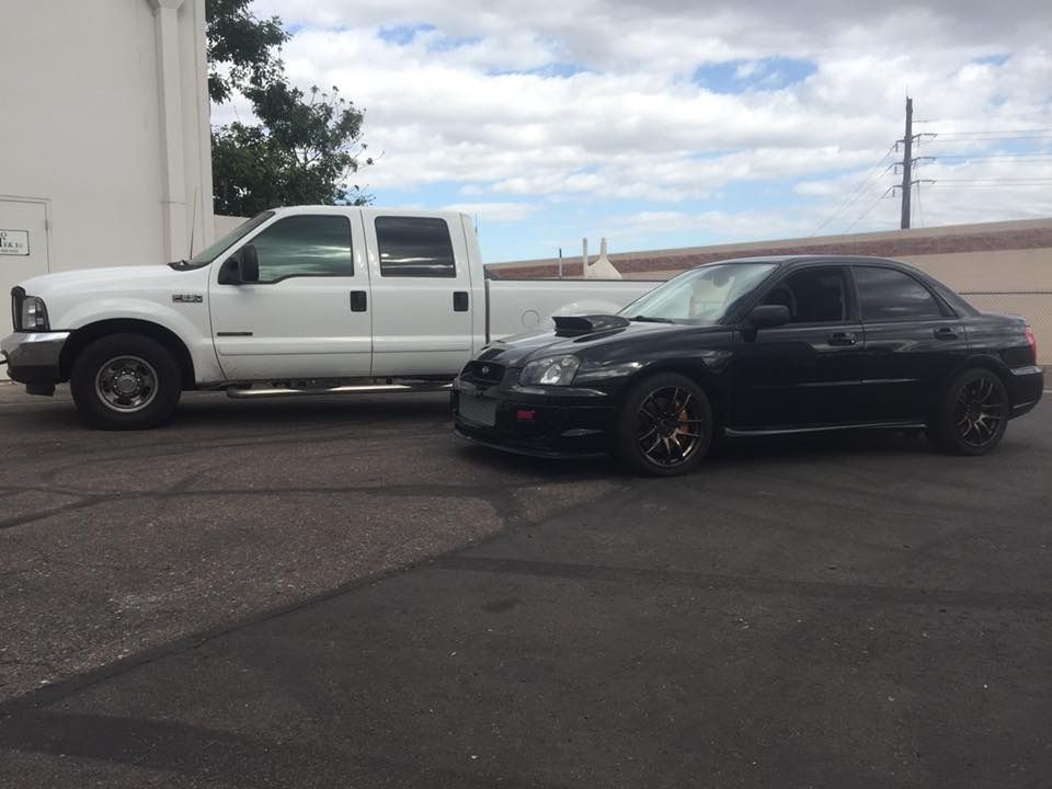

Yes, you saw correctly. I don't have any videos of it on YouTube. Actually, I only have one that's over a year old and it doesn't share any of the same parts as it did a year ago except for the header and dump tubes lol. The turbo flows 50 more lbs/m more now, it has a carbon triple disk clutch, it has 3000cc's of injector (only STi in the country/world running 8 injectors) at the factory base pressure, and runs 50-60psi of boost. It makes more torque then my diesel (I think 800wtq last time I checked but it's not tuned for its newest setup yet).
But, I'm returning the fass pump 100% and I already bought an 044 pump (the AEM version). I install their products every day and I decided to go with them and since I can have it by tomorrow. It's also diesel compatible. I'm going to see if I can return the injectors, it might be difficult because I know he ordered the set custom. I'm going to use the store credit I'll have to let him lower my truck. Saves me time and I don't have to do it lol. Now about getting the hydra. Who/where is the best place to get one?
