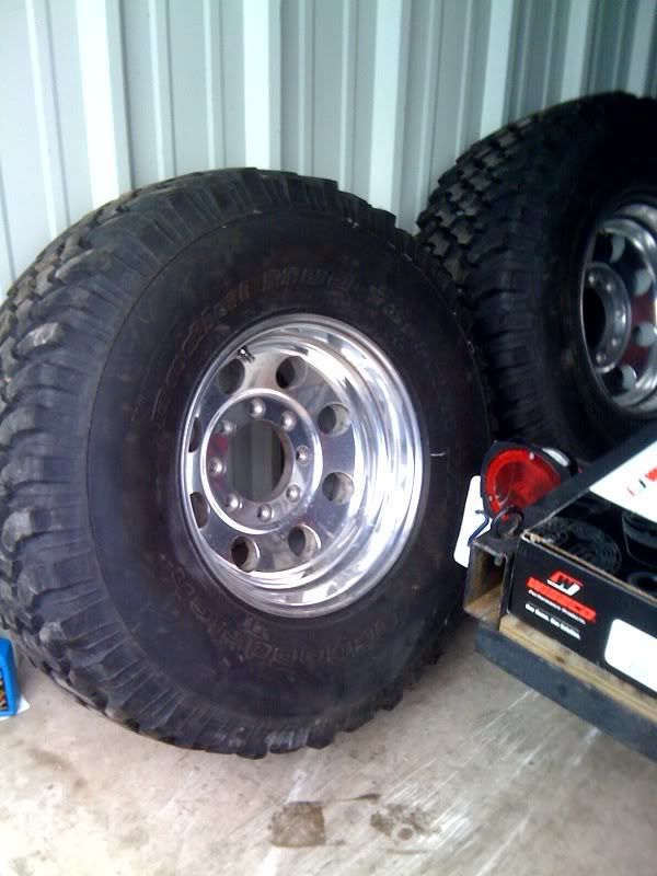

I have a set of tires and wheels for my OBS 1996 F350 4x4. They have BF Goodrich Mud Terrain T/A Tires with almost new tread, 35x12.50x16.5 size. My first question is what kind of lift will I need, if any to fit these 35" tires under my 1-ton?
Next, I like the wheels I have pictured above but I'm looking for something a little different. I am looking at this set of Motometal Wheels but I don't know if they are the correct size of if they will fit with my hubs or tire size. Anyone have any advice for me? I'm not very good at this!

My '96 came from the factory pretty tall. Taller than most ive seen running around. Not sure if yours is the same way. I can run 33's with MINOR rubbing only at full turn (compressed) I would think (on mine) a leveling kit would clear 35's If not grab a 2 1/2" lift

I have the allterrains in the same size with 8" wide wheels, all I had to do was shim the bumper out about 2" and trim the corners. so far no problems with any rubbing.
