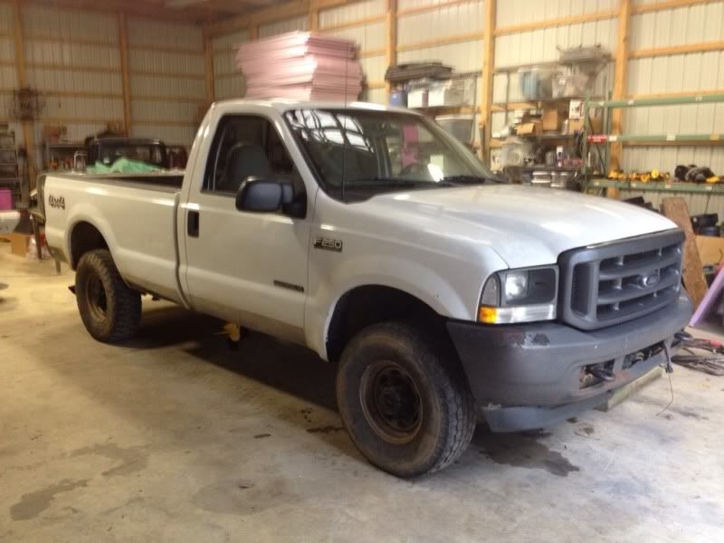

So i just bought this truck for $2800 I knew going into this that it was gonna be a project but it will be worth it. I also have a 6.0 and have gone threw the pleasures of bulletproofing. Im in no rush to fix it but i only wanna do it once.
So the previous owner said he was driving it and it lost all power and the check engine light came on. He drove it home and parked it. All he knew was there is fuel in the coolant.

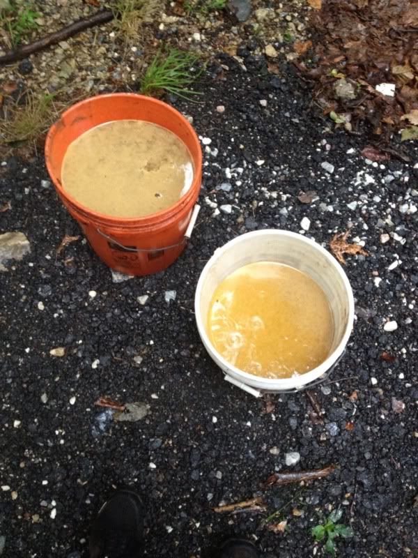

So It got dropped off at my house this morning with dead batterys ugh. I drained the coolant and it stinks of fuel

Thats a good looking truck. I like the older chevy 4X4 stickers haha.
It old my wife those were Chevy stickers , she thought I was full I crap lmao
