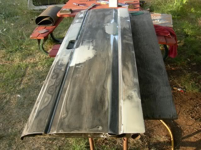

So as some of you know I aquired a 97 black tailgate from a friend. Well it was dinged and scratched up here is a before pic.
After some pondering I decided I need to learn bodywork so here is my stab at it.
Here it is blocked using 40 grit and 3m bondo

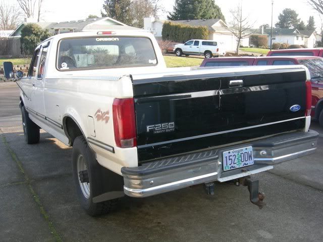

Afterwords I sanded everything smooth with 60 grit Then a coat of laquer primer

looks good so far, make sure you paint it inside thought, i painted a fender outside and there was little pieces of stuff all in the paint

So then I sanded the laquer primer with 220 grit and decided to go with a urathane primer I sprayed 4 coats then wet sanded with 400 grit then sprayed two more coats wet sanded again and with the tailgate wet this is my result
So how did I do.

Looks good, are you going to put the aluminum trim on it? Or are you going to leave it white? Either way will look good

I am actualy ditching my diamond plate bed rails and tailgate trim for a ribbed Abs like the 99 and newer supderdutys

looks real good!
