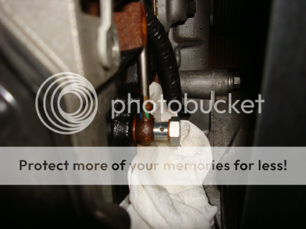

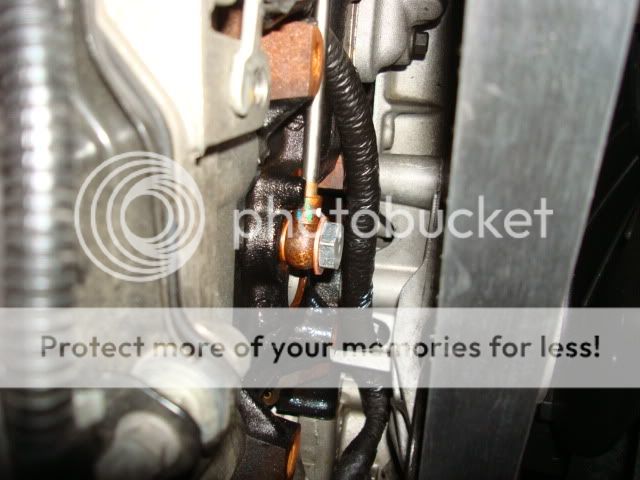

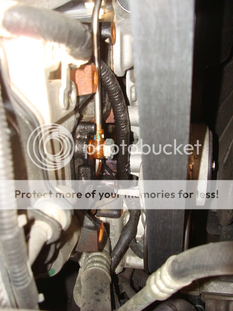

I got the passenger done but the the driver is trying to hide from me so when I do a coolant flush and filter kit I will get to it then.
simple.

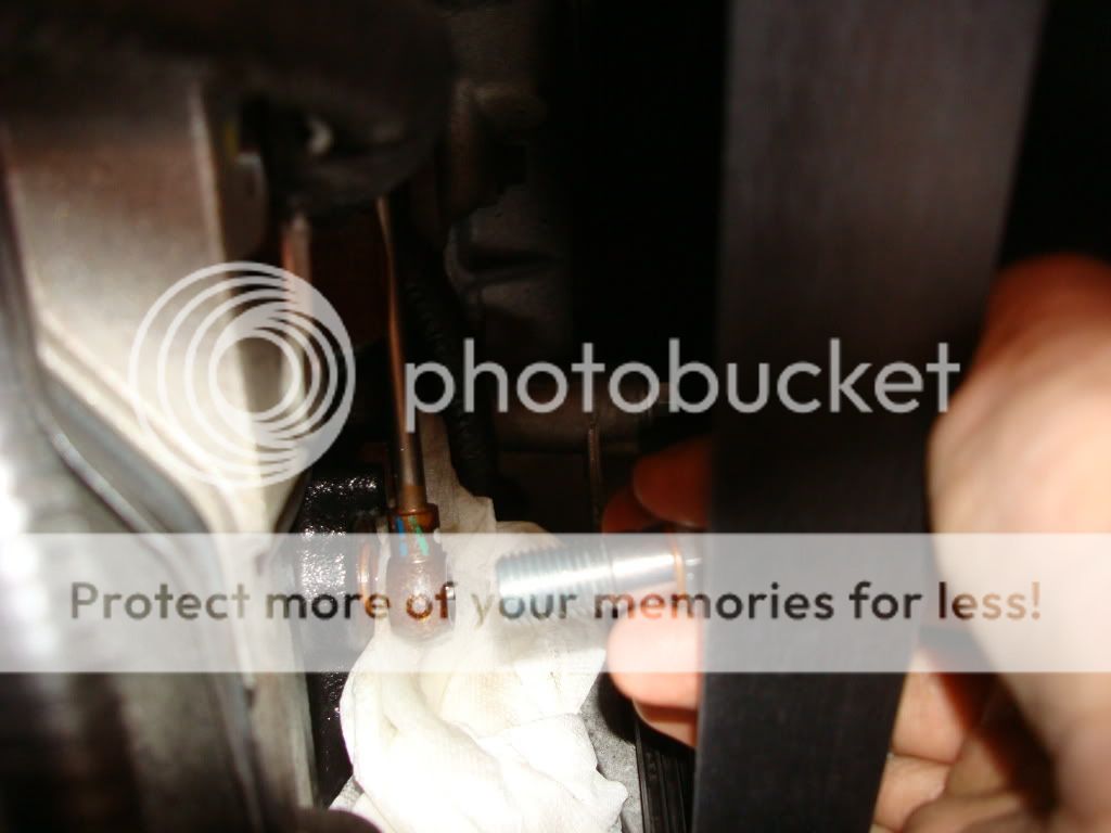

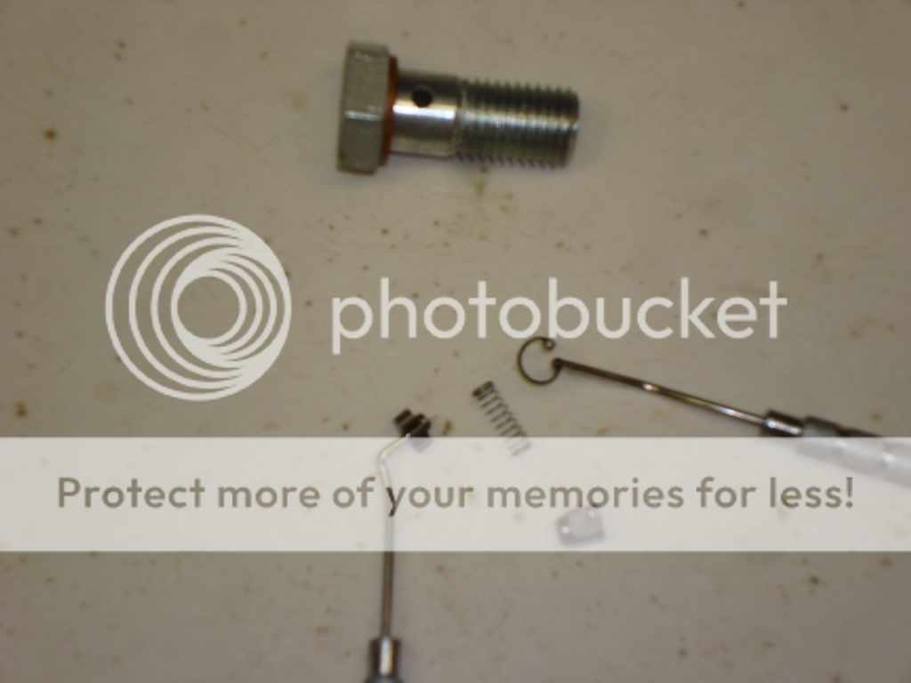

I took the bolt(17mm) out made the holes bigger for more flow. Put it back on and for got and lost washer. Took bolt back off, went to ace got washer and put the bolt back on. All done and better than new.
When I drilled out the bolt I had to keep in mind alignment and High fuel pressure. I forget what size I drilled but its bigger. I did not drill out the anti flow back valve.
That is the hole I drilled out^^^^^^^^^^^^^^^^^^^
I used 2-stroke oil to lube the bolt and the components.^^^^^^^^^
all done!!!!!
I used brake cleaner to clean the bolt. Pipe cleaners to clean the hole. I made sure there were no burrs or any metal shavings at all.
I took a really long time cleaning and cleaning and cleaning on one simple bolt. But you have too!!! if you love your injectors, and I guess you wallet too. I even checked and cleaned vigorously the perpendicular intersecting of the fuel flow on the bolt. The flow is like a T.

did you put the check valve back in there? i just notice that you only drilled out the side hole?!

the 700 dollar RR kit isnt just drilling out the stock banjo
imo it isnt a dyno proven mod but i guess if you are bored why not
however the OP seemed to only drill out the sides and put the check valve back in. thats a waste, the sides are only as good if you do the center as well

Why do you take out the check balls?
3,720 Posts
the retainting clip is too small after drilling the holes for them to hold the valves in, and they are restrictive if you will
20,738 Posts
they wont fit after your drill out the holes, the retainting clip doesnt hold them in. and they are restrictive if you will
Makes since. This mod sounds legit but it is not something I would try with out proven benefits!
545 Posts
the only problem i see with drilling out the center and doing away with the check balls is when the truck is shut off the fuel will flow back out of the fuel galleys in turn causing hard starting due to the air/void in the system. im dont really know if this is true on a 6.0 frankly because i dont work on them on a daily basis, but i do work on cummins engines for a living and know for a fact that doing so would cause terrible starting issues. again im not saying you cant do it and it wont work, just something to take into consideration.
3,720 Posts
thats a very good point, it will flow back but not enough to cause a hard start the next time you turn the truck on.
if you look at the aftermaket kits they all have bigger banjo bolts without check valves.
im not arguing that it wont hurt and maybe it can help (peace of mind) but without drilling out the center the flow isnt much greater then stock.
4,341 Posts
Discussion Starter #19
Yes that is y I kept the check ball
