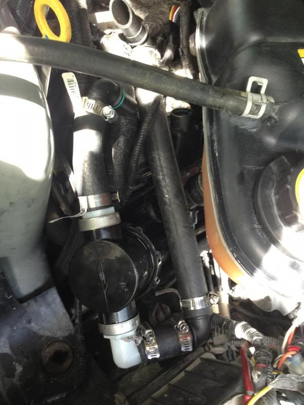

My CCV mod complete. Had it vented into atmosphere last 20k and I developed a wet bellhousing. Wanted to go back to closed system to see if that clears it up. Didn't want to use long lengths of hose which might cause restriction. In total I used about 20 inches of hose. Used a 1" in line strainer from TSC for the catch can. The first pic shows the system, the second pic shows it hooked up. I do have to remove air filter to access the catch can but figure I can empty it every time I do the air filter.

I have the exact same set up. I got the strainer from Princess Auto for about $12. Its been in there for 2 years and works great. Once a year there is about 3/4 of a plastic pop bottle cap of oil in there, so not much.

Jetjock, did this clean up your bell housing? Boot & intake still clean and no oil?

No and no. No noticeable differance on bellhousing, still damp. Last time I had intake off there was oil getting sucked in turbo through catch can. Not as much but some getting thru, I will probably vent it back to atmosphere in the future.
