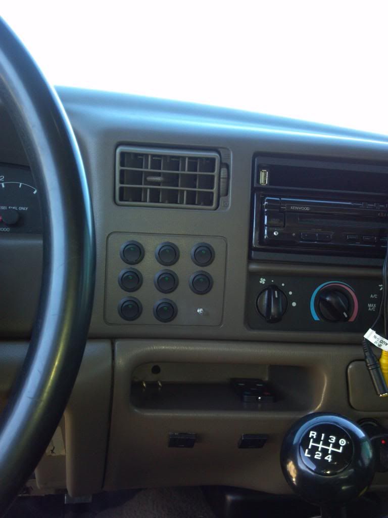

Well my truck being a 99-04 style interior, upfitters arent exactly in the cards so i decided i wanted to add some switches but then i realized that boy it will be a pain in the arse to have to take the dash off everytime i want to add something to the dash. And i cant stand the look of the guys that have switches every which where on the dash so i decided to preinstall and prewire switches for the clean look that i prefer.
I ran the wires down to the fuse box area and labeled them all so i can remember what wires go to which so all i have to do is splice the new accessory in and im in business. Overall i like them so far. Figured id throw them up there maybe spark some ideas.
Im still trying to figure out an easy way of labeling them in a clean way. Oh yea the led is a glow plug indicator light because of the placement behind the dash wouldnt have allowed another switch.

Nice :thumb:
I'm sure now that they are there you are already trying to figure out what you can hook up to them :rofl:
are they green led ?
I bought 5 green led ones that look exactly like that and plan on doing something similar, not sure where I'm mounting mine

Yea i have tons of crap on my truck that is wired every which way that i spent part of this weekend rewiring now that its hinesight its easier to wire things better. Yea they are green ones, i wish they were amber because my next project is converting all my green interior lights to amber but oh well. Idk if you have ESOF 4x4 or not but you could mount it where i did.

The switches.
clean install, Ramm. I used trailer wiring to route my gauges/switches. Colored wires specific. My wvo gauge is where your switches are, so i got the crappy, switches everywehre look...and here's how i fixed my shifter. Welded a new round stock to existing shifter coupling, ground down the welds, and welded a nut at top, inside the stock...
I went through and rewired every accessory in my truck when i did this and i cleaned everything up real good. Im just too damn OCD to have a spider web of wires everywhere and switches everywhere. Not knocking guys that do, if it works for you more power:thumb:
But yea i saw somewhere where you posted your shifter knob, looks good bud:thumb: i have no problem with my knob, i catch my self fiddling with it at stop lights and what not so i keeps me busy:hehe:

Yea thats where i actually got the idea, i asked where you got it in the blue interior thread but you never responded so i just did this. I made a quick 8 fuse block out of some quick disconnects and a silicone mold and im going to use it in conjunction with the switches as well.

Dumb question but does that square piece just pop out?
No unfortunately it doesnt unless you have ESOF 4x4 but then you kinda cant do this
