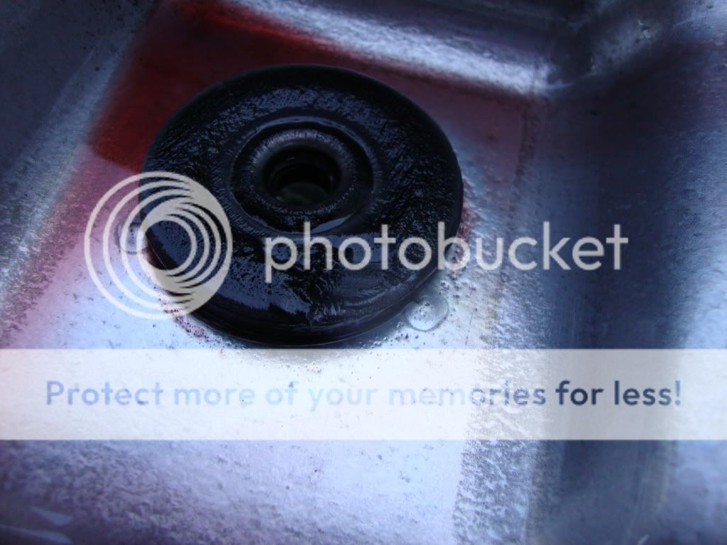

you can use a 13mm socket but I chose to use 1/2" socket because it had a tighter fit on the pan drain bolt

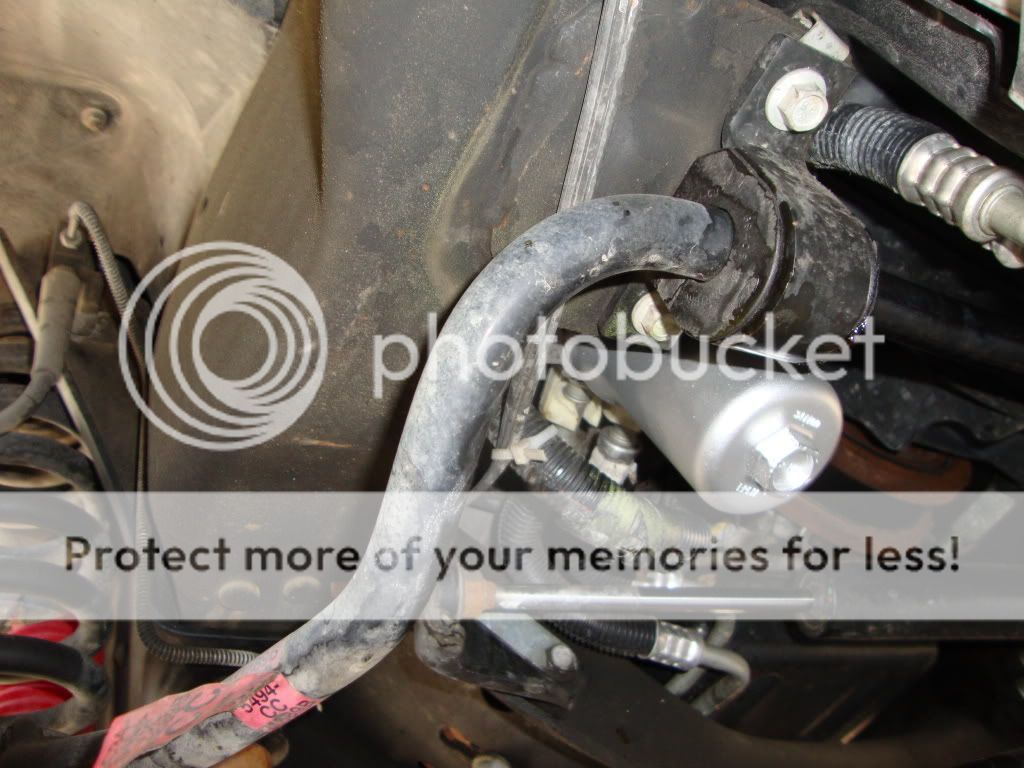

The first thing after I removed the external filter, pan, internal filter, and let it sit for 20 min. Then I started the truck and let it sit running for 5-10 seconds. Allot more fluid came out.
Then I did this below.

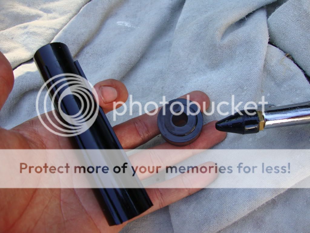

After I took off the pan and removed the filter, I cut the filter tube off. I used this along with a grommet and the air hose. I put it back into the valve body and push out more fluid. I got ~1 quart out doing this.
Then...
With the external filter off I use air pressure to push fluid out of the cooler (allot). And fluid came out of the rectangle opening on the side. Fluid also came out of the valve body area. This and letting the truck run for 10 seconds really got the extra fluid out.

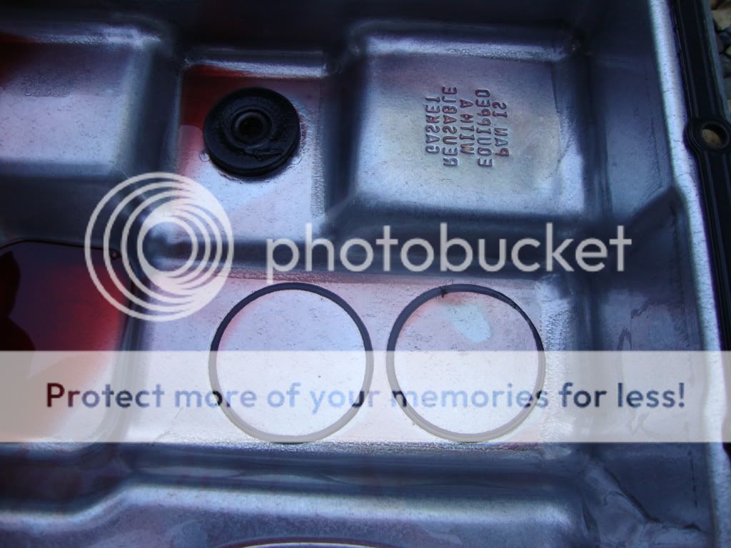

Before I change the fluid, I had two 50 LB magnets on the pan for ~15,000 miles.
Looks like they worked :nod:
Magnet around the bolt.
Now After I cleaned the pan I removed the stock magnet and used the larger one from an extra 50 LB magnet.
This is just to compare the size. I did not leave the stock(smaller) magnet there. The stock was not used.

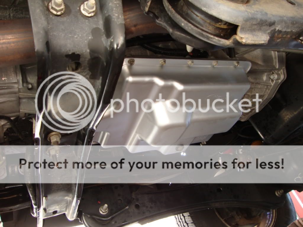

I also painted the pan and external filter housing :)
