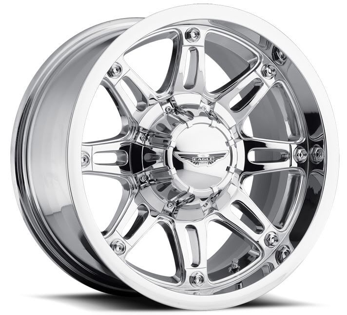

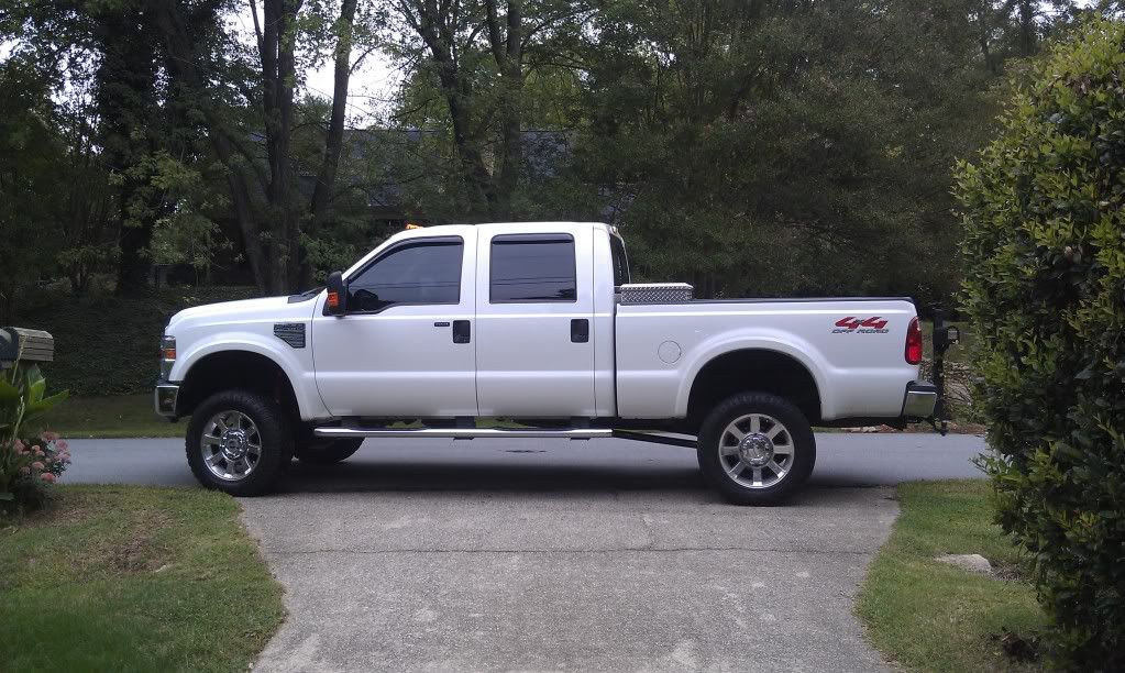

I want to get a 325/60/20 tire regardless
Truck in question...
Wheel and tire I really want...
All thoughts and opinions welcome (as long as I like them :laugh:)

what do you think I could get for my stock rims with some duratracs that are about done on them

Bigger, wider tires with the correct offset rims will set your truck off. I like the stance so far though.

The wheels I want are 20x9 with 0mm offset. How far will those stick out? I don't want them to stick out too far.
717 Posts
^^ that would work great , I had a set of 20x9 +20? offset with 325/60/20's and they still were just past fender and i added the small flares and it still was just sticking out a hair ,if your not wanting them to stick out ,i wouldnt go more then the 0 offset , if you get into the 20x10 they are most likely going to be out to far for your taste, just my .02$

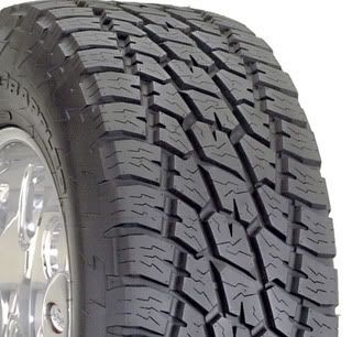

1,060 Posts
Thats the perfect size and off set wheel for 05-12 trucks! Sticks out just a tad and you can fit 37" if you wanted. I would look at different tires as those nittos are on the soft side and wont last to long. you should really look for a load range E tire as these trucks are heavy and eat up load range D tires or at least it's been that way for me.:beer:

I have never gotten any more t.han 30,000 miles out of a set of tires on this truck. my neighbor put these on his F 250 and he has got pretty decent mileage out of them that's why I thought I would try them. do you have any recommendations
