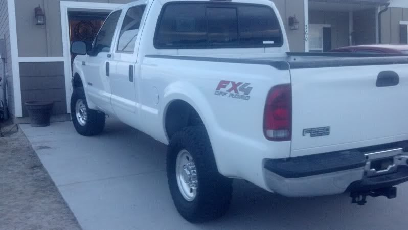

well im starting to have those dreaded 6.ohno problems. Right now I have an oil cooler that needs to go in and just ordered an EGR delete (ebay no name) and a coolant filter setup from PMM from TB on ebay. im gone for the next week so this isn't going to happen soon. but figured i'd get started with thread.
if those don't solve my issues then im down to HG and will do studs and some other work. truck is driveable but getting the white smoke and loosing coolant.
pic right after i bought it
other when i got home
and work setup
any ideas and help would be greatly appreciated.
especially on fun cool little mods.
