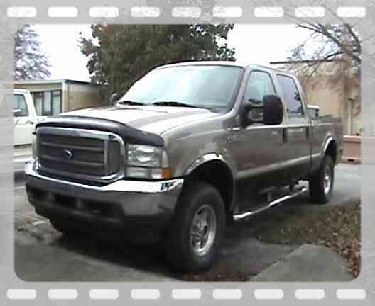

So my winter time lope is back, guess its time to trouble shoot the glow plug system. All is well if I leave it plugged ing for a couple hours. Or could something else be wrong:dunno: Check out the vid.
Was 48* truck parked about 15 hours.

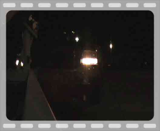

Was 35* truck parked about 15 hours.

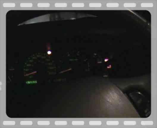

Was 40* truck parked about 8 hours.
