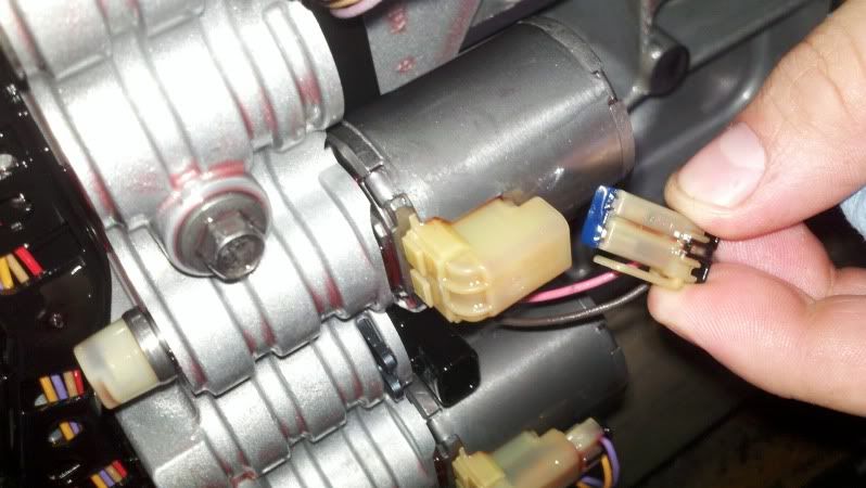

First drain fluid and then remove pan. Remove tranny filter and make sure to get the oring that is on the end of it out as well.
This is what you should see: The direct solenoid is on the middle right in the picture or rear center as on the truck.
You have to pull the small e-clip off the one end of the solenoid with a small screwdriver or needlenose.
Then squeze the clips on the electrical connector portion to complete removing the solenoid.
Gogo left stock right
GoGo
Stock
Install the solenoid in reverse order as above and it should like it did before.
