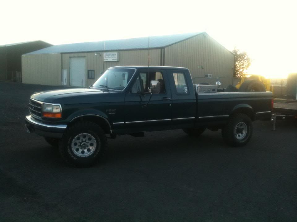

Well last summer I blew out both my front axle shafts while attempting a 4x4 boost launch lol at about 15-20lbs of boost they went, so I went on the hunt for a 60 and found a hp kp 60 with matching gears (4:10s) and it kinda sat around for about 5 months till i came across some 6in springs and everything pretty much to do it. Here's my truck stock with 35s.
