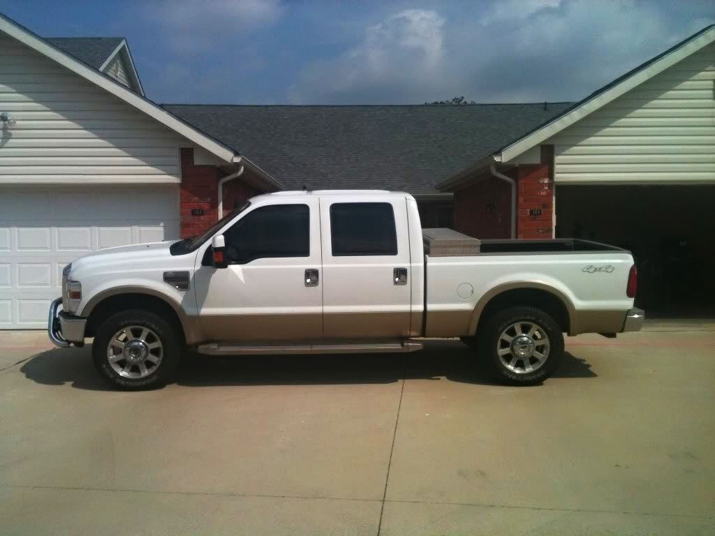

So here is my truck the day I brought her home

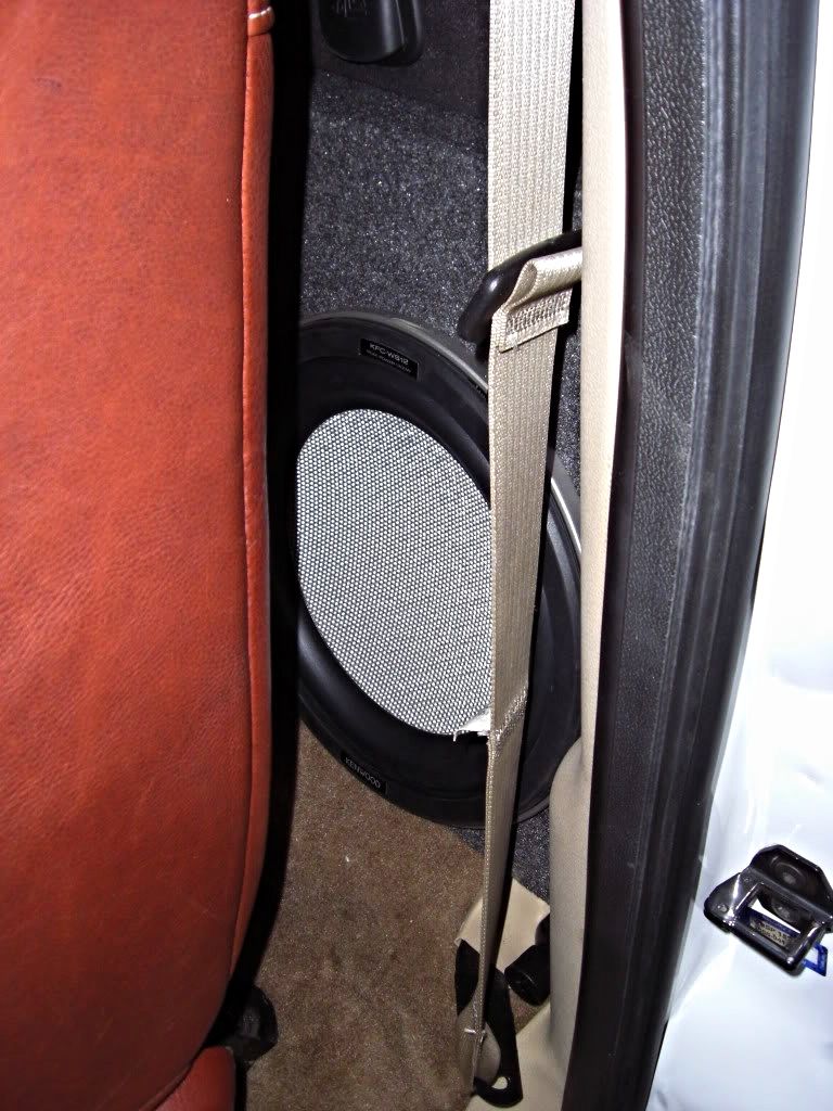

Put in an amp and a sub

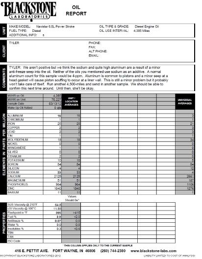

Got my blackstone report in today. (They labeled it incorrectly as a 6.0, but I have emailed them to correct his). Keep in mind this was on dino from the dealership and I had only deleted the DPF/DOC in late January. The EGRs didn't get deleted until late February. Any ideas why my sodium and aluminum levels are high? And should I be concerned?
See less See more
Well it sounds like coolant is getting into your oil which could mean a cavitated front cover. They also seem to think you may have a head gasket problem.
So what causes the front cover cavitation? How do I fix it? And how concerned should I be? As far as HG problem, I guess I should think about head studs sooner than I was planning. Maybe I'll back down the tune to the low 200s and see of I can post pone that til I can better afford it. Other than just tearing apart my truck, how can I tell if I have a HG issue?
DTS Articles - Cavitation Erosion
The above article is about cavitiation. If you dont have the money now for head gaskets and studs i would back the tune way down and drive conservatively. The best way to test the head gaskets is pressure test the cooling system. Or you could buy a block check. For cavitiation, if thats the problem, you are going to have to get the front cover replaced. Then i would flush the system and go with a cat rated ELC coolant.
Did some googling, looks like the front cover cavitation is a common issue and there seems to be an old design and a new design (with an extra tab). Does anyone know what the TSB that replaced the cover was? I'm gonna go by the dealership tonight and talk with them. Hopefully I won't have to fight them on a possible warranty issue since I am deleted with no EGR (since this seems to be a common issue and is completely unrelated).
I dont know anything about the TSB but i would recommend a flush and fill with a CAT ELC. Proper coolant system maintenance is the key to avoiding cavitation.
I check my nitrates every month or so and the coolant always seems fine, only reason I ask about the TSB is that I found that the front cover is a common problem and there are 2 types of covers. The old one that seems to cavitate and a new design with a tab that is suppose to eliminate the cavitating.
Sorry bro i dont know the tsb number. I do know there is a revised front cover that is supposed to help with cavitation.
well went by the dealership and there are no TSBs, but my service manager said that it should be covered under engine warranty. He said he would need a few days with the truck to actually diagnose it (as he needs to actually take the cover off to tell if it is cavitating).
