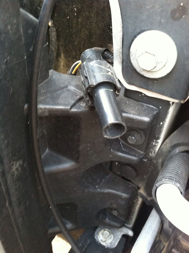

I noticed this Deer whistle looking thing behind my grill when I bought the trick a few months ago. Couldnt figure it out I disconnected it and doesn't have electrical connections on one side of it. Here's what it looks like. If anyone knows what it is please let me know.

Outside air temp sensor

Mine has that too but I dont have a temp display anywhere. I didnt think any superduty had temp display. I always thought it was the optic "thing" that allowed the automatic headlights to come on when it gets dark

The light sensor is on ur dash in the middle close to the windshield. Mine displays temp on the digital ac control unit

is it the plug for the factory fog lights wiring?

MTS678, where on an xlt with out a digital a/c control show the temp for outside, because I dont think I have one on mine.
Travis, It doesnt appear to be the fog lamp harness because i cant find the match on the other side. I have a Warn front end and Im not sure if the truck had stock fog lamps and werent installed on the new bumper, wouldnt the harness for the lamps be closer to the bottom?

App doesn't show signatures. I have a lariat, your truck may be provisioned to read outside temp but you just don't have the digital ac unit. But that's what that deal is, outside temp sensor

Just to let you know, for the fog lights, the two fog lights are connected all on the one wiring harness running to the singular connector on the driver side next to the intercooler.
