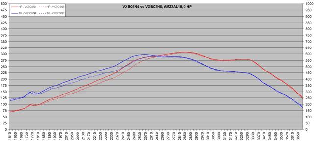

I get this discussion frequently, and here are the facts. As long as there are no mechanical or electrical concerns, running the VXCF4 based strategy make better power than running the VXCF9 strategy with the same tuning. This means that as long as there isn't an issue with the EBP sensor not reading correctly or some other similar issue, the earlier strategies run better and produce more power. This dyno plot clearly indicates this:
(click on image to enlarge)
This was tested on Mike Friihauf's (Iron Pig) truck last fall using Matt's SLR+ tune and the files were tuned IDENTICALLY, value for value. We see these same results pretty consistently across all model years. Here's a dyno sheet from my 6.0L with a stock VXBC9 vs VXBC6 strategies:
