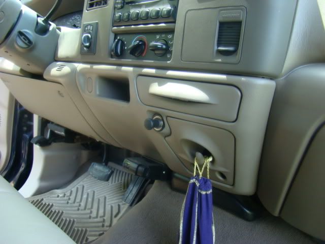

Has anyone removed this panel? If so, how hard is it to remove? I sold my 6 Gun to someone and I am going to swap these panels if they are the same color so I don't have a hole in it where the PDA was mounted.

it should swap no problem, it just pulls off making a bunch of loud unclipping sounds. Besides the color difference it should work just fine. Just take your time and you should get it off no problem. Be sure not to pull if off too far before disconnecting some of your dash mounted switches like your lights and 4wd selector

so i missed some comments in your original post... remove the two screws under your CR bag and the panel under the steering wheel to make sure there are no screws holding it on. Remove the cup holder and you should be good to go!
