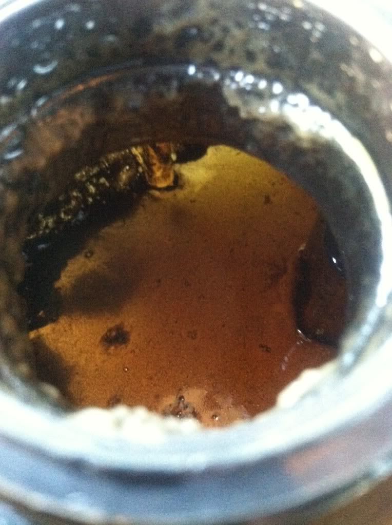

Looky what I found today!:D
And holy s*** does it need it
Ive read as many write-ups as my eyes can bear, anybody have any "hot tips" or general advice on flushing :dunno:, looking into have a local guy do it since he is great with these beasts and only wanting to charge $55

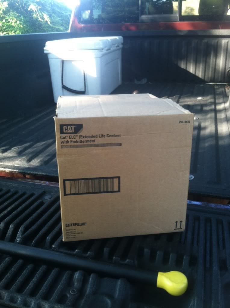

You better make sure that cat coolant is Fully Formulated and not 50/50 premix or ready to use coolant.
Just went and checked and i'll be damned, premix :tard: ... guess i'll go pick up 3 more gallons tomorrow
Just take it back and goto napa and pick up a case of zerex ec-1 rated elc coolant fully formulated part number is ZXED-1 at napa you can usually pick it up for around $15/gal. Don't put premix in your cooling system after you flush regardless of how much of it you buy you won't get the ratio right because the cooling system retains about 3.5 - 4 gallons of water after you drain everything. You need concentrate for a flush and refill then you can use 50/50 premix to top off a low system.
I'll do it, thanks for all the help :noteworthy:

11,966 Posts
Did any of you look at the pic of his degass bottle? It surely does look like oil residue in there and floating in the coolant. Based on that I'm going to say his oil cooler is already ruptured most likely. You are looking at a whole lot more to fix that than a coolant flush. What's your oil look like, and what is your EOT/ECT temp delta?

As for that crap in the degas bottle, a while ago I put tap water in the degas bottle because I was a little low and I think that may be algae:doh:
Im gonna go ahead and hook up a coolant filter, run it for a few weeks, then try to flush and hope for the best
