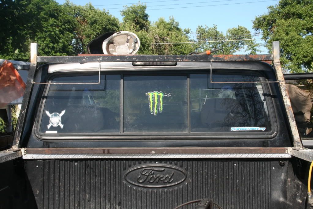

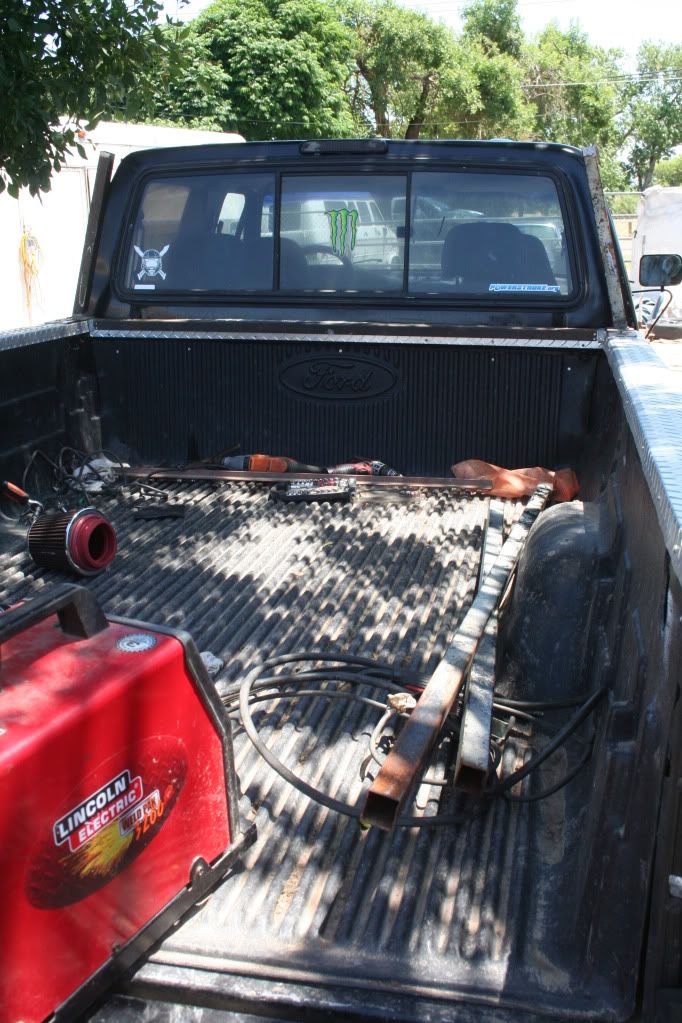

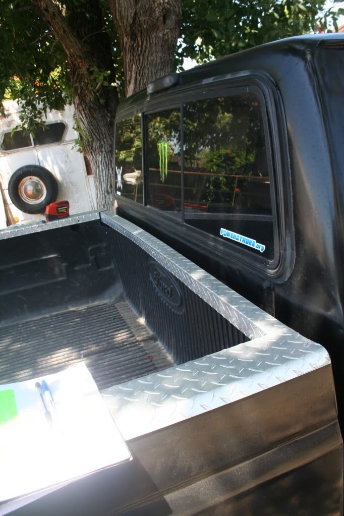

So I built my Headache rack. (first time)
Tools used:
Sawzaw
Drill
Cordless drill
Grinder
Lincoln Welder
level
pen/paper
Measuring tape
ratchet kit
Gloves and eye Protection
Supplies:
1/4" Steel for Bottom mounting plates.
1 1/2 Box tubing.
1/8" steel for Light hanger.
2/8? Angle iron for Front bed rail support.
Grade *8 Bolts, nuts and washers.
Black spray paint.
All cost me nothing lol :D
__________________________________________________________

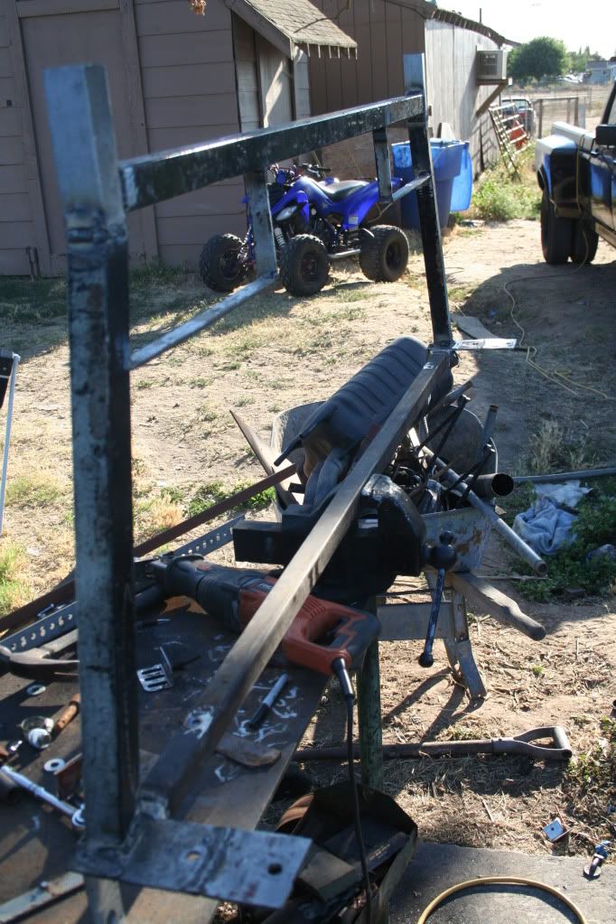

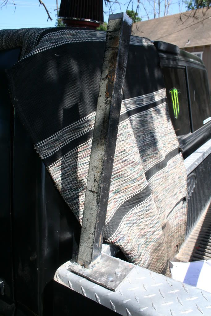

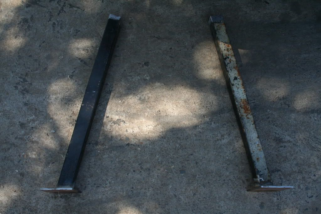

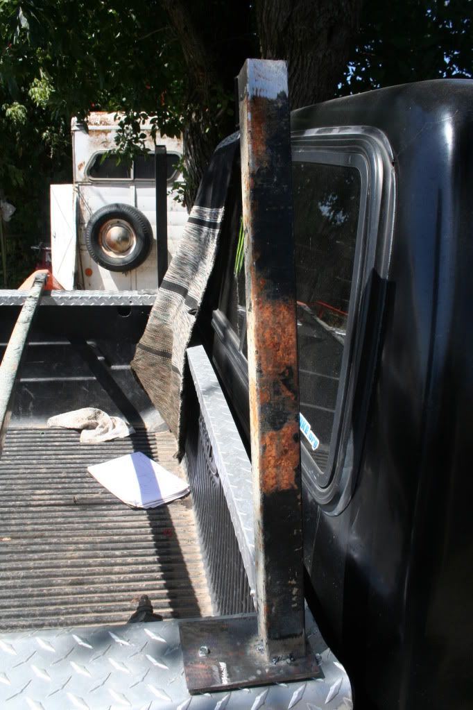

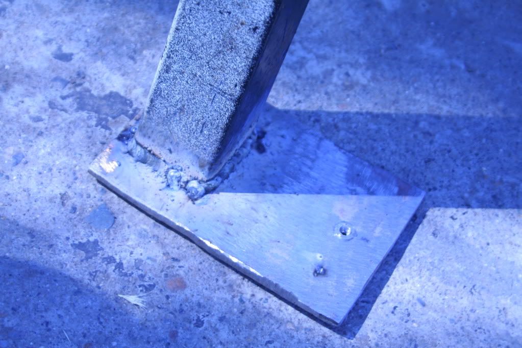

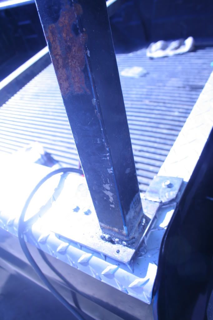

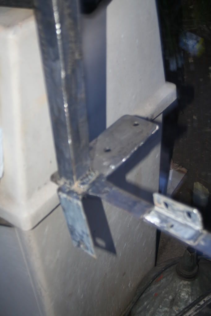

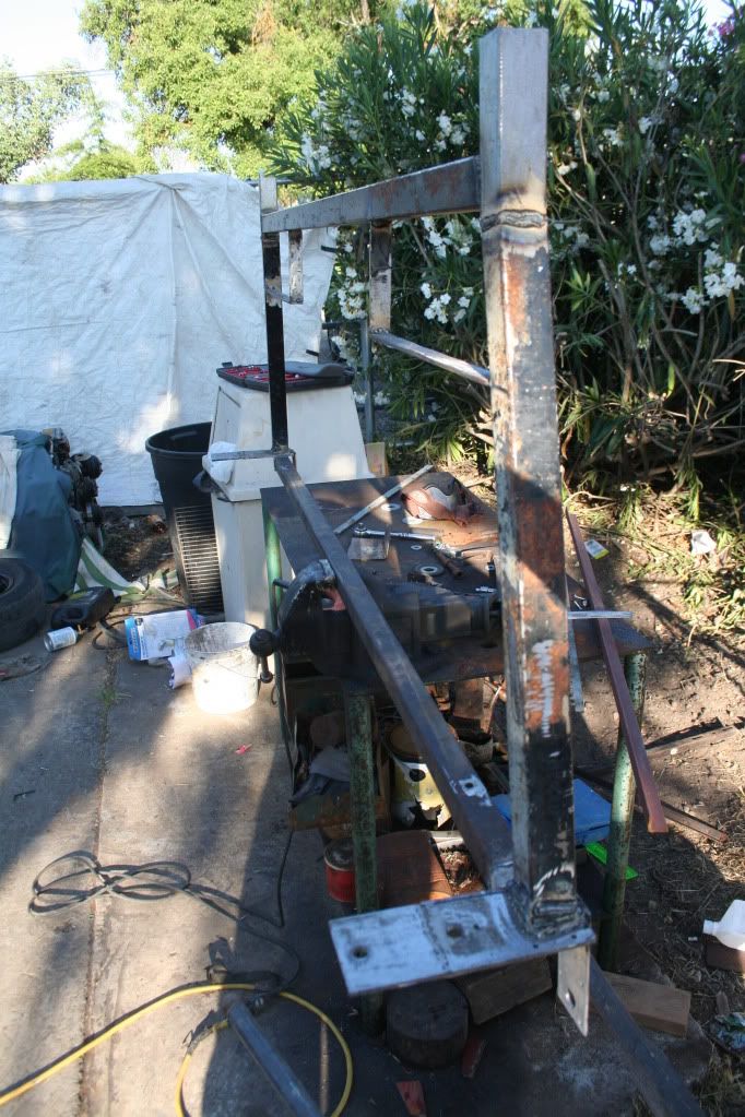

I made my first Mounting design but didnt work to well so i had to modify and add to the plate.
Pictures are from beggining to close to end:
I dont have a SHop so i do my work outside.
Viking Heavy Diesel

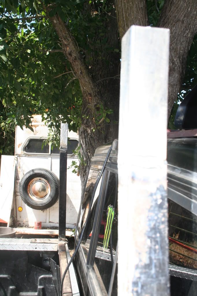

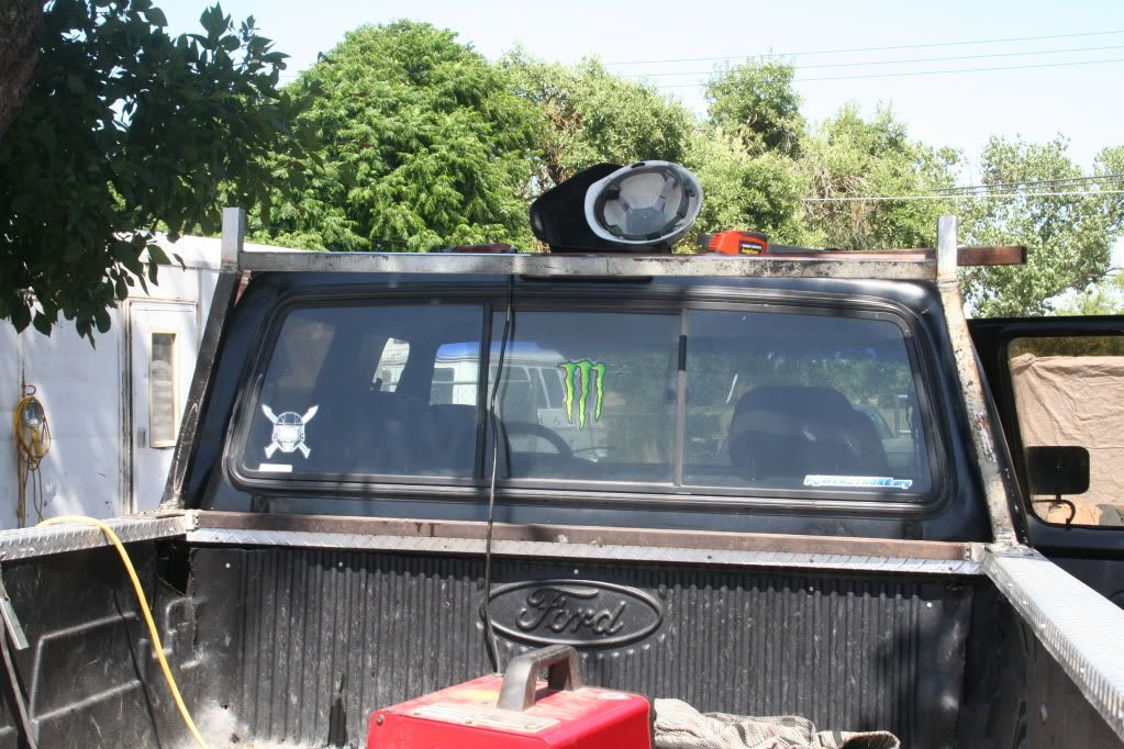

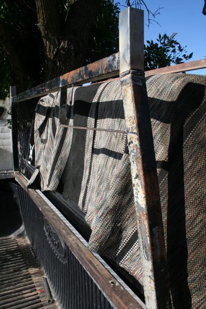

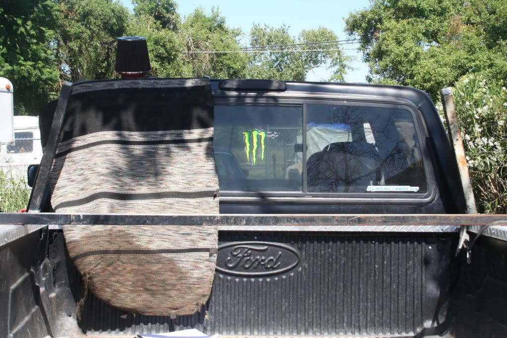

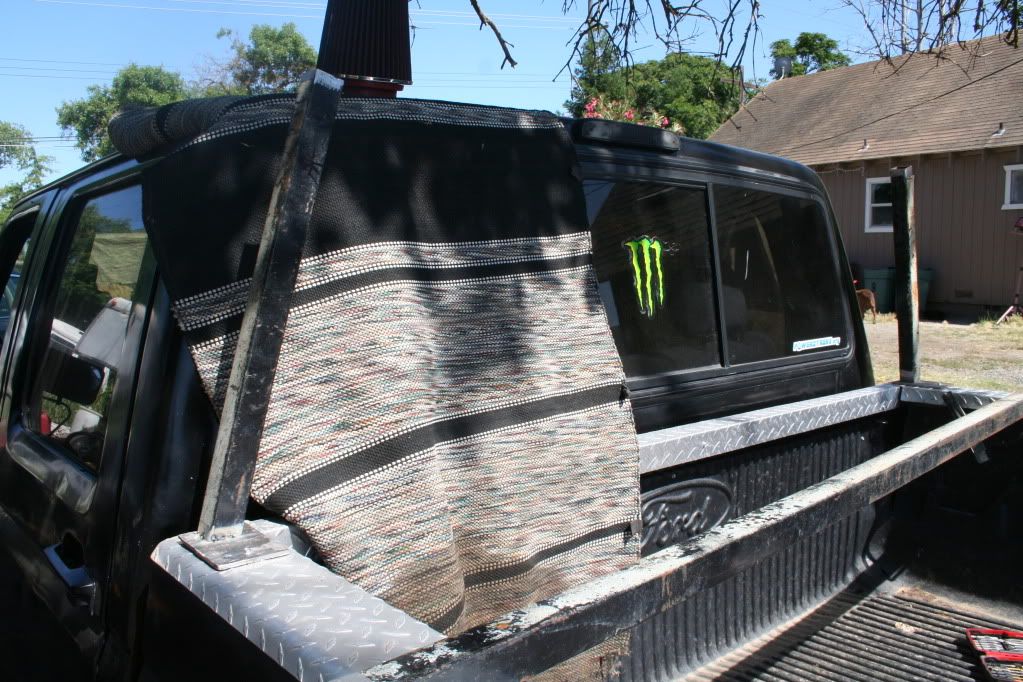

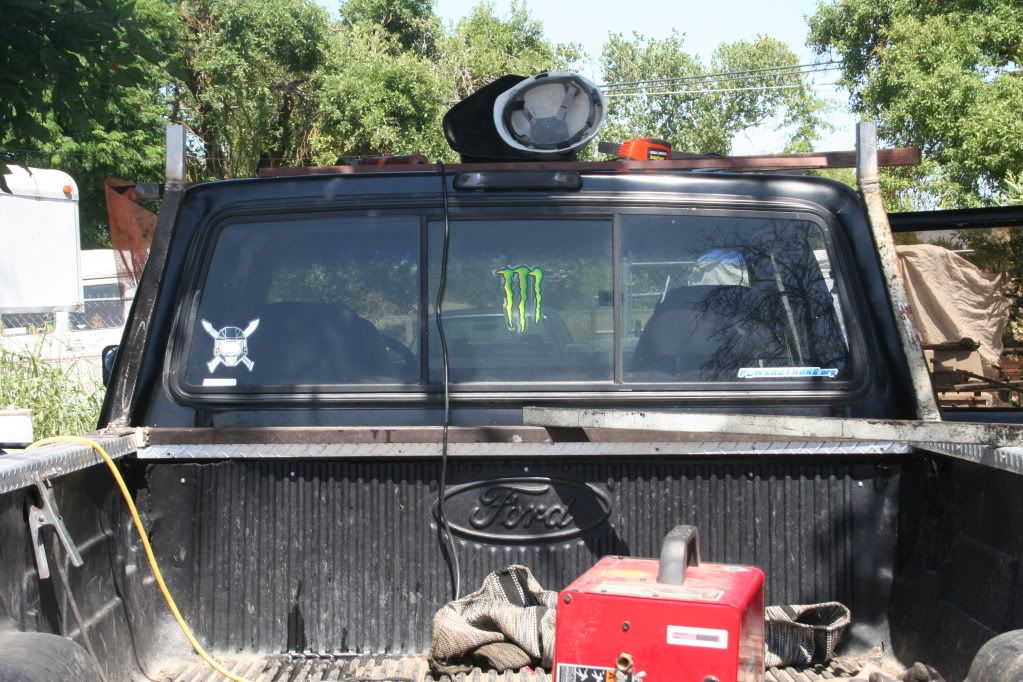

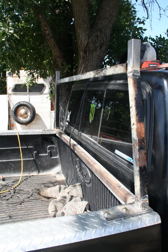

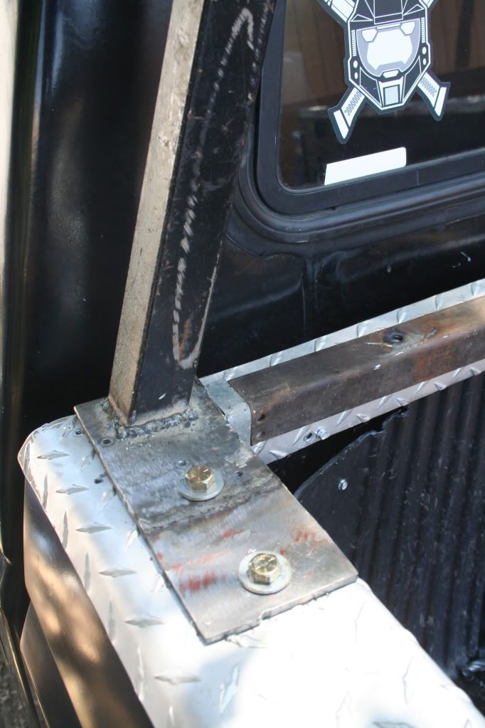

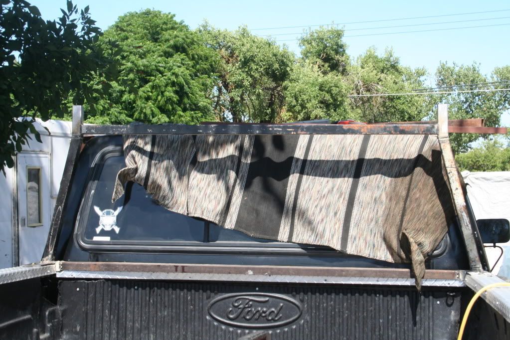

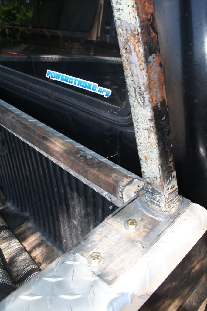

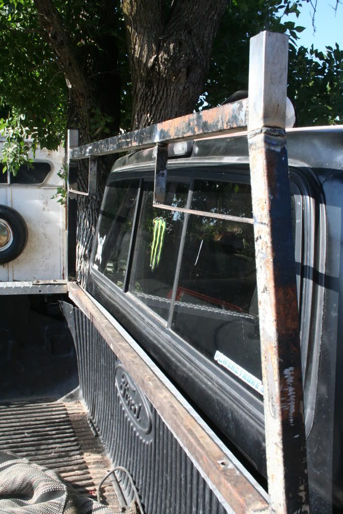

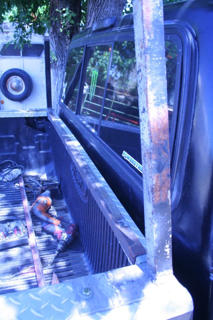

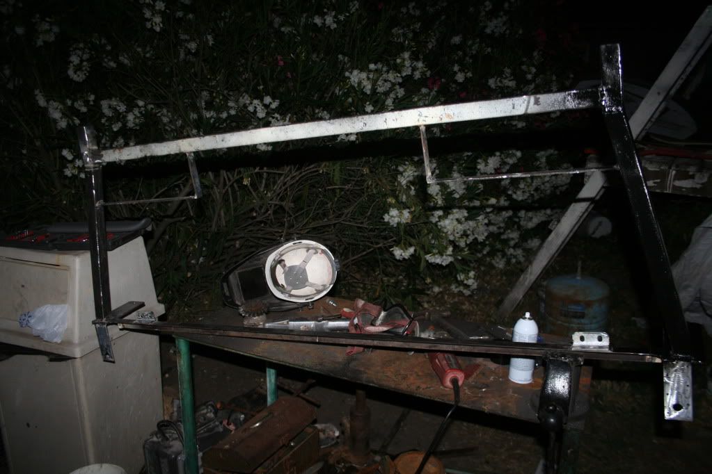

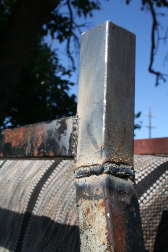

alright here ya go.
5,393 Posts
Discussion Starter · #12 ·
I havent installed my Lights or strobes yet.
5,393 Posts
Discussion Starter · #14 ·
haha, NOpe. Just a open day. Wiring isnt fun.
I have to Mock em up. Drill the hole. Drill thru the Tubing Drill thru my bed, Wrap the wires up COnnect the Strobes in a X pattern. Run it up the truck to the cab. Go thru the floor, then wire to the controller.
not easy/
2,236 Posts
quit complaining... get it done, :hehe: just kidding good job man,
looks incomplete for some reason though probably because im used to seeing them with expanded steal or cross bars, etc.
there is a nice one ive seen though that had spider web design might be something youd look at and add to yours...

Discussion Starter · #16 ·
Yeah i dont wanna do the spyder look. And it is incomplete lol going to raise it when i get my riof rack and throw spotligh on this rack and the front of the roof rack.
I might do a net design on he head rack. Took me long enough to get this one to fit perfect. I wentthru 3 design plans on the pillars. And had to do 3 diff mounting setups till i found the most solid one with a 3 bolt mounting space

2,402 Posts
Don't catch the horse blanket on fire
when your welding. That wouldn't be good.
Doug
5,393 Posts
Discussion Starter · #20 ·
You caught that huh? haha works good acctually. COuldnt find the welding blanket. and this things like 1/2 thick if not more
