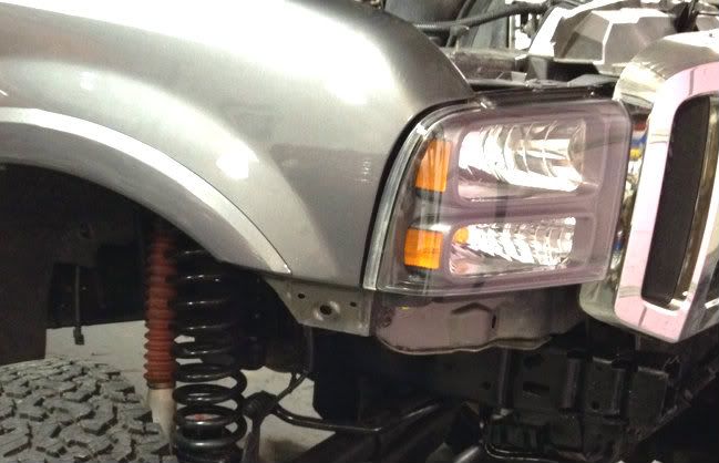

Baked my lights and cracked them open to paint . I used duplicolor spray paint and matched my factory dark shadow gray metallic

put them in the oven for 15 min at 250 and the come apart easily. when your done set them back together reheat them and pop them together. easy

thats pretty sick! any ideas on tinting the headlights? spray can? trying to find the cheap way out for now
I've been a Nazi to people about this lol but have you ever heard of the Harley Headlight mod? you do exactly what he did with the body matching paint, but instead you use black. It gives it a "blacked" out look but yet you still have the brightness of your lights. I think the picture in my sig has my harley mod

iv seen that, seen the pics on this forum but its really not dark enough for me. kinda want them completley blacked out. just because my head light lenzes look like A$$ lol.
