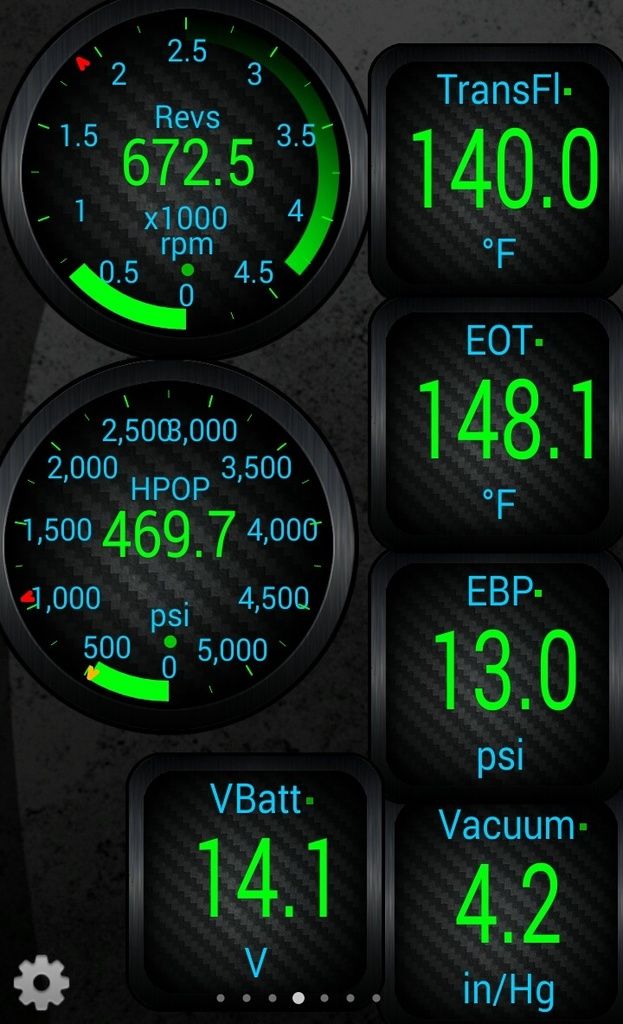

^ Yesterday using that adapter. I think a lot of the reviews saying it doesn't work is that the Torque Pro app needs predefined settings to run on the powerstroke. It doesn't work otherwise. Which is the app problem not the adapter.
Though I see other people saying it wasn't working and I have to wonder if it's the app or just the fact that it is a really cheap adapter and quality control probably isn't the greatest.
SBluke helped me figure out the app. I found that itw as a lot easier to set up once you add the predefined settings for Ford and figure out the gauges while it's running. It will show values while you're picking what gauges while it's running, which helped me to understand more of what I was looking for.
Also, I don't know if it's all of them, but my truck will stall out checking codes if it's running. There is a setting to turn off the automatic checking, otherwise it resets teh ECM every time it checks - which kills the motor instantly.
