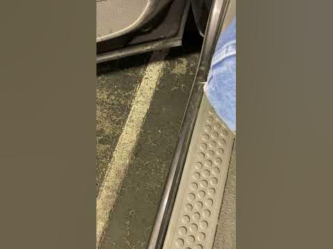

I have made a post about about this before, but never had the video until now. When cold starting regardless if it’s hot or cold outside my 2005 6.0 stumbles when starting as well as takes a little longer to crank. Batteries were just replaced, ficm says 49-48.5. Truck runs great and starts time when warmed up. Bran new oil and low pressure oil pump. If anybody has an idea I would appreciate the help.

I really don't think you have a problem unless cranking is typically longer than in the video. Are you able to pull any trouble codes?
No codes or anything! I have a slightly longer crank time before, but it always changes.. it’s just weird that sometimes it almost struggles and stumbles to start like it did in the video

Why was the LPOP changed?
My buddy was having similar starts to yours...kind of a rolling start instead of firing hard like it should. He had a couple bad injectors that wad making his do that. Maybe get a cold start contribution test done with Ford IDS software would be my suggestion.

that is a normal crank time with the 6.0 starter
