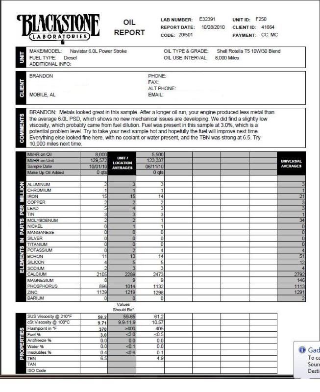

T5 after 8,000 MILES!!!!!!!!!!!!!!!!!!!!!
That's right, I was just advised to go to 10k. I think that is what the amsoil guys are runnin to. Pretty good for oil that is $11.50/gal.

Yes im curious to what the 10w30 was sheared to ?????? if 15w40 get sheared to 10w30

I am not quite sure on where the "sheer" is on my report and I can cut an e-mail to blackstone to help clarify any sheering, but the viscosity reported in the report above reads as follows:
SUS Viscosity @ 210ºF - 61.2. Values should be between 59-65.
So I'm within this range.
cSt viscosity @ 100ºC - 10.57. Values should be between 9.9-11.9.
I'm also within this range.
Viscosity Charts
The above link has the SUS viscosity chart. According to it, at 210ºF, my oil is sheered at exactly the right level of 30wt.
My cSt range is also exactly at a 30wt.
So there you have it. NO sheering whatsoever.
