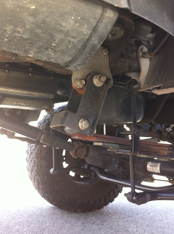

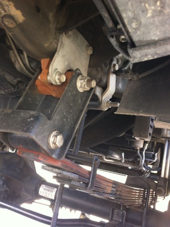

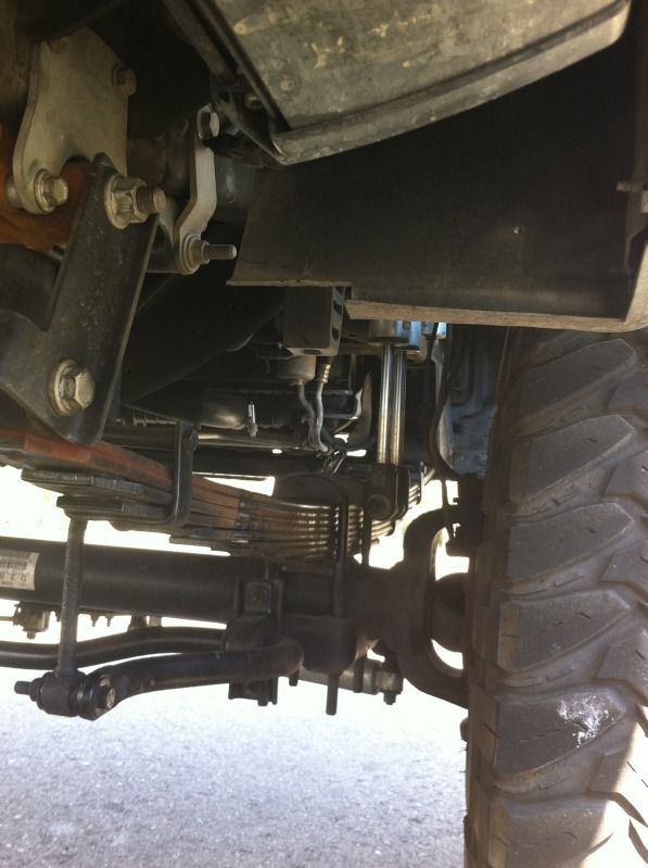

Hello everyone I recently bought my 2004 f250 6.0 PS. As you can see it's already lifted with what I was told is a 10" lift. I included pictures of my lift up front and I was wondering what you guys think would be the best way to bring the front up another 1"/1.5" to level the truck out? I dont like the little rake it has now. I measured the front shackle and it's 5" from bolt hole center to bolt hole center at first I was going to just try a longer shackle but I cant find anyone who just sells a 6.5" shackle. So anyway any info you guys have or site vendors you guys can reccommend to help me level out the truck would be great.

i would be cautious of the mini pak, just due to the fact that they are more designed for stock leafs, you leafs are a multi leaf design and the length of the shortest mini pak leaf may be longer than you shortest leaf.
contact PMF, and look at making a longer front leaf mount, but make sure you steering and track bar can accomodate.

Your options to raise the front are either longer shackles and hangers, or get higher lift springs.
There's a slew of other parts to change out to make it ride well and be safe.

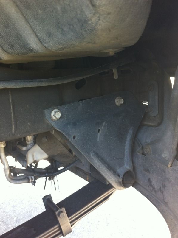

The factory rear shackle mounts to the middle of the frame. With the kit on your truck, they used a drop mount for the shackle and a larger hanger in the front. If you can, measure from the center of the large round hole behind the silver colored drop plate on the hanger to the center of the spring eyelet bolt on the shackle. Then meaure from the bottom of the frame to the center of the front spring eyelet bolt. This will tell me what size shackle and hanger you have on your truck. We make them in many different sizes, so it wont be difficult to get another 1" out of it. If you only added a longer shackle in the rear, it will through your castor off. You need to lift the spring equally.

So I measured out approx 7-7.5" on the front hanger that from the middle of the lower leaf bolt straight up to the frame.
And on the rear from the the original frame hole down to the middle of the lower shackle bolt it was about 8-8.5"
So with that said do you think another shackle and hanger is a option or should I try a bigger leaf pack?

Based off those measurements, you have a 4" shackle and hanger. If you went with our 5", it would give you a 1"-1.5" lift.
Thank you very much sir. And based on my pictures do you think I need the 5" or your 6" shackle/hanger setup to get it level with the rear.

Hard to tell from the pics. Measure from the top of the tire to the fender well front and rear to determine that. Keep in mind that you need the rear to sit AT LEAST 1/2" taller in the rear than the front for the truck to appear level. If it measures out the same height, the body and window lines will actually make the rear look a little lower than the front.
