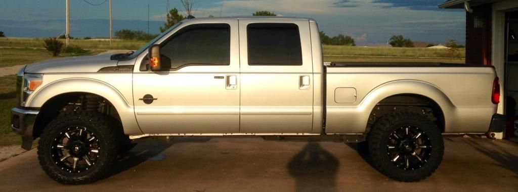

Originally Posted by treffertlawnwrx View Post
Attachment 487522
Leveled on rough country springs with 36s. 325/60/20
Aren't the Rough Country springs only 1.5" higher? I'm not sure that will bring my truck up to level. Do you have anymore pics of it?

Originally Posted by DSL_PWR View Post
I have a Ready Lift SST kit on my F350 with Fox Shocks and I love it.
Sits level, rides great and I have no complaints.

Originally Posted by msmith View Post
Is this the stage 3 tow? We need pics. I'm about to bite the bullet on the stage 3 tow and put 285/75/18 (35-11.22) Nitto Trails on stock wheels.
No. I have the stage 4 sst kit. 69-2531.
Stage 4 - 3.5" Front / 3.0" Rear 2011-2015 Ford Super Duty SST Lift Kit
It does sit level, just took the pic from a lower angle.
Gotcha. Kinda looks like you maintained some rake there. I definitely want to keep some rake is why I was askin'
