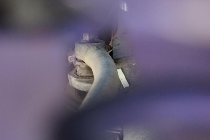

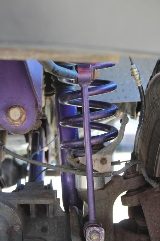

^ Ball joint I was told is probably the culprit(s)
^Looking thru the driver side coil at the curve in the trackbar
^Drop beam with lift kit

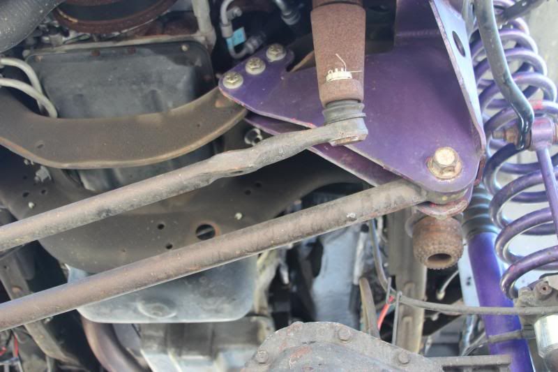

^Factory track bar

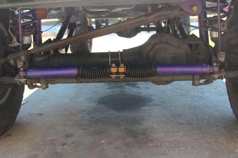

^already has dual stabilizers

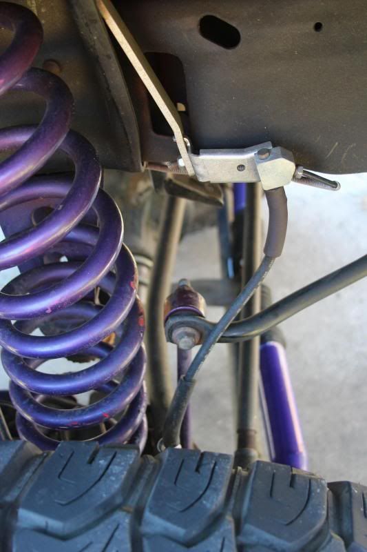

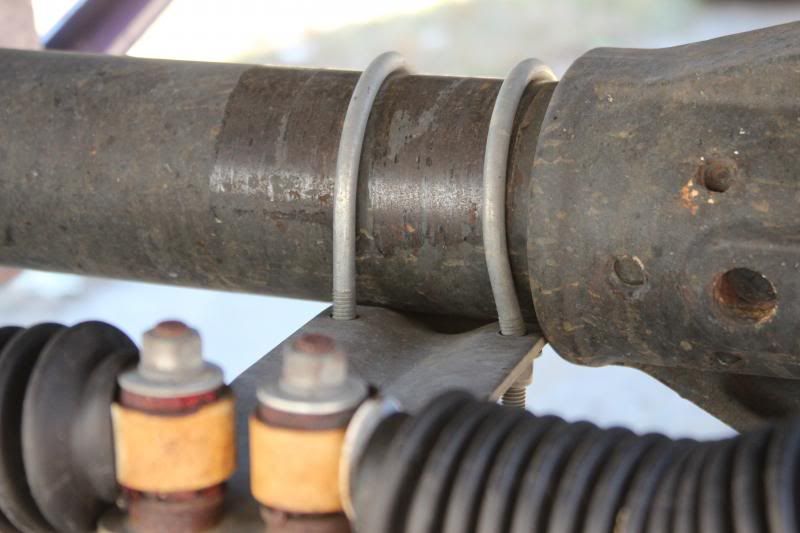

^evidence of movement
^upper 'leveling kit'
^lower spring spacer

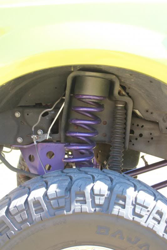

^passenger spring curve

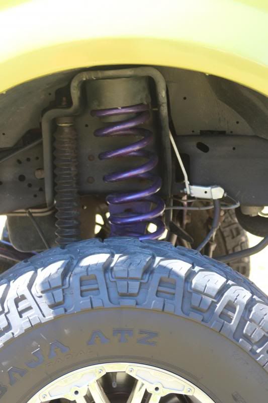

^driver side

OK, now that I have supplied I think ample background information.. This is where the questions come in. I do apologize if it is wordy or pic heavy, but I try to be very thorough on forums when asking for or giving help
So I went yesterday to have an alignment done on the truck as I thought that would fix my problem... well when I got there the guy told me an alignment wasn't going to fix death wobble... that was a little different from what I had been reading online as I saw many members simply had the caster adjusted to account for the new lift/leveling kit changes
For Death Wobble
1. So from what I've gathered, for starters when running a lift of this magnitude the factory track bar should've been replaced long ago to an adjustable one. So I plan to remove the OEM ford one and replace it with an adjustable one. What are some recommendations on which is most feasible for application on my truck? And also, with replacing it, is it true that some will include the balljoint and some won't?
2. The stabilizers seem to have been sliding back and forth, and one of the u-bolts there is bent on the axle. My guess is this is from the violent motion of the tires back and forth during death wobble..? because those scratches weren't there before for a fact before. So I plan to replace the 2 steering stabilizers as and probably that u-bolt
3. If the track-bar doesn't come with one, I suppose i'll head to the stealership to pick up that balljoint that goes on the end. Will the OEM one fit the aftermarket bars? And what is it I hear about people flipping them upside down?
For Spring Curvature
1. How likely is it that perhaps the reason my springs are curved worse is because my shocks are not long enough? The extend from the axle to up above the frame and perhaps by adding the extra 2" that maxxed the shock out not allowing the 2 to separate enough to fit the coil back in comfortably...? If so, would I be able to get by with running a longer shock and a shock extender to allow the spring to sit more comfortably?
2. Whether #1 is true or not.. the shocks will be replaced (front and rear) with reservoir shocks so I'm hoping that will help the ride be a little smoother
3. There's only 1 4x4 shop around, I went there yesterday they said they think I should take the spacer out at the bottom.. I know that isn't the only or definite solution as I know of a few members on here who are running the same.. upper leveling kit and lower spring spacer. Do I need to get a different spring? How do I fix that ridiculous spring curve?
THANKS IN ADVANCE guys, I hope I gave full details. any other info/pics I'll be more than happy to supply as I'm trying to get this all fixed before my new wheels and tires arrive at the end of november

You def need upgraded brackets for you stabilization bar. Mine is like a 6" plate that holds it on. Is there a lot of play in your steering wheel? And at 12", quad stabilizers wouldnt hurt. lol

You have too much caster in the front axle, the axle is leaning forward so far that the spring coils have no choice but to lay forward. You need to draw back on the caster, it will sharpen the driveline angles but at least the coils will straighten up.
I hope those links are adjustable.
Yeah that's what I'm learning. I'm used to bagging trucks so I understand suspension dynamics but with lifted trucks it's almost all opposite of what I'm used to. If you're talkin about my 4 link bars no they're not. . So I believe adding the caster adjusters will make the angle for my front driveshaft too sharp.. I believe I'm just going to remove the spacers reluctantly

My stabilizer setup
That bracket is tigg welded and part of it attaches right to the diff.
One of your U blots is bent as sh*t (most likely from you "death wobble") and the fact that your components cant support your insane lift.
